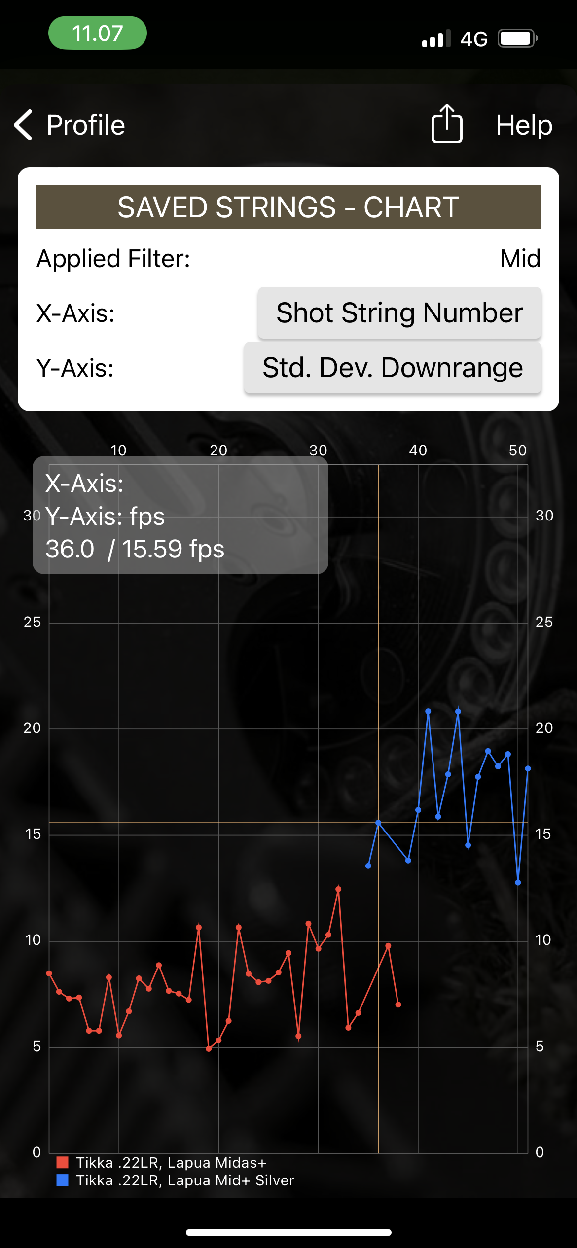

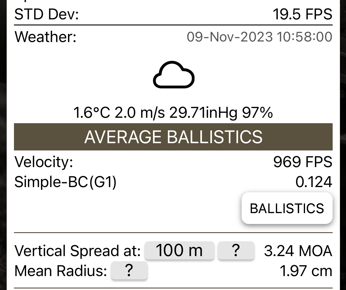

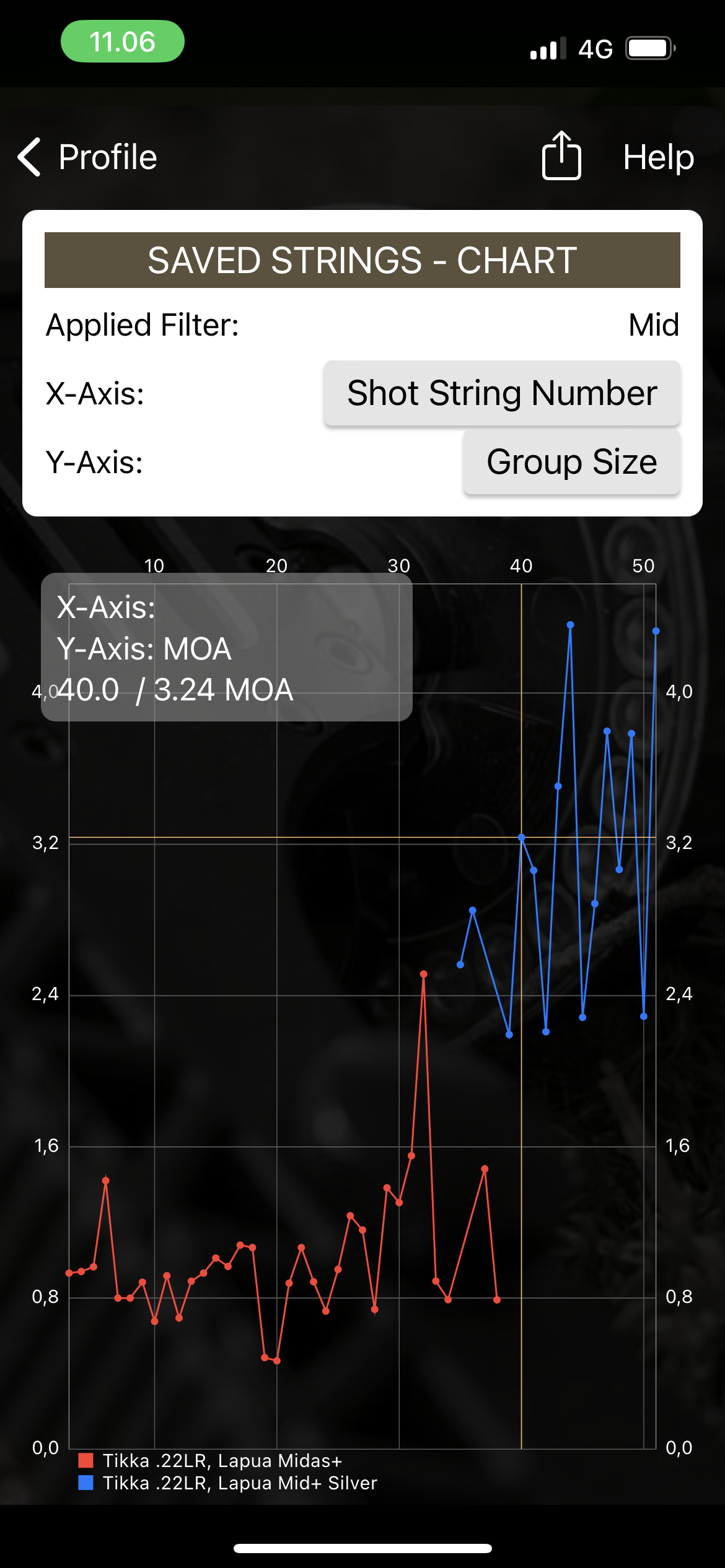

First, I must say I am one of the app developers, so my view might be a bit one-sided. Here's what I do in a shooting session. I'm showing rimfire data because that's what's on my phone. Anroid users do not yet have all the features shown here.
I begin with a shot to see the elevation needed that day for the specific bullet. Bullet types and temperature changes (which are big in winter) can really affect this. For example, in one session, I used two similar bullets (new Lapua Midas+ and old Lapua Midas+).
View attachment 422920 View attachment 422921
(from last row) The new bullet needs 25 clicks for 100 meters (109 yards), but the old one needs 33 clicks.
When I shoot, I look at the standard deviation, vertical spread, and mean radius. My favorite bullet is the new Lapua Midas+. It has a vertical spread of about 1 MOA at 100m.
I had to switch to the old Lapua since the new was out of stock. Turns out, there's a big difference (the old one has a 3MOA vertical spread).
You can see this data on a chart too. I've recorded many shot strings with both bullet types. On the chart, the old bullets are in blue, and the new ones are in red. The Y-axis shows the vertical spread in MOA, and the X-axis lists each shot string's number.
Looking at velocity standard deviation downrange could show similar results if you prefer that method.

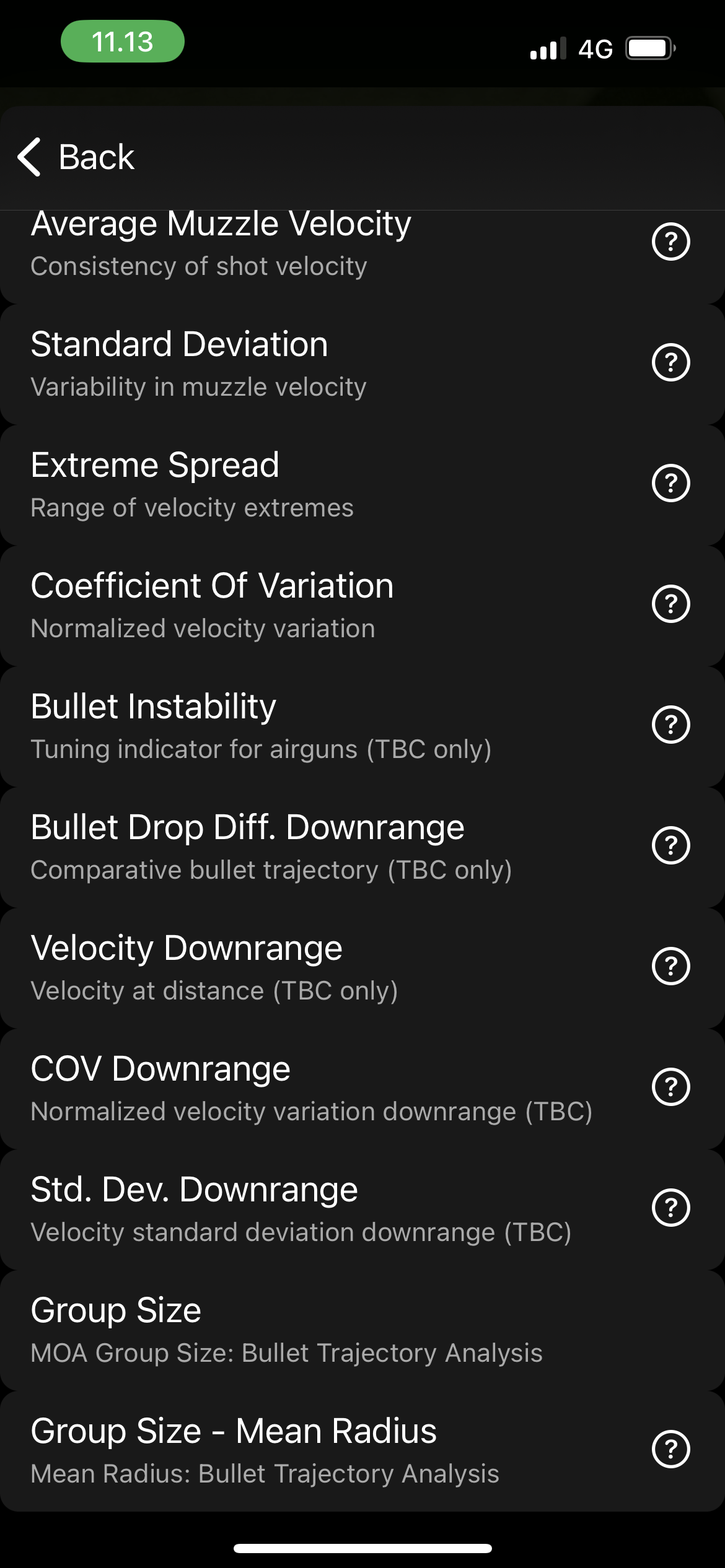

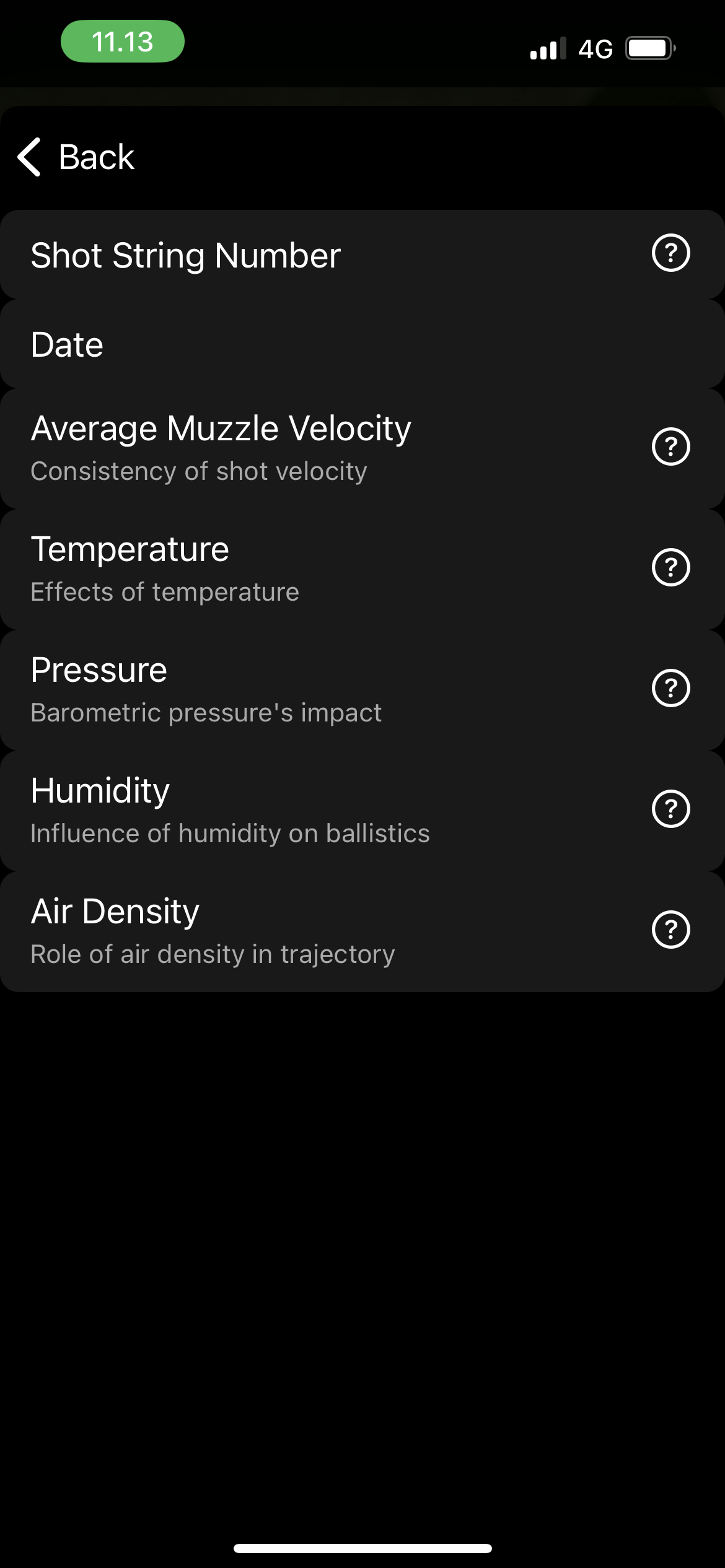

There are many more ways to analyze your shot strings if you want to.
View attachment 422929 View attachment 422930
I hope this helps.
