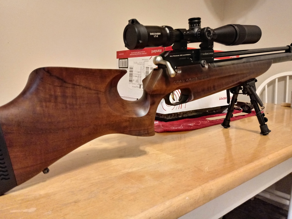

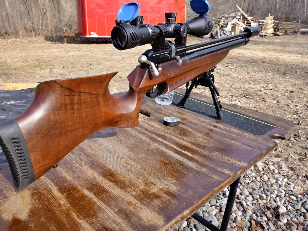

I picked up the Gauntlet at Field Supply for @$200 with free shipping and the Kral from Pyramyd Air for $376.

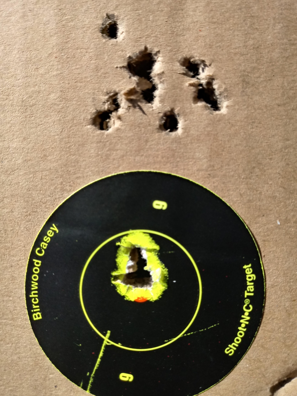

Here's a look at the Kral...
...and a typical 45 yd group
Each group was a full mag (12). The bottom was after I adjusted the velocity from 940-ish (top) to 880 using JSB 18.13's.

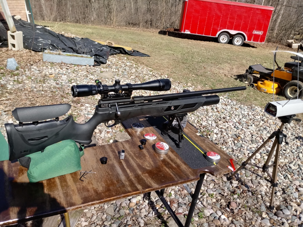

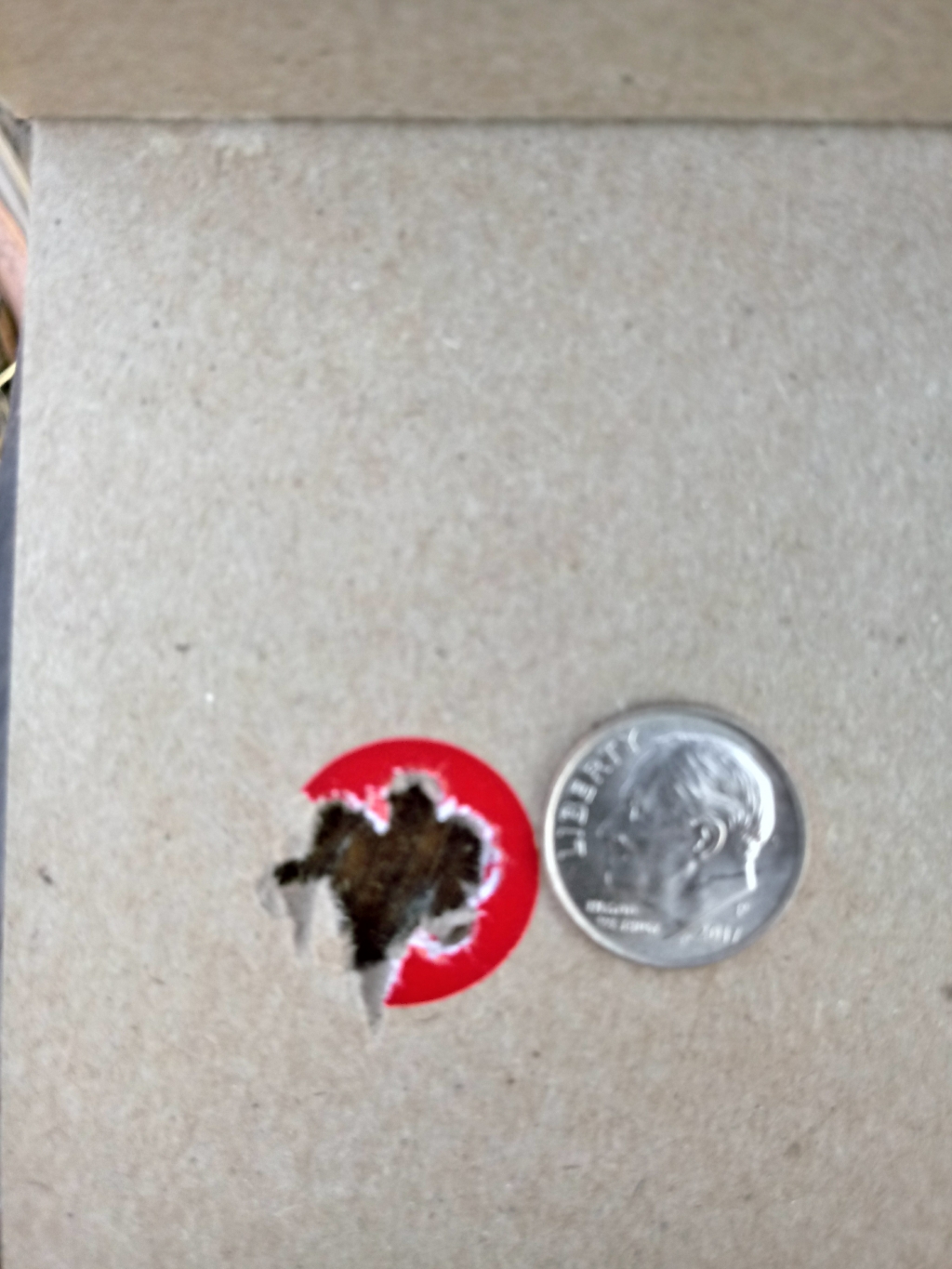

And below is my "Lowly" .177 Gauntlet and a 10 round group at 45 yds using JSB 10.34's...
Moral of the story, Don't be scared of refurbs.You dont necessarily need to spend Well in excess of $1000.00 to get a rifle that will get the job done!
