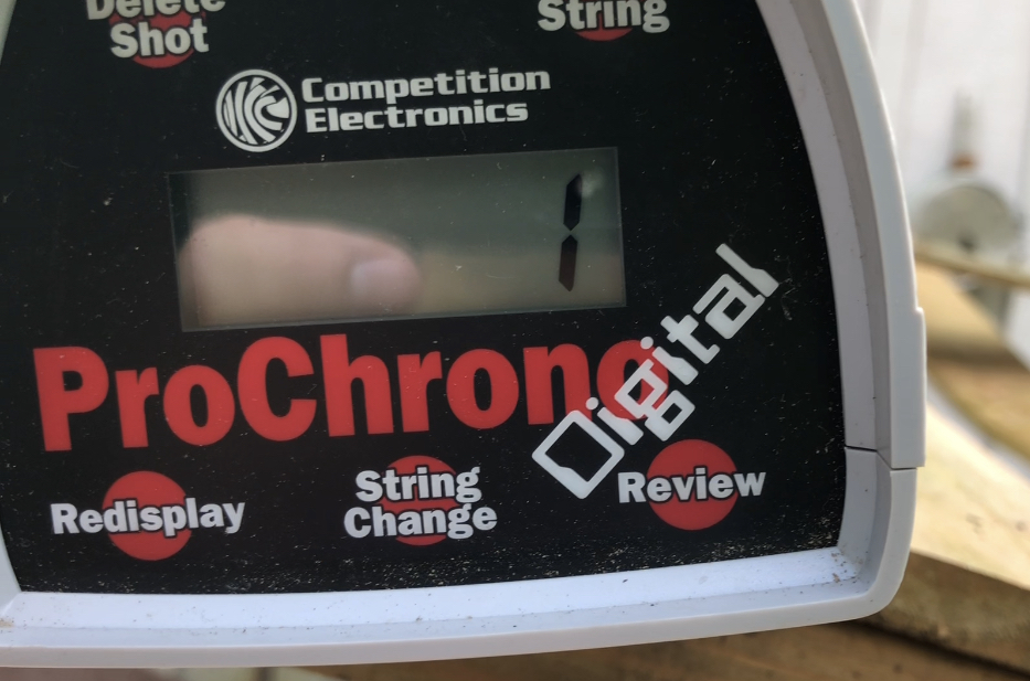

One of my after market added on HUMA regulated 177 Daystate Renegades had a 1fps SD throughout 80 shots and most shots I tested were 30 at zero standard deviation. Had to do it again since I thought the chrony was broken. My other HUMA 177 Renegade averages 1-2 std dev throughout 80 shots. Both shoot great. Both added on aftermarket and weren't originally regulated. Actually didn't need regulators IMHO.
That's amazing SD. So do you give the credit to HUMA? What was the SD before HUMA?
They were SD of 2-3 prior so it did improve on specs over chrony but accuracy seems to be the same tack drivers from before so to me it was a waste of money since my manometers only read regulated pressure now and have to count shots.
