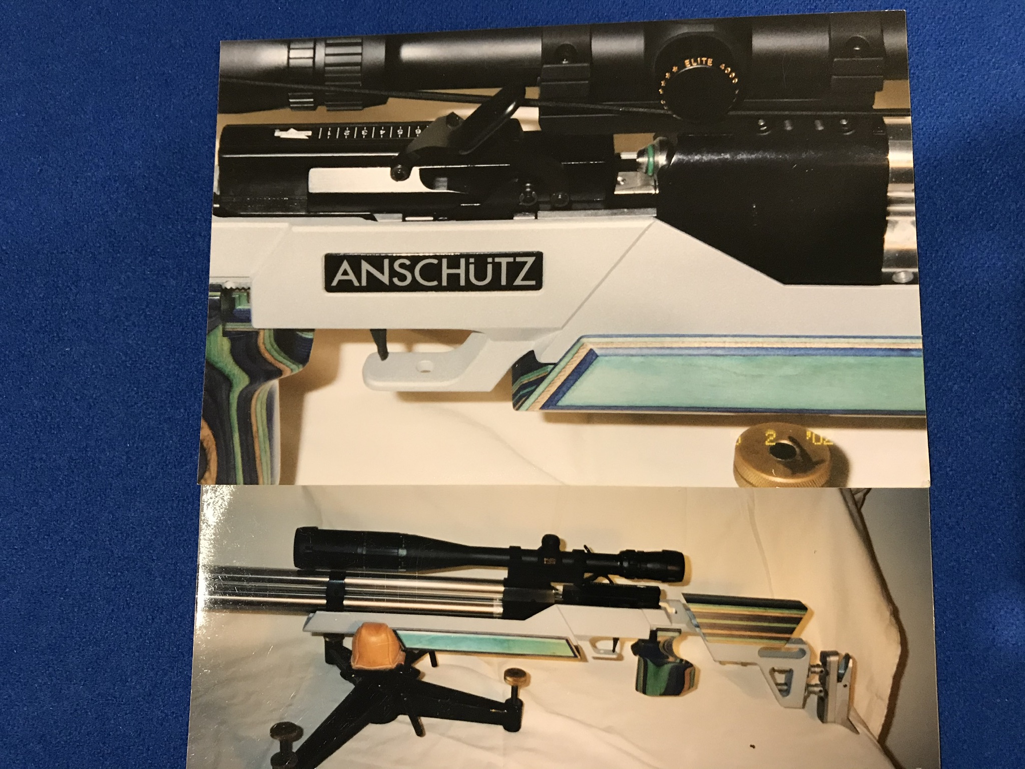

It's a funny thing, I have a expensive Anschutz 22rf which had the trigger set to a crisp 14oz, which I used in our last few XFT matches, and it felt waaay too heavy to me compared to my Thomas. I found in a match setting like this that the Thomas is soooooo much easier to shoot well!!! I spent an hour earlier this week getting the trigger set to 6oz in the Anschutz which is as low as it will go and still be safe = now much much better!

Some guns I've shot had super light two stage triggers but unpredictable and also unappreciated! I don't like these kinds, put in the situation and given the choice I'd rather have a medium weight trigger with a distinct wall and a crisp break rather than the former. Like my Anschutz 22rf if used for NRL22, to me 6oz is too light, where it was set before is about right for NRL. I also have it set to single stage.
