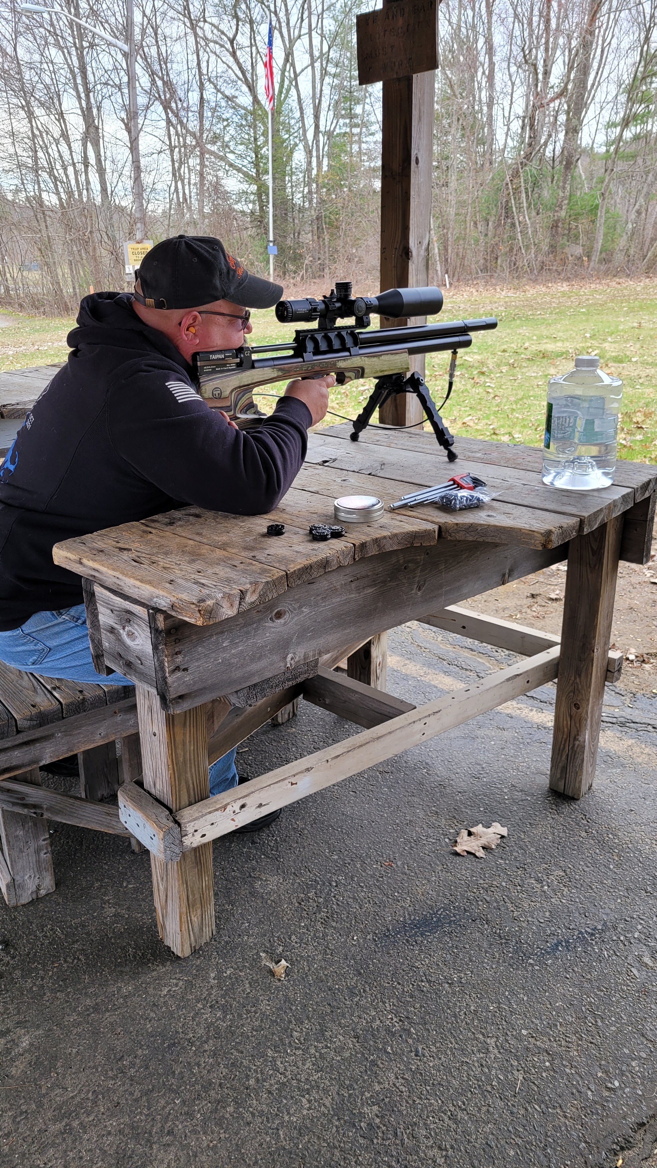

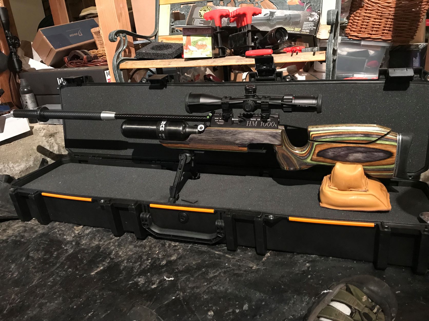

I went to the range today and shot my RAW HM1000xLRT @ 100 yards, beautiful day, very light wind.
My 23 grain Zan slugs (.217) out performed my JSB 18.1g pellets. 3 of 5 Zan (5 shot) groups were under 1 MOA; none of the JSB's were.
The Zan slugs out performed my lighter NSA's at 50 yards, so I tried them at 100. The NSA slugs were so bad at 50 yards relative to pellets, I stopped shooting them.
Who knows, but the pellets seemed to be affected by the wind ... a little more. This is the first evidence I have of slugs outperforming. I will do more testing tomorrow - the Zan .218 slugs didn't shoot as well as the .217's at 50 yards, so I haven't tried them at 100.
