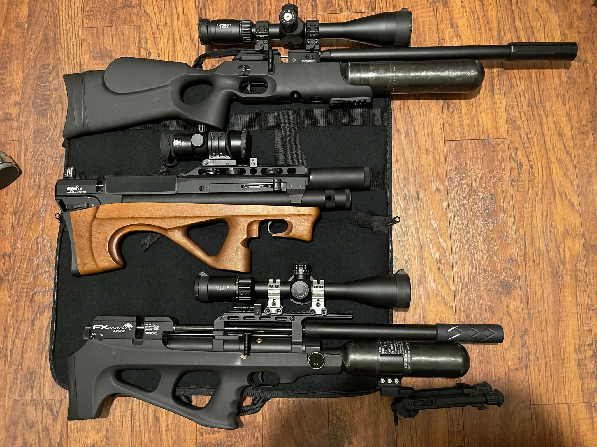

Edgun Lelya 2.0. It's 23.5 inches with a built in moderator. In the picture you can see the size difference between my Lelya compared to my Wildcat III BT compact and Crown MKII with 380mm barrel.
My Lelya is .177 but I had it shooting JSB Beast at 900 tt/sec for 29 fpe. It was shooting less than a nickel groups at 45 yards at that power level. I now have it tuned to 20 ft/lbs shooting under a dime at 40 yards using either JSB Monster or JSB Beast.
It also shoots 1/4 inch groups with the following ammo but I've only tested these at 30 yards.
Crosman Piranha, Crosman HP, Crosman Premiere Domed, H&N Hunter, H&N Baracuda Match, Polymag short, JSB Knockout 13.43gr.
JSB Hades don't shoot as well as the others about 3/8 at 30 yards but that is good enough to knock down an Iguana at 30-35 yards.

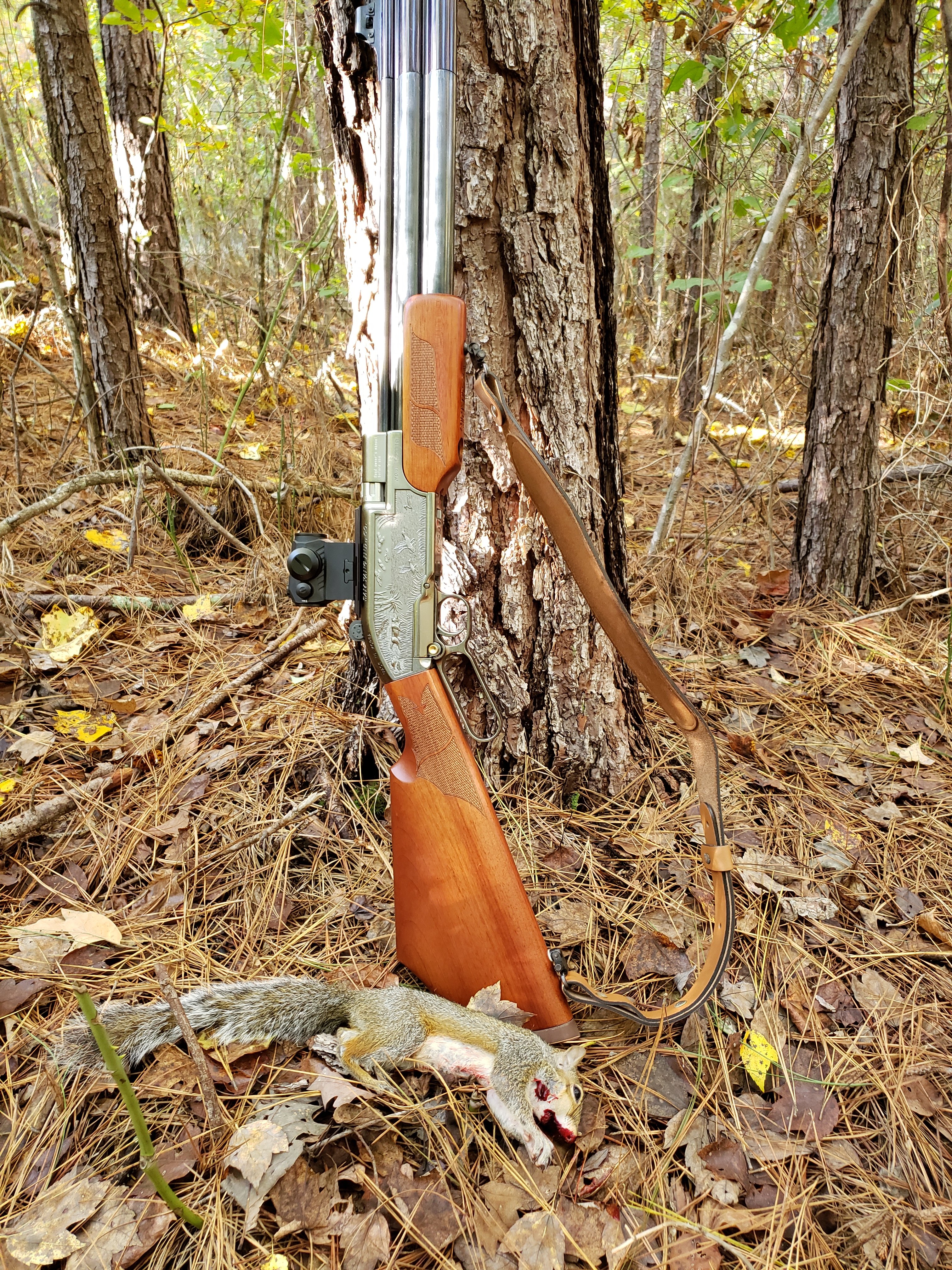

Traditional hunting style rifle under 36" ain't gonna happen. My Revere, without moderator is about 37". You need to decide where you can compromise. I don't see why 36" should be that important, but that's your call. My recommendations would be the Revere, Royale 400, or HW100 carbine. If 36" is a hard requirement, look at the bullpups.
