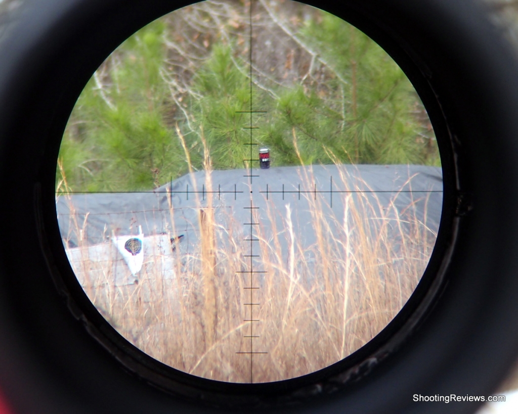

So I have two with this reticle
And the one on the Boss has this reticle

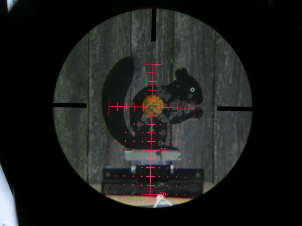

I've looked through Paul Crays new Delta 5-50. It has a VERY thin crosshair, that for me, is rather difficult to pick up unless the illumination is on. I have the 2 Sightrons and the Khales, and I can safely say that the MRAD does have a slight temperature shift, while the Mil dot version has none that I can detect. The Khales has no temperature shift, and that's the main reason why I went with it over a Schmidt and Bender, because they do have a noticeable temperature shift, and their price is similar, I went with the Kahles. The reticle on the Kahles is a cross between the thinner Delta, and the Sightron. It's not a busy reticle, but the calibrations are useful to the Field Target shooter. Here's a picture of the reticle with illumination on, the reticle is black otherwise.

Tom - I like that Kahles reticle! I’ve never seen that one.
