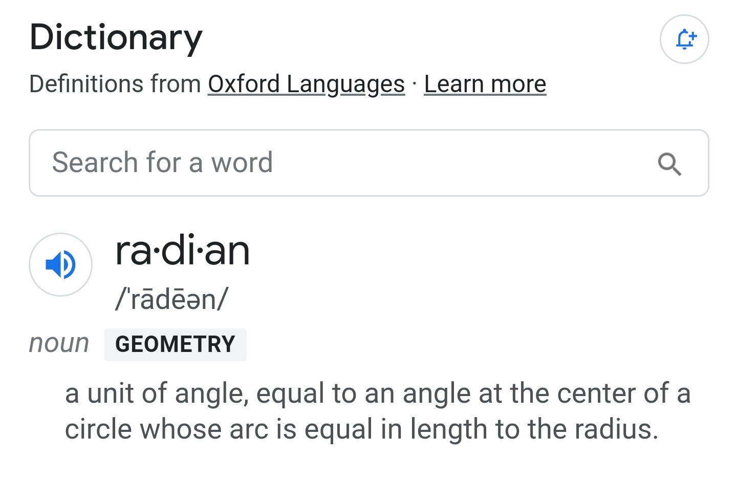

None of you had typed anything correct about Radians. Radians is arc length.
Which is a unit of angle.
Source: Oxford
Please do tell, how that angle is then. Describe that angle at 100 yards and 1000 yards
Arc length is a result of a radian at any given range. You have the two confused. The arc length is equal to the radius which would be your range. Heres a picture:
A radian is a rather large angle (57.296°) hence the reason we measure in milliradians (0.057296°)
