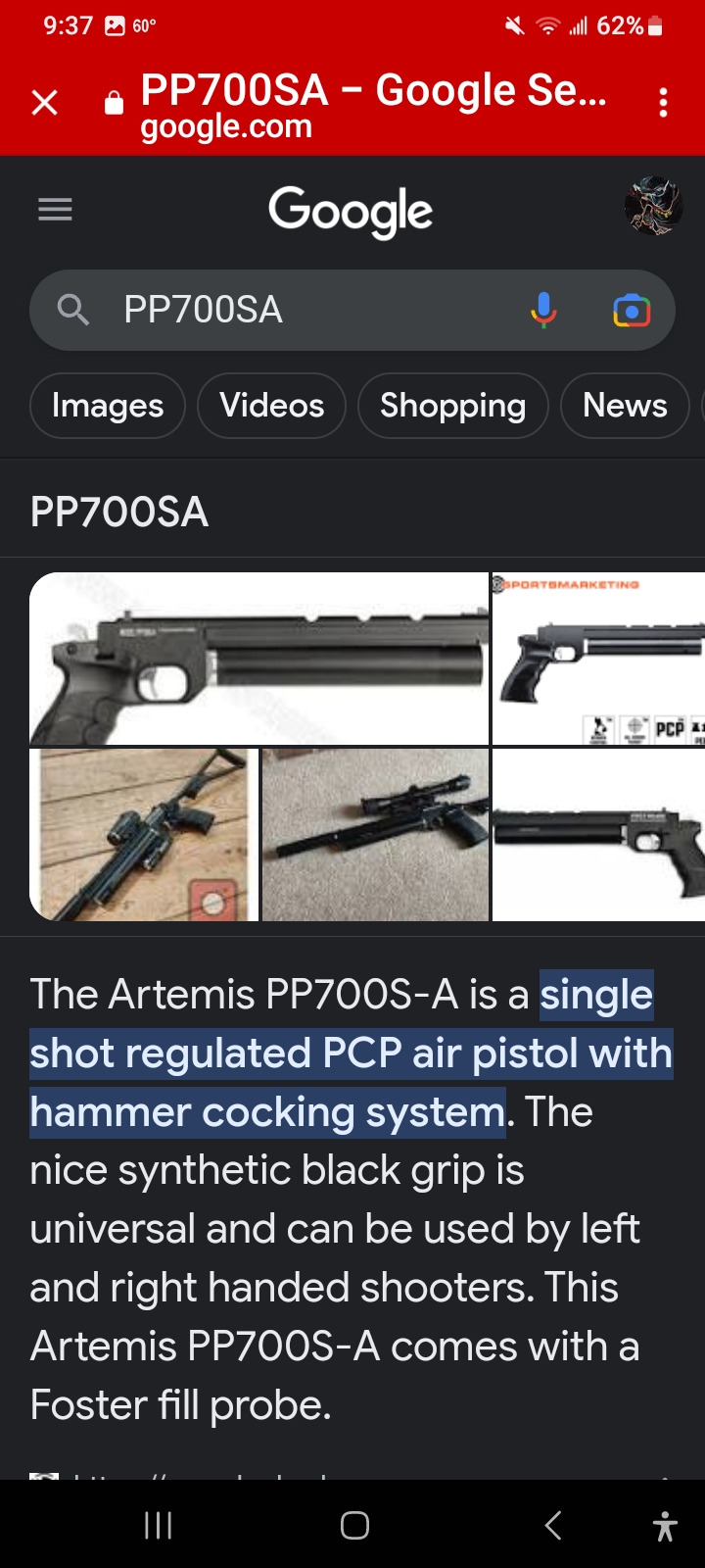

What's the PP700SA? Never heard of it. Pls post a pic?

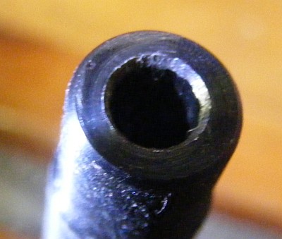

Of all the budget brands I've dealt with, Snowpeak's barrel workmanship is the worst I've encountered. Crowns that look like they were done with a dull drill bit running backwards. One of mine as delivered:
On long barrels they like to shove a dirty piloted crowning bit down into the muzzle and mangle the rifling. Ran into it twice on guns purchased years apart.
Neither of my short-barreled guns had the rifling damage (one of them a PP700S-A) so a crown job took care of that end of the barrel.
It's great you can clean up yours because they usually improve substantially with a little effort.
