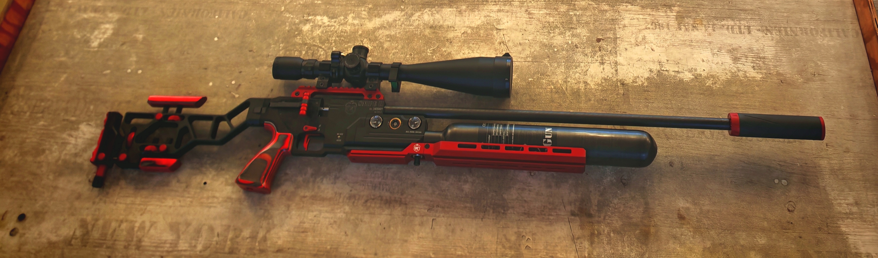

The Kalibrgun Snipe air rifle, specifically the .22 caliber version with a 700mm (27.5 inches) barrel, was put through a rigorous test of 12,000 shots. This review encapsulates the performance, handling, and versatility of this rifle based on extensive usage.

I recently had the opportunity to test the Kalibrgun Snipe II with the 700mm barrel in .22 caliber. Having tried the first version as well, I can confidently say that the biathlon-style side lever is a significant improvement over the bolt-action mechanism on version 1.
The side lever (or biathlon lever) is much smoother and easier to use, making the overall shooting experience more enjoyable and efficient. It's a noticeable upgrade that enhances the rifle's performance.
One of the major issues with the first version was the occasional ejection of the O-ring from the barrel if the bolt wasn't fully pushed into the forward position. This problem has been completely resolved with the new side lever mechanism, as it ensures the bolt clicks securely into place every time.
After several thousand shots, I haven't experienced a single malfunction or dissatisfaction with the Snipe II. Overall, I can highly recommend the Kalibrgun Snipe II. It’s a fantastic air rifle with great accuracy and reliability. If you're in the market for a high-quality PCP air rifle, this one is definitely worth considering.
