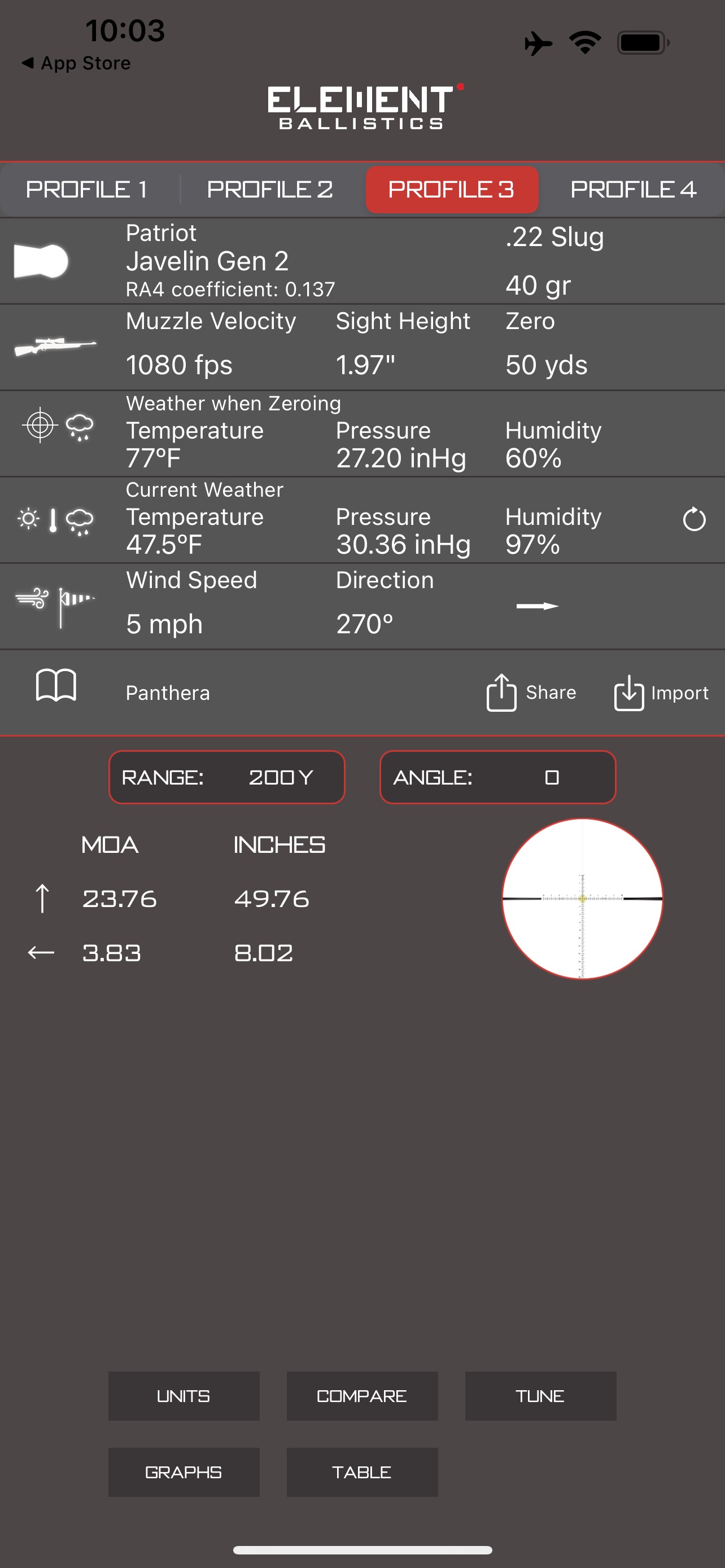

While I’m not a ballistic expert, but I know someone that is. So I reached out to Matt Dubber to see if he could elaborate on our discussion. Here’s what he had to say:
“Yes it is true that there are benefits to shooting slower. I spoke about this a bit towards the end of last year’s RMAC PRS video I made. Check the screenshots, the ONLY difference between these two is the velocity, one is 980 and the other is 1080. But check the wind drift, the slower one has less drift. This is because drag increases the closer you go to the speed of sound. You won’t see this as a lower BC because the BC factors in the drag curve of whatever function you are using (G1, RA4, etc) but if you look at the actual drag functions on a graph you will see the spike in drag. That’s why I will always choose a heavier slug at slower speed than a light slug at higher speed.”
“Check how the drag increases drastically right around the 1000fps mark on all the different drag functions. They are all slightly different which is why you should try choose the function which is closest to your actual bullet shape (i.e. you might get more accurate wind drift results if you use a RA4 drag function instead of G1 when using a single BC)”.

Thanks Michael and Matt. His example is negligible, but still illustrates the point. My question to Matt would be then if the drift is less at lower speeds say 900 to 950 fps, why does he shoot at 980 or higher?
The 40 grain Javelins with 0.137 BC are very good for conventional slugs. But not even close to the 0.21 BC we’re seeing from the Altaros ATP Smooth .25 cal 49.5 grain boat tail or .22 Altaros King 40 grain slugs. His drift is 3.77 MOA, and under the same conditions mine is 2.6 MOA. That’s a difference of about 2.5 inches at the 200 yard example he uses.
One thing that interested me playing with Strelok is the difference in drift for 90 and 270 degree wind direction at longer distances. Using Matt’s 200 yards and 5 mph full value wind, the difference is almost 50% greater drift with 270 degree than with 90 degree wind for a right hand twist barrel. The difference is much more than negligible. Spin drift becomes a significant factor in winds at distance.

While in this case, Matt Dubber is correct in that it is due to the drag coefficient increase as the speed approaches Mach 1, I am afraid he is not really an expert in external ballistics. Unfortunately his external ballistic videos contain literally dozens of mistakes, some of them very basic which anyone working in aeroballistics would see immediately. It is a pity that he has not seemed to be interested in correcting the worst mistakes, mainly in the video on pellet stability. This thread contains the real explanation for aerodynamic stability of pellets. https://www.airgunnation.com/threads/aerodynamic-stability-of-pellets.1276895/
