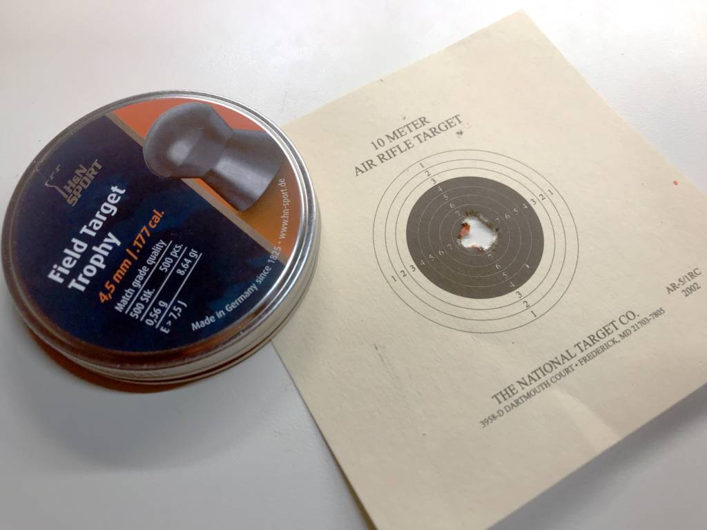

Although .177, these seemed to work best for me.
(bench-rest @25Y)
Those were good enough for what I do. I didn't try many others for better groups before trading the R9 for something I enjoy.

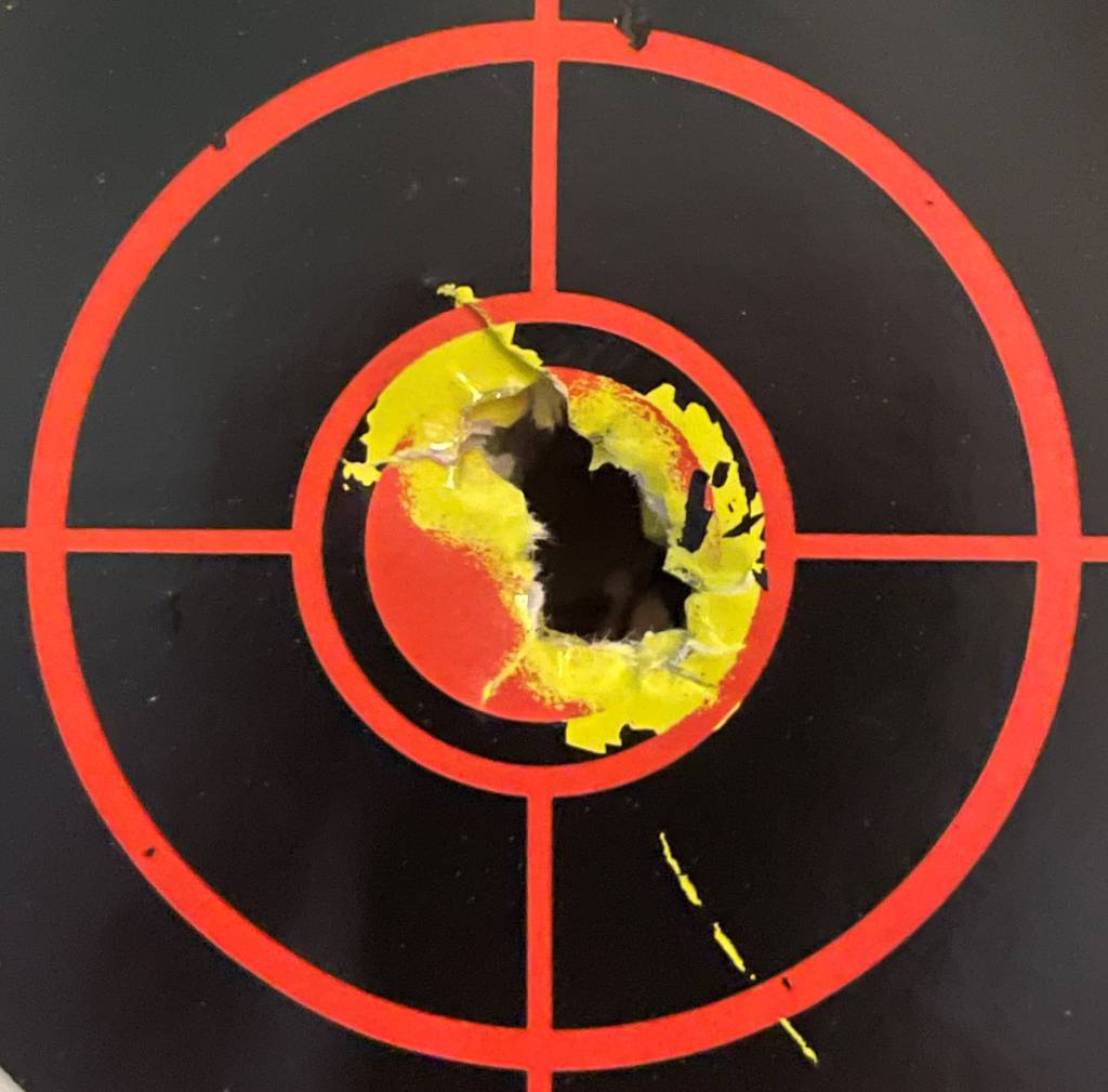

UPDATE: 2/18/2022 So I got another .22 barrel, the pellet test were the same as above, snugged, loose then tight. BUT!!!!! it's shoot nickle size grouping at 25y within the fist 20 pellets through the barrel using Crossman HP.
