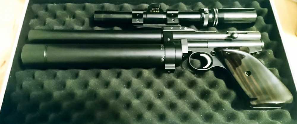

For a target pistol of factory length, this would be a must for me. No other barrel band is anywhere near as good.
https://maverickcustomairguns.com/product/1377-1322-moderator-adapter/
There are un-threaded versions that are cheaper. I have the pass thru with no sight post.
Pair that with a Williams rear sight, gmac steel breech, LW barrel, and p-rod trigger group... It'd be hard to do any better.
I have ebony grips from alliance on one of my 1322s, and they really do add a large amount of stability (in heft, and grip) to the pistol.
Reactions: Grunt1776
Pretty expensive tho. 88 bucks for a barrel band is pretty rough.
Indeed. But the fit is spot on, includes a mod adapter. And there is a set screw in the under-side. Plus a very nice pump arm cross-pin.
I used to use another secondary barrel band because gmac, backpacker, and factory bands were all inadequate. This one isn't.

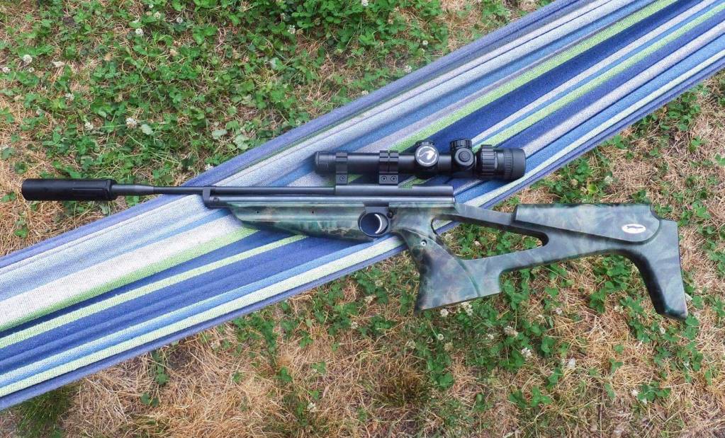

I bought one along with my first break barrel 12/2021. I bought the 1377 bc as a kid I always wanted a 1377.
In under 60 days I've upgraded to the steel breech, had to add a dovetail to picatinny mount, and shoulder stock.
I still need to replace the crappy pivot pin, upgrade to metal band, and I'd like to add that spacer piece between the piston and barrel.
I haven't even touched the internal parts yet...
