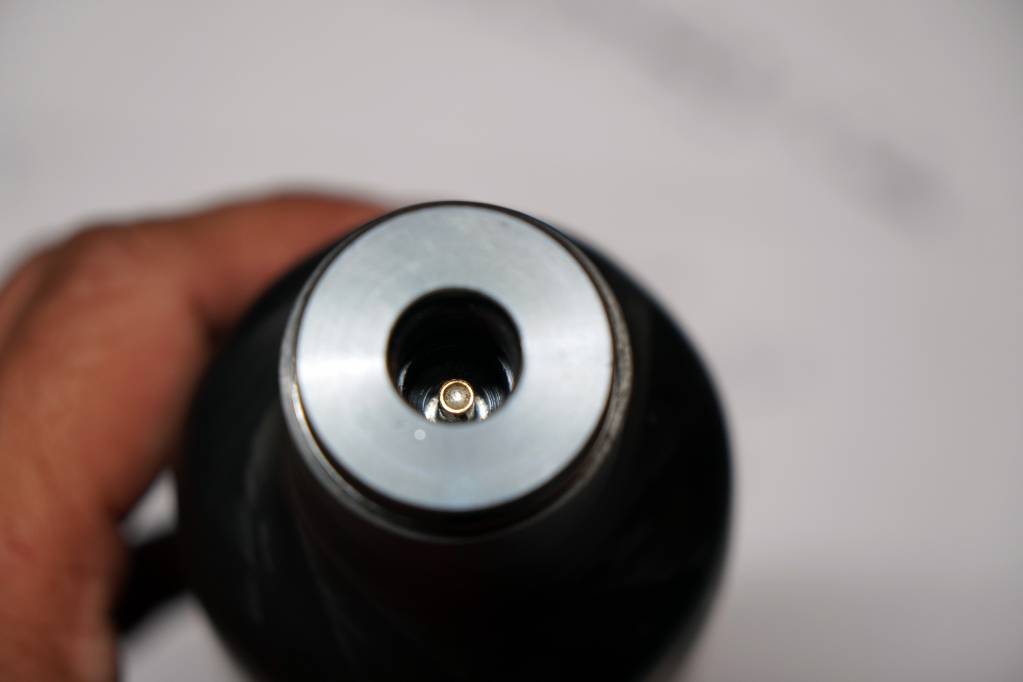

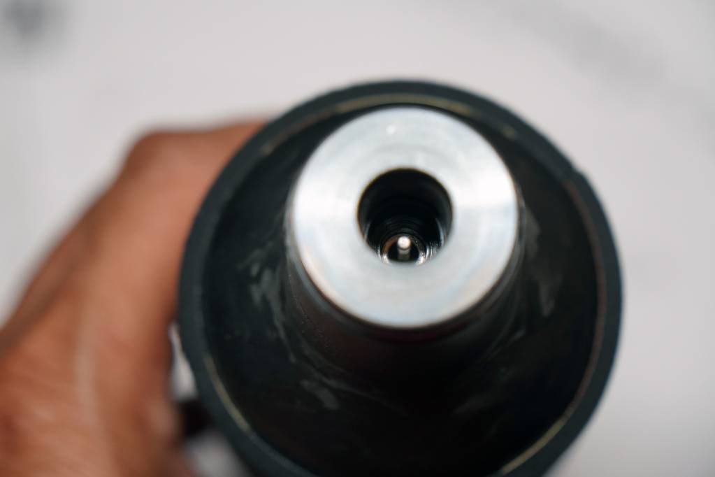

That brass bushing should be able to pull off the bottle's valve pin:
Source (page 25): https://fxairguns.com/wp-content/uploads/2021/04/Manual-Impact-M3.pdf
That almost seems too easy...too good to be true ;) but hopefully I can (easily) retrofit my 580cc bottles for use with the M3! Thx!

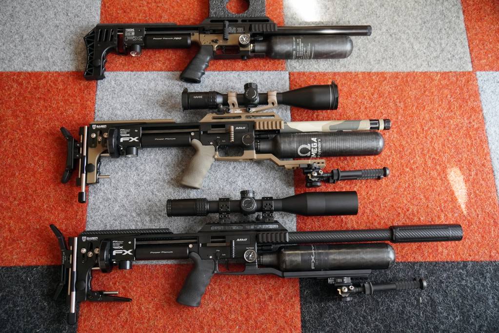

It's been nearly two weeks since I took delivery of the M3 but it's been so busy at work that I haven't been able to put a scope on it and fire some rounds through it until today. This M3 is intended to replace the all black MkII shown in photos from the original post in this thread. That all black MkII is my 0.22 slug setup and it has the reg set at 125bar, power wheel on MAX and shoots the NSA 24.8 218 slugs through the slug liner at 880-890fps with incredible accuracy and consistency. This 0.22 MkII is one of the best shooting rifles I've ever owned and I really have zero business replacing it but . . . stupid is as stupid does. So here's what I learned about the M3 in getting it set up to replicate the 0.22 MkII:
  • REGULATOR SETTINGS & ADJUSTMENTS: My M3 shipped with only 100bar in the tank so the 1st regulator also only showed 100bar on the gauge and the 2nd regular was set at 75bar (which is the factory default for a 0.22 per the owner's manual).
    • I loaded up some of the NSA 24.8g 218 slugs just to see what they would shoot at and found that they were only doing 510fps!
    • I figured I'd have to up the 1st reg to something like 150bar so I could set the 2nd reg at 110-120bar to shoot the NSA's at 880-890fps but the manual said to not adjust the 1st reg unless you really had to so I was a bit perplexed as to why it was set so low at the factory (thus, I thought, limiting how much I could increase the 2nd reg to since you can have the 2nd reg be higher than the 1st)!
    • Luckily, as soon as I went to fill the tank up to 250bar, the 1st reg gauge climbed to 150bar . . . which is actually where it's set at - so now I could easily up my 2nd reg without having to mess with the 1st reg.
    • It was very fast and easy to get the 2nd reg upto about 115bar, which then sent the NSA's out at about 890fps but the factory Superior liner didn't group nearly as well as the slug liner . . . so I went to swap out the Superior liner in favor of the slug liner and that's when I remembered that these new barrels come with two different transfer ports (1 for pellets and 1 for slugs).
  • BARREL SYSTEM:
    • FX wasn't kidding when they said the tolerances for the barrels are much tighter on the M3! It took several attempts and a lot of effort just to slide the barrel out. The tighter fit does give you more confidence that the barrel is less likely to move around and change the POI.
    • The barrel/transfer port was set up to shoot pellets from the factory so I turned it 180* to use the larger dual slug transfer port. Just switching over to the slug transfer port bumped to the fps to about 900-910fps (or a gain of about 20-25fps over the smaller pellet transfer port)
      • This allowed me to back the 2nd reg down to 110bar to get the 890fps I wanted.
    • Once the Superior liner was swapped out for the slug liner, I got the same ragged one hole groups at 40yd that I was expecting and I was able to confirm that this M3 can shoot just as well as its predecessor!
  • OTHER NOTES/OBSERVATIONS:
    • The FPS spread was a little sporadic over the first few magazines - jumping back and forth about 20fps at times. This seemed to get better the more I shot so it looks like the regs just need to settle in and hopefully become much more consistent.
    • The fit of the magazine on the M3 is much, much better than the MkII. It fits nice and snug with little to no wiggle room.
    • The factory trigger setting is heavier/stiffer than my MkII so I'll need to learn to adjust that next.
    • The larger cocking knob along with the short throw lever both help to make the M3 easier to cock compared to the MkII.
    • The reversed safety is much more intuitive since I always thought the safety on the MkII was backwards.
    • The Quick Tune System is definitely way easier to use than the tiny allen wrench adjustments needed on the MkII.
    • The larger Power Plenum 720 takes noticeably longer to refill/recover compared to the MkII PP.
In summary, here are the MkII vs M3 settings needed to shoot the NSA 24.8g 218 slugs at 880-890fps:
-MkII: Reg @ 125bar, valve adjuster @ just over 3 lines, power wheel @ MAX
-M3: 1st reg @ 150bar, 2nd reg @ 105bar, valve adjust @ 3.5 lines, power wheel @ 8, Quick Tune System @ 3.5
So basically the larger Power Plenum 720 on the M3 allows me to set the M3 regulator about 15bar lower than the MkII to achieve the same fps!

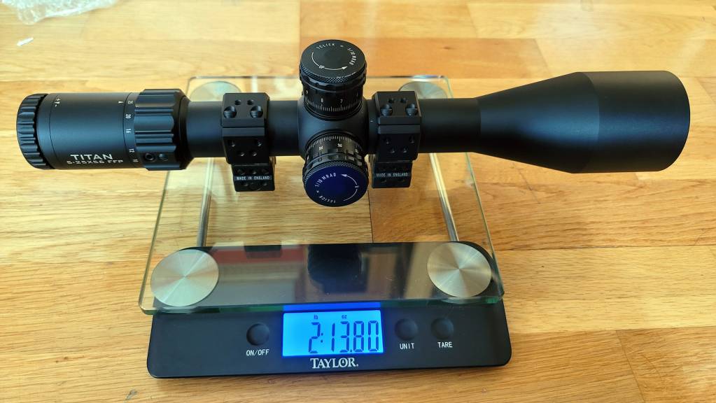

I would return the titan, it's simply too heavy!!! But if don't mind the weight and want better glass it's hard to beat this little made in japan sleeper. It's the same scope as Crimson Trace series 5 but with cleaner reticle, best value at $1000 dollar range. Everything else under 1200 dollars are all made in china now. Or you can still get the crimson trace series 5 for 700 dollars from midway. The element do have better feeling turrets but it's just feel, both the brownell and CT turrets track accurately.

Yes, the Titan is a nice scope but it is ridiculously heavy. I'm trying to find a Nexus to compare it to as the Nexus should be noticeably lighter. Just picked up a NightForce 4-32 for 3x the cost of the Titan but can't tell any noticeable difference in brightness or clarity.
The titan is pretty darn good optically but does fade a little at pass 20x, however most people don't use max zoom much so not a huge deal. Also when it comes to optical quality at that price range it's hard to tell the different by just looking at them casually. The price increase to 2k scopes and then 3-4k scope isn't huge unless you look through them side by side at the same object at distance. Then the higher end priced scope would shine, you will see very small details and colors the lower end scope simply won't pick up. For airgun most of it is kind of a waste because we aren't looking at much more than 100 yards and the higher end scope really starts to shine pass 500 yards. One of the biggest differencebetween 2000 dollars and up scopes compared to the chinese 1200 dollar scopes is the agility to clearly see the bullet trace which airguns won't have most of the time with even slugs. Also at under 100 yards the depth of field isn't wide enough to see that well anyways. Sounds like you got the new NX8 4-32, it should blow the Titan out of the water once you look at targets at 100+ yards, you should see ants crawling on it!
