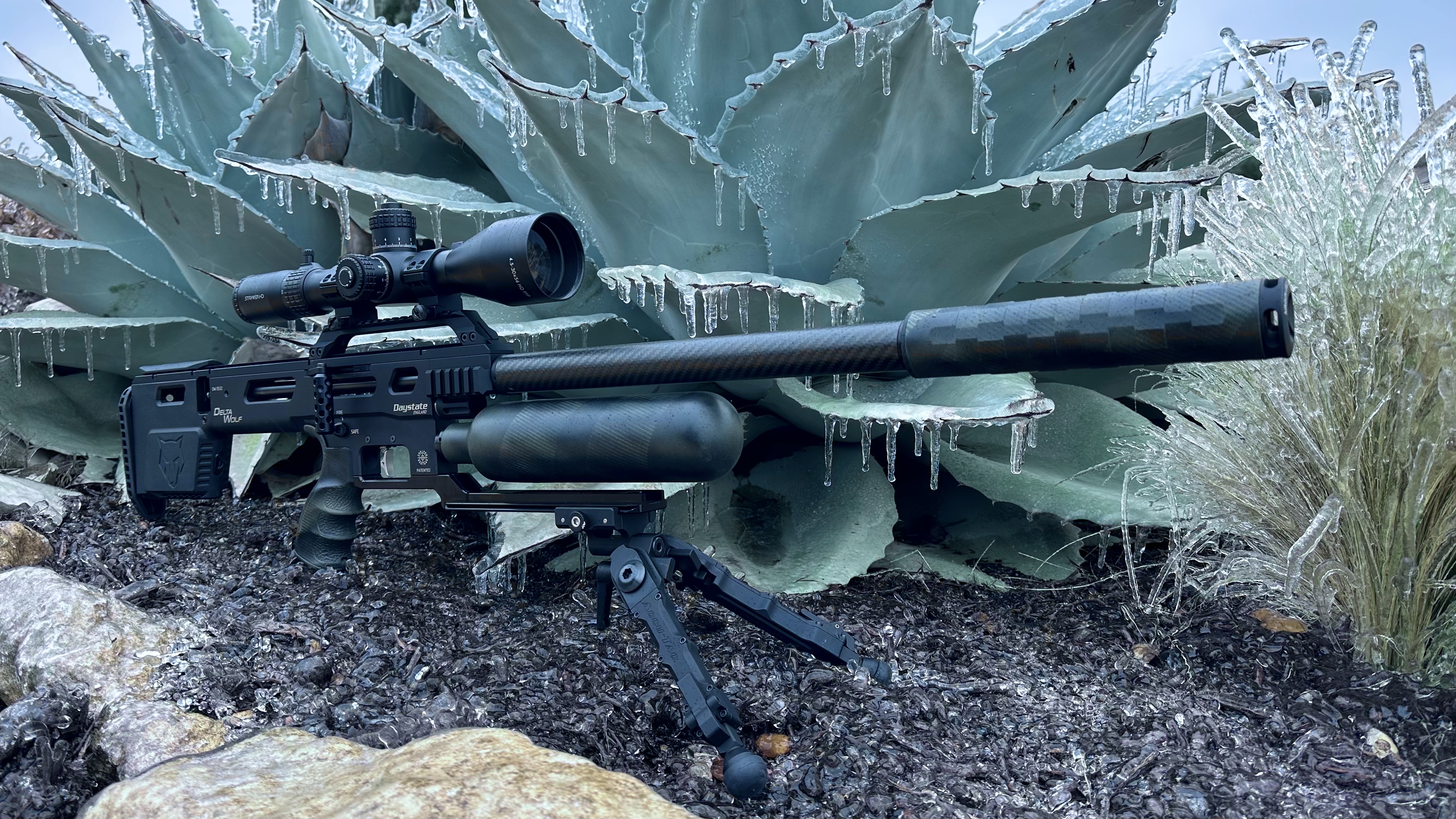

When nature hands you a photo op -2

Have to ask Michael.... is that a frozen aloe plant? Can honestly say I have. never seen that!
