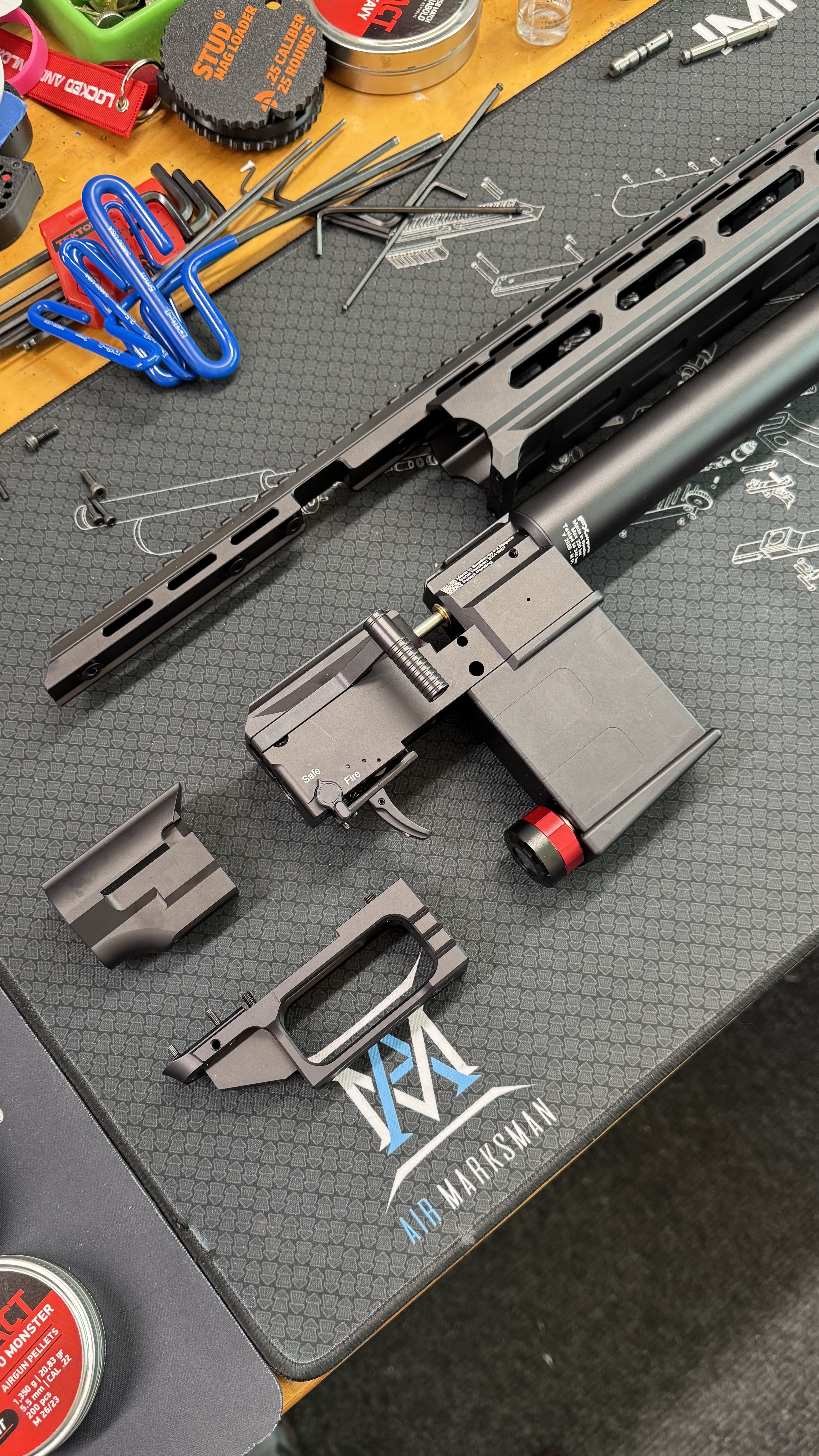

If you do feel the need to tune it, the adjustments are more accessible in the Classic version as all you need to do is remove the stock to access the HST. But, in order to access the HST on the DRS Tac you need to remove the top rail, trigger guard, and stock adapter. It looks intimidating, but its actually only 11 screws.
