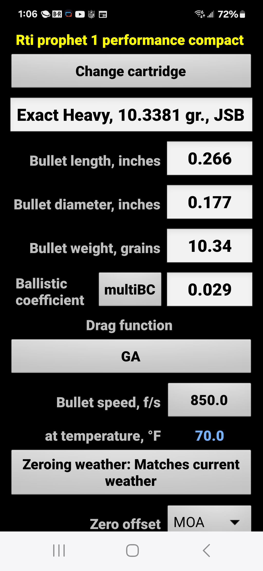

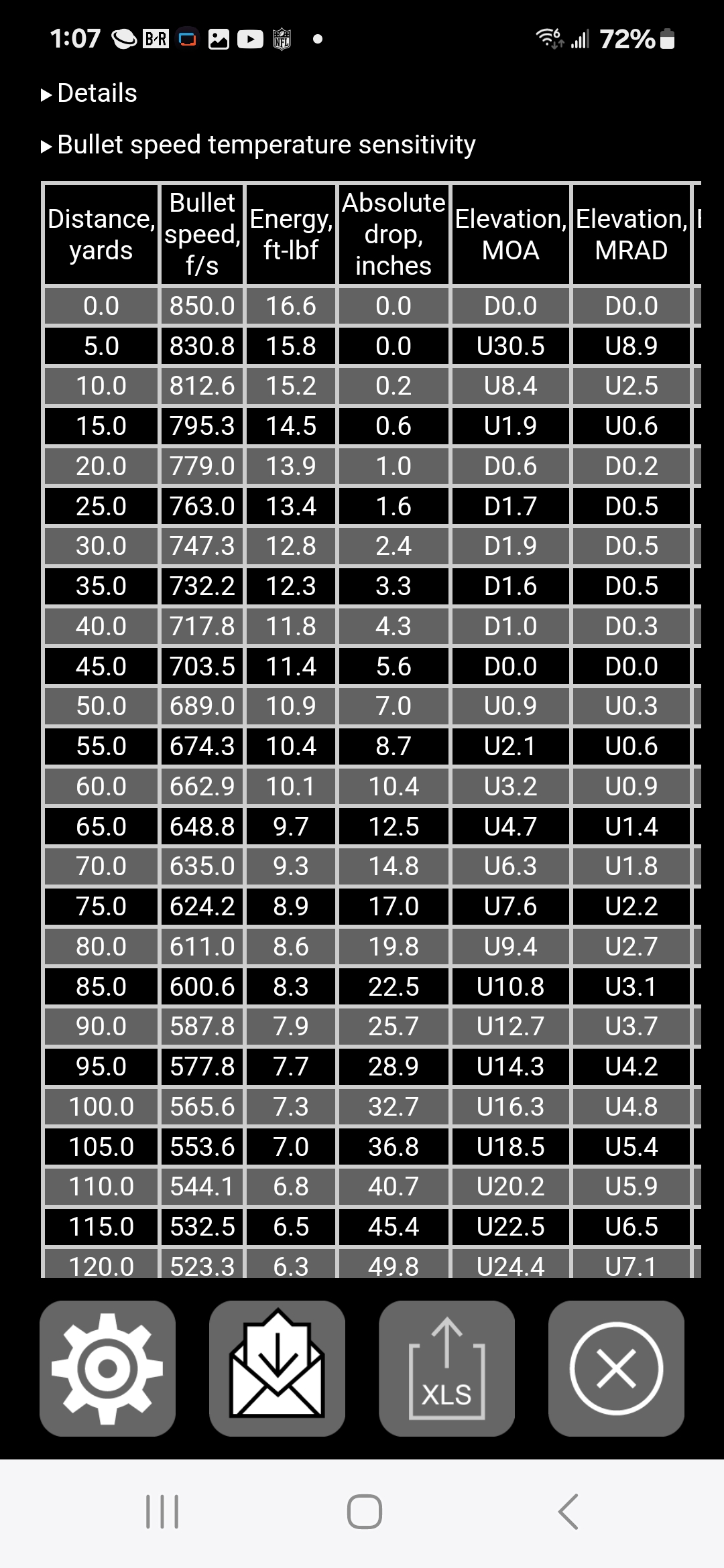

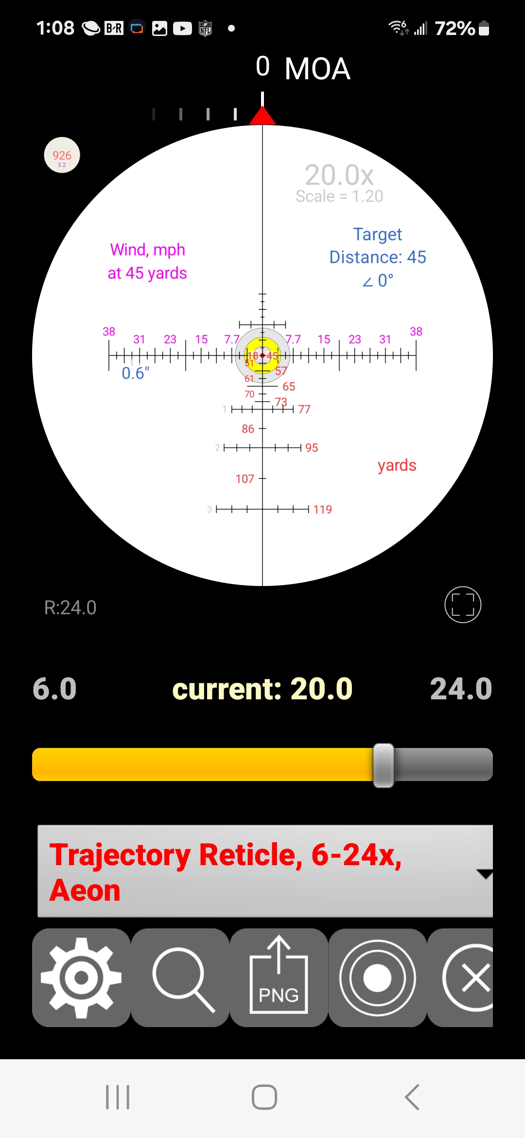

You want the 177 anywhere fron 850 to 900 with jsb 10.3. I have mine @ 850 with jsb 10.3 and reg @ 105 with plenum install. Will shoot small clover leaf @ 70 yds. Prophet 1 performance compact. 177.
