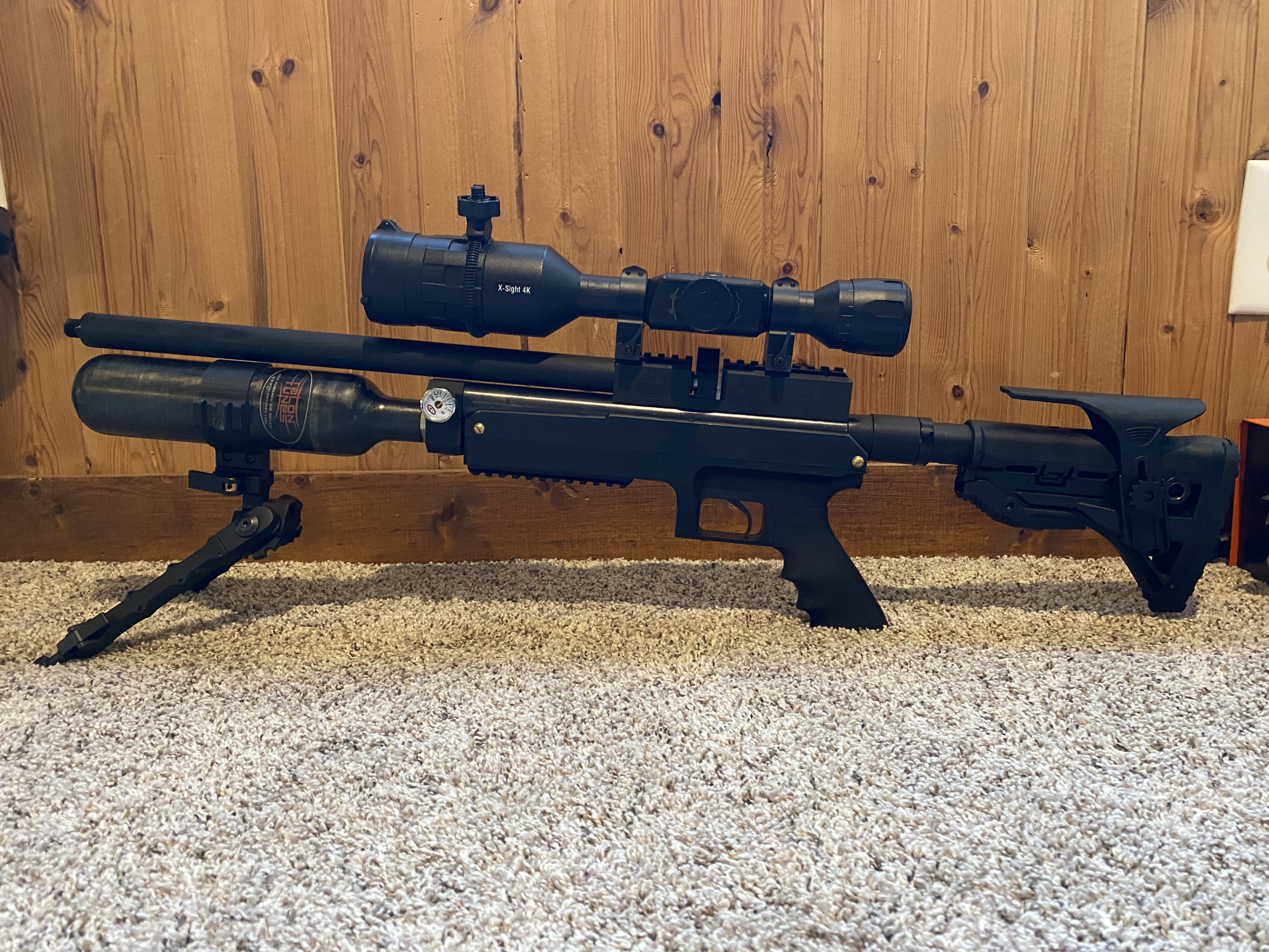

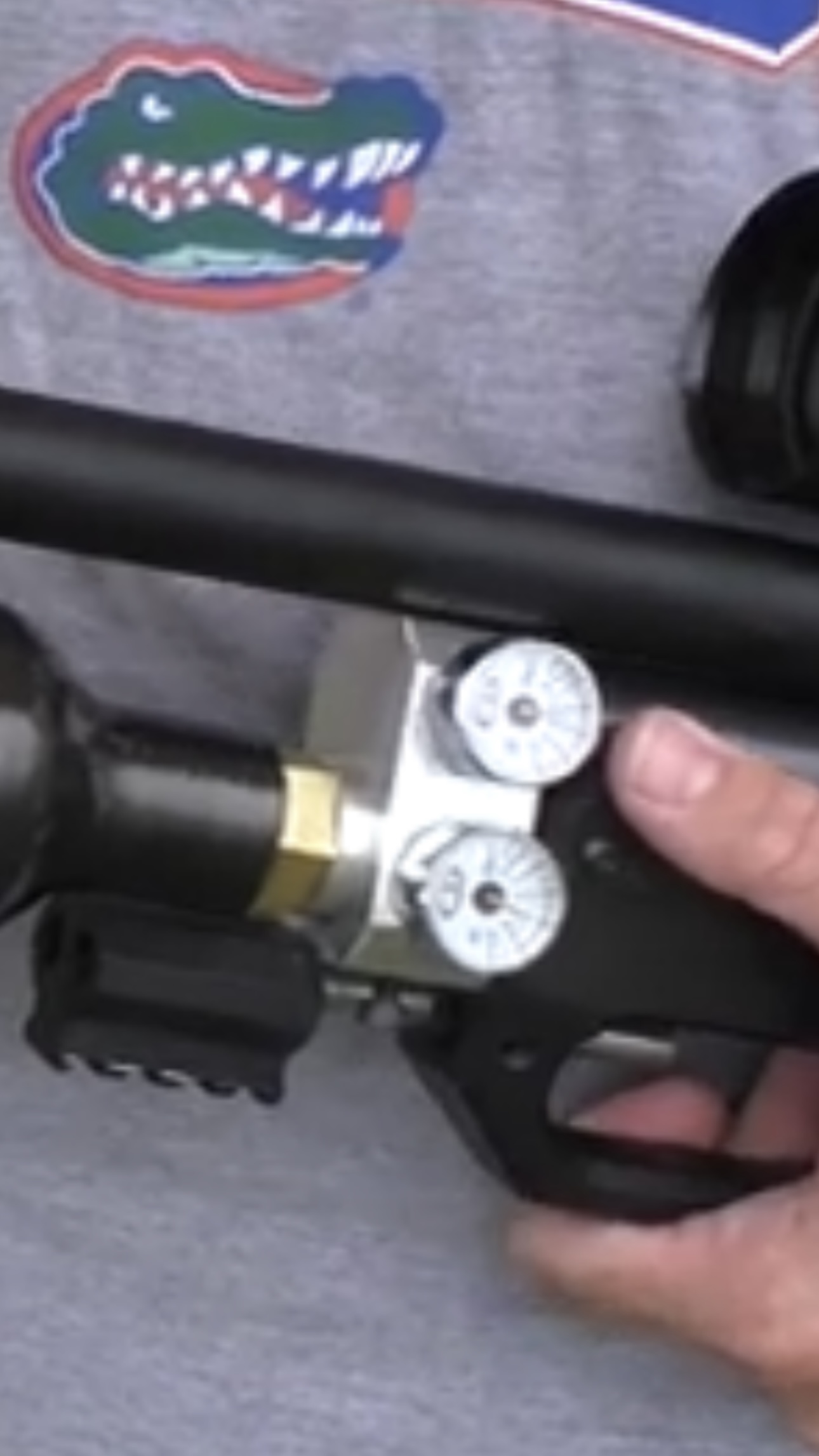

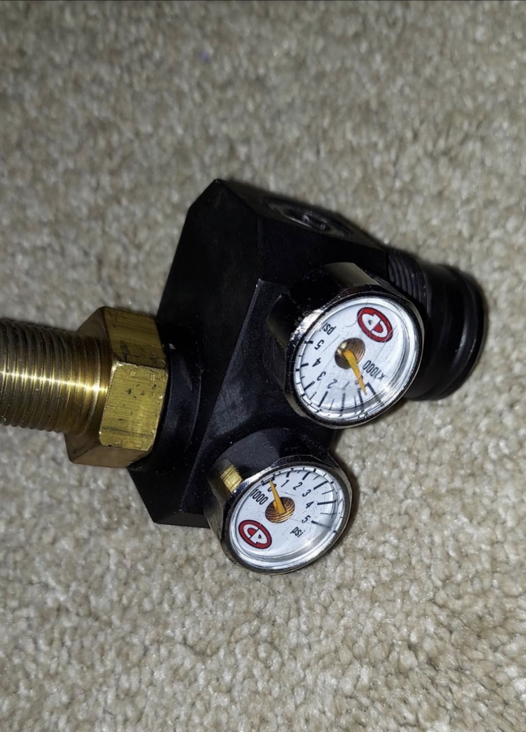

Hey guys. I am looking for a regulator for my Wicked Air Rifles Flex. I know with WAR not currently in business it might be tough. Was thinking someone might know the type of regulator they take or one that would work? Any help will be much appreciated! Thanks in advance!
Would you know what output psi I should have my .30 cal flex regulated to?
As I recall, with the factory 17" TJ .... @ 2200 using the oem war valve.
Fitted with a Balanced valve and same barrel, Lighter hammer with less stroke at @ 1800
Balanced valve as above and the 700mm FX barrel I'm down @ 1600 for the @ same 80 fpe output with 44.75's
* If you search my Name and WAR / Balanced valves on the GTA forum there is Tons of data there ;)
Best of luck !
