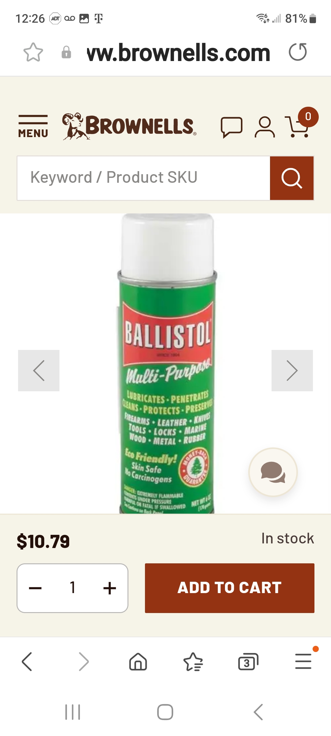

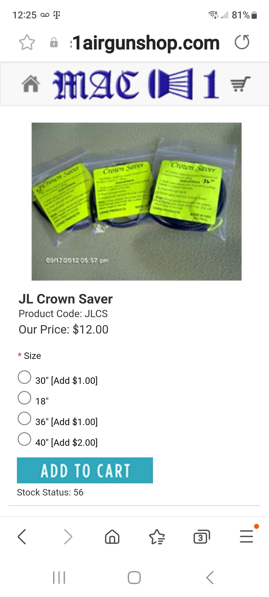

Don't overthink it. Clean the barrel good. Wipe down after shooting and enjoy. Fine out what pellet shoot best and have at it. The Avenger is a nice starter airgun. Welcome aboard and enjoy your toy.
