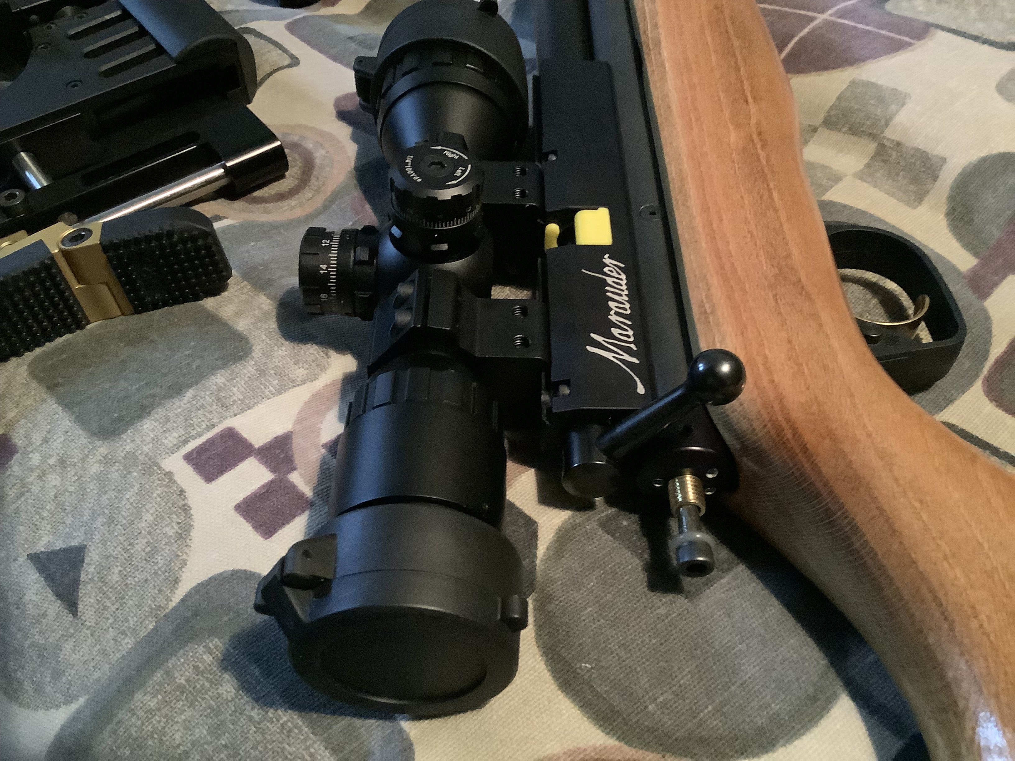

Dug up a pic of how I had to vent mine after I built a SSG. If you wrap the grub screw in the center of the plug on a stock gun with Teflon tape, you’ll get erratic hammer strikes. It’s because now the hammer tube is sealed. It needs to breath. And prepare us for the optometrist glaucoma test.
Yessir. Makes absolute sense… the displaced air in the space where that hammer resides has to go somewhere. And that hammer is a good size relative to the space. For every action there’s a re-action as they say… a free glaucoma test is the result. :)

Back when that pic was taken I would imagine it was one of my MKll power plenum Impacts. Like the Prod, some other member here now owns it.
