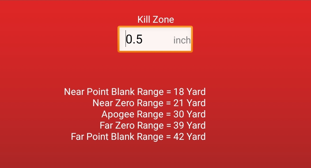

I have my Avenger shooting this way:
And if you go into Chair Gun app tool box you can click Calculation Items then Optimal Zero Range
Then you can set the "kill zone" size
And I am zeroed at 30 yards now but it suggests a 39 yard zero.

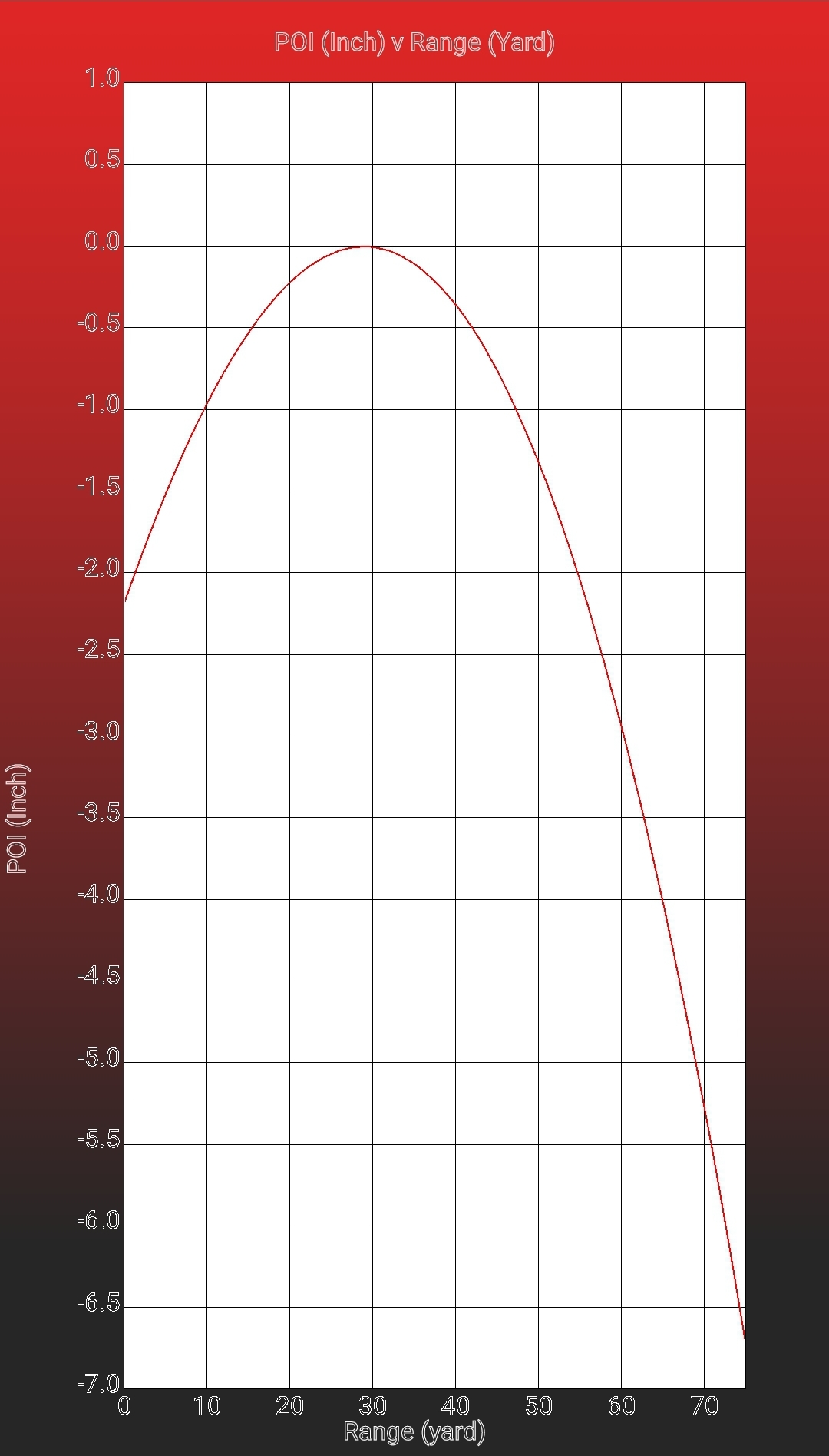

My 30 yard zero pellet arc

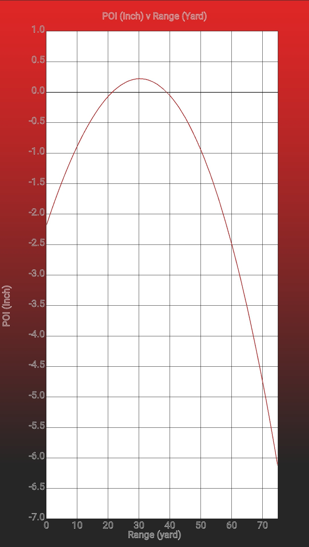

VS a 39 Zero:
Would be interested in hearing if anyone else does these calculations and actually uses the suggested zeroes. I don't cause I like not having a hold UNDER. But it looks like only .25" under.
What are your thoughts on that?
Well what is interesting is this isn't suggesting a trajectory apex because it is saying to have my far zero at 39 yards, which is my 2nd zero per the graph. My 1st (close) zero looks like 21 yards. And in between those is the apex. My 30 yard zero is closer to zeroing at the apex.I start with Optimal Zero for a hunting gun & actually go out & check it.

This^^^If using HOLDOVER for POI differences over differing distances .... *ONE ZERO & that being based upon pellets weight, speed and scope height.
When NOT zeroed at pellets flight apex (* For most this falls in the @ 23 to 35 yard distances ) you will have 2 zeros and a span in distance where a HOLD UNDER to get a correct POI would be required .. Thats bad and will create unnecessary miss's

Yeah I understood that one of the charts you posted above was more or less trajectory apex and the other Optimal Zero.

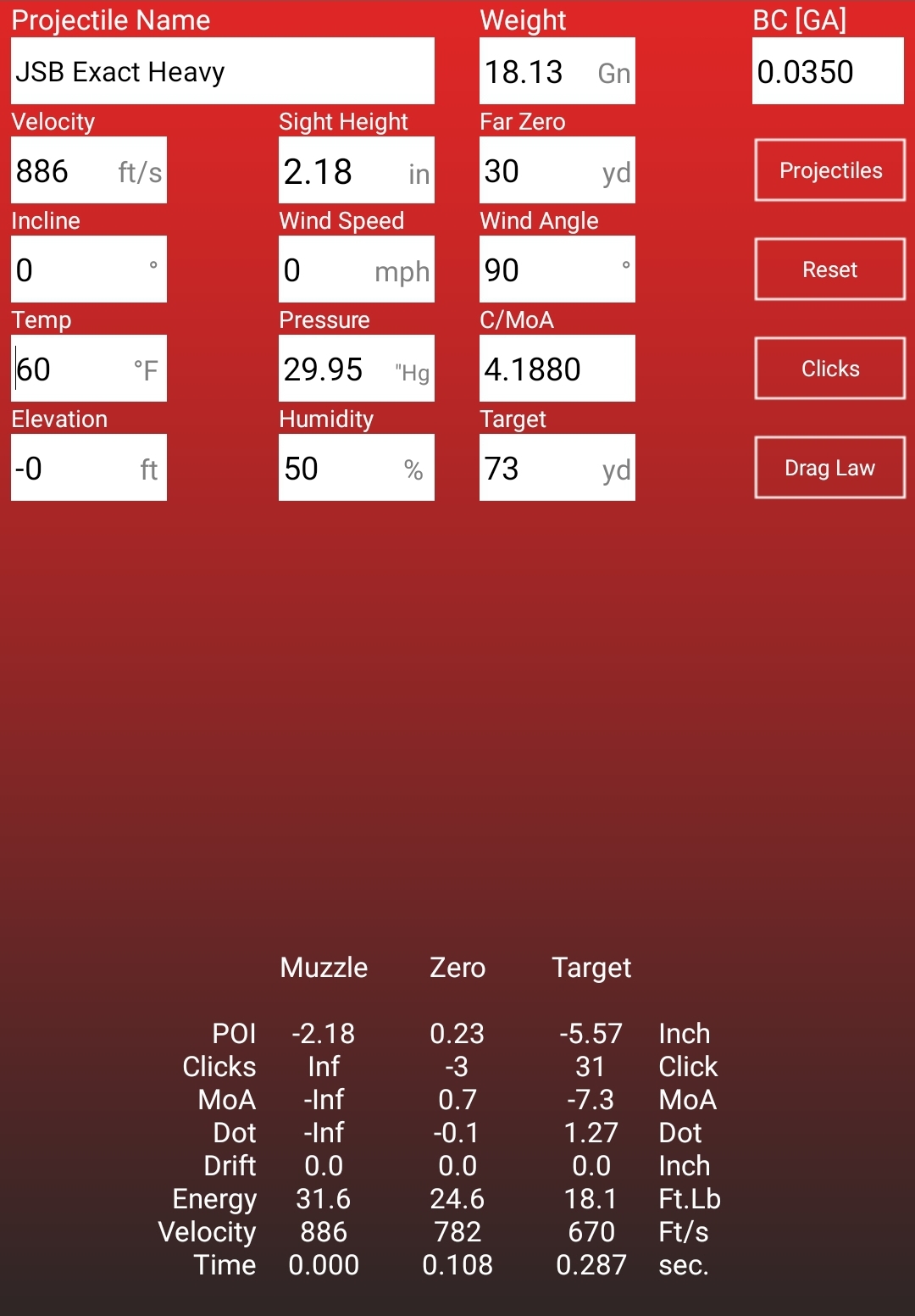

I'm home with a sick dog and pouring rain outside to I entered your tune and zero into Chairgun.
With the 30 yard zero and a 1/2" kill zone I'm getting a Point Blank Range of 19.4 to 38.3 yards.
With Optimal Zero is calculated as 39.6 yards I'm getting a Point Blank Range of 17.0 to 43.4 yards.
In your situation I would probably use Optimal Zero. I wouldn't mind being 1/4" high at 30 yards for shooting metal targets.
But even then that depends on what you mean by far when it comes to your target shooting.
