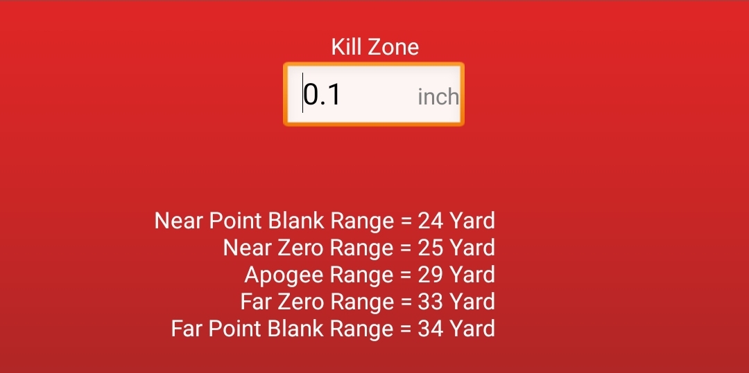

Well look at this! It changed the far zero from 39 to 33 when I used your helpful suggestion of a smaller kill zone. (0.1")
So my current set up of 30 yards isn't as far off of optimum as I thought! Plus as you explained, I definitely prefer .1 inch over a half inch margin.

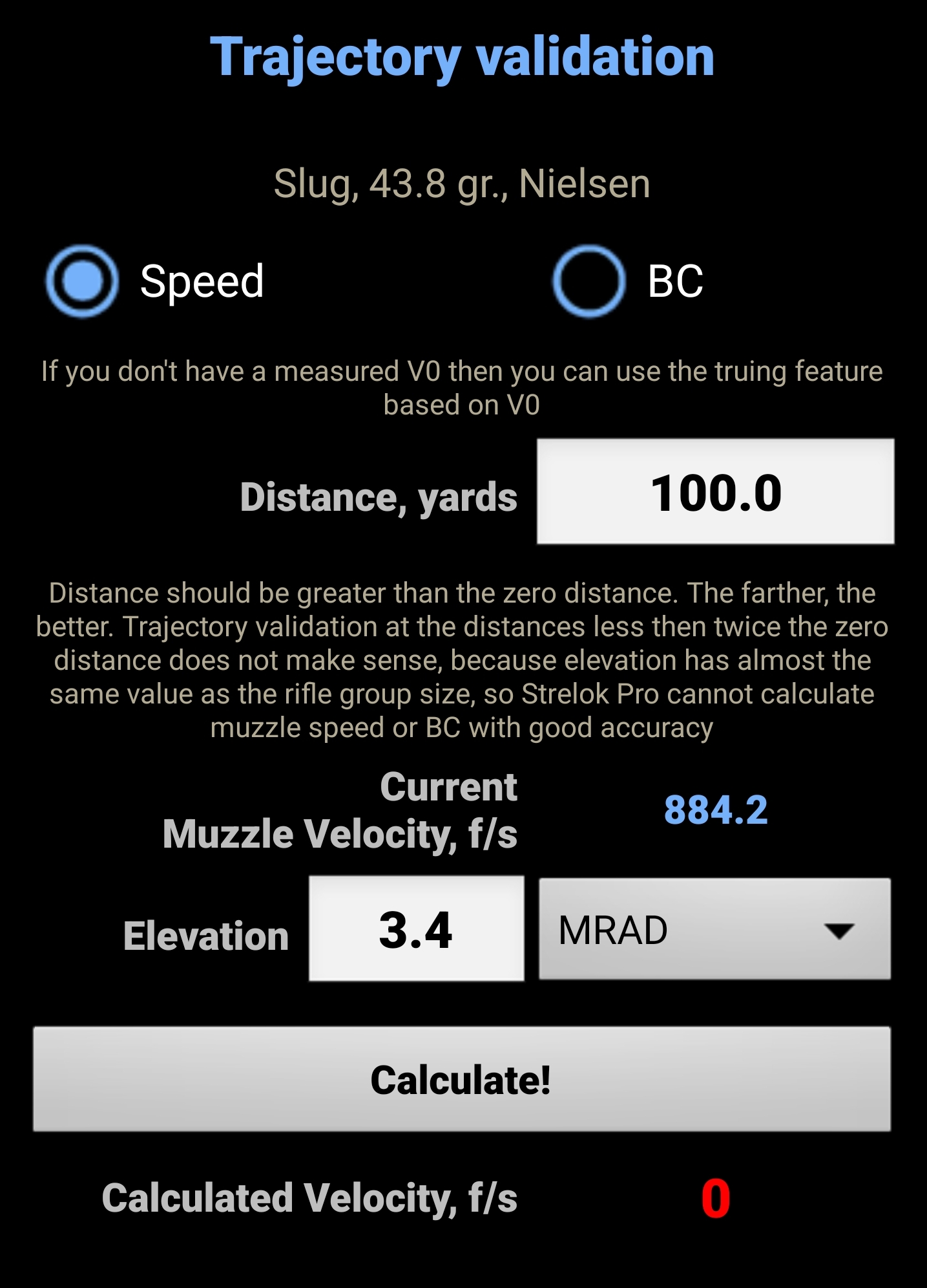

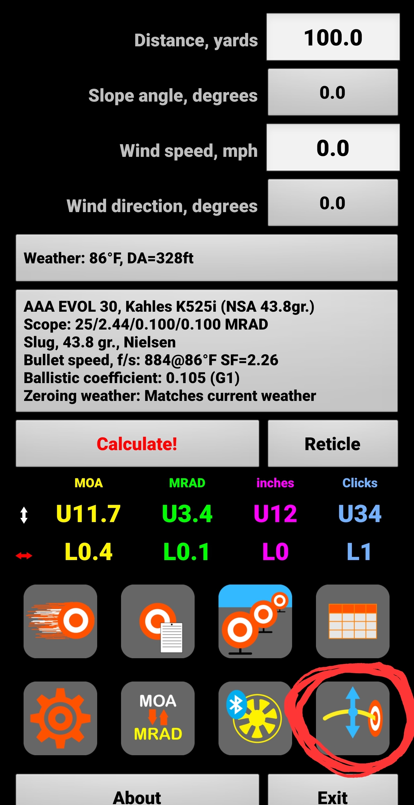

My zero really depends on the power level of the airgun. I do the basics (Scope height, twist rate, velocity) on Strelok Pro to find my optimal zero. With most of my airguns shooting in that sweet spot of 880 fps, my zero is usually anywhere between 25 to 30 yards with no hold under. Once it's confirmed, I move it out to 100 yards and fine tune it. If Strelok says to dial 3.2 mils up but the actual holdover is 3.4 mils, I change the elevation in the Trajectory Validation and use the velocity it calculates. All this goes out the window on different days depending on wind direction and the amount of wind that day. I find it changes + - .2 mils in my limited experience.
