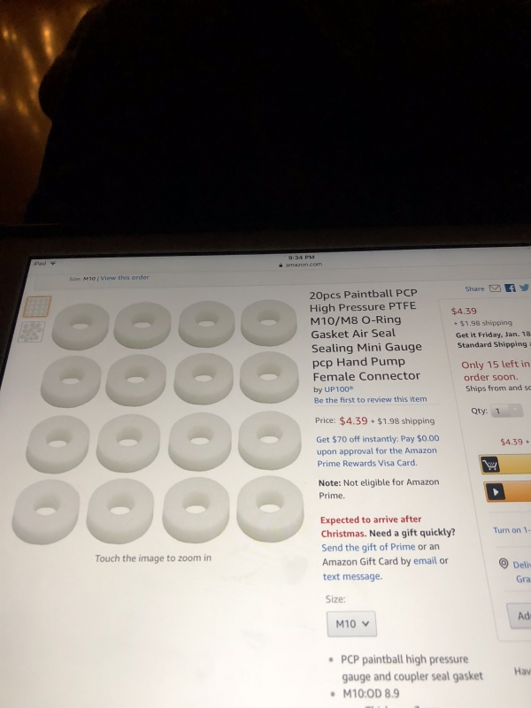

I ordered some 9mm nylon ones from Amazon but just 1mm thick. I was going to order through Aliexpress but I can't get past them trying to charge me sales tax illegally. They would have to have a retail business license in my state to charge tax and I know they do not. The plastic washer under my regulator gauge was leaking very slowly and was deformed from me over tightening the gauge. I had to spin it out with a left twist drill bit because a pick wouldn't move it. 3mm turned out to be too thick so I used a 9x2 o-ring instead and it worked great.

I think plastic washers are too soft for these pressures. I have discovered many squished washers almost covering the center hole. In my experience fiber washers are much better and much more reliable. Washers of all flavors, including Belleville springs are available through most industrial supply houses. The problem with all plastics is that it creeps under pressure and as the plastic creeps, the thread compression lessens so they start to leak. The common corrective action is to tighten the fitting and then the washer creeps a bit more and the cycle continues.

Go to Lowe's. In the hardware isle they have those trays of metric bolts and odd ball stuff. They have nylon washers in there. (Nylon will seal) I think it was the #8 that I used. You can get thin ones and stack them if needed.
I'm sure the problem is me over tightening the gauge to make the dial line up where I want. The actual torque required to make the gauge seal is probably around 12 inch pounds. To much torque on the manometer can make the thin aluminum underneath it to pooch out into the valve bore and cause problems in disassembly and reassembly. I'm going to be more careful from now on. Thanks for the help.
