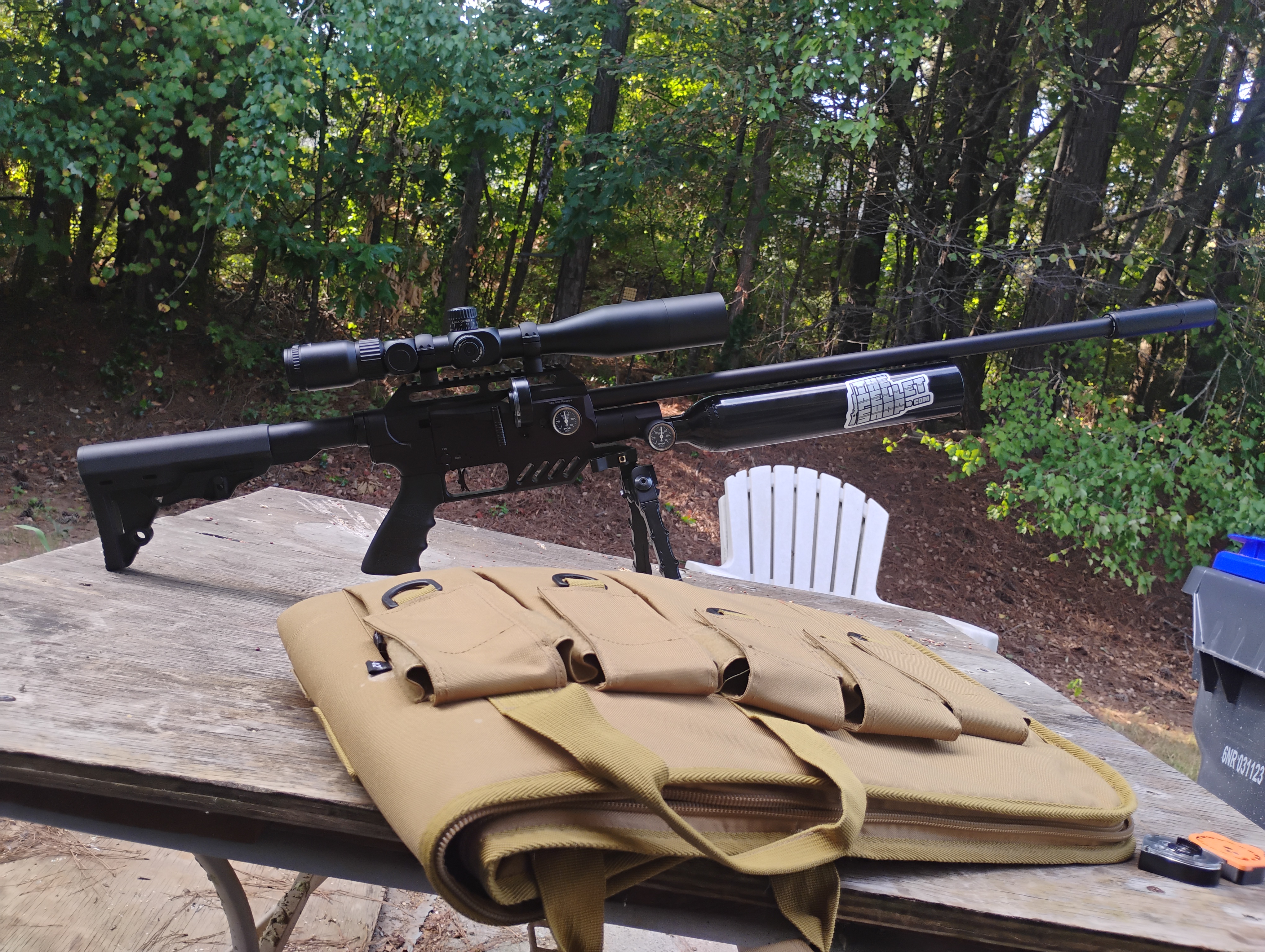

You likely do. That black tube around the liner is the barrel shroud. It's on. It's likely an ultra light model. I'd have to see a picture. But the shroud threads on to the liner lock. Its basically one solid unit and the two decently sized grub screws that secure the breech of the barrel in the receiver do a good job of supporting the entire unit.
Mine is a .25 caliber, I put a Donny FL Tanto moderator on it, I was worried about "barrel drop" when I initially bought the gun. It doesn't exist. The barrel is fine. The tanto has done its job very well. Even at higher powers my gun makes very very little noise. ..

and tell me please how long is your air cylinder? i am getting a 700cc bottle which is 41cm long and would like to be able to imagine how far the bottle will go on my 600mm barrel? i assume you have a 600mm barrel in your pics..
Yes 600. That's a 500cc 250bar aluminum cylinder.now I have a 500cc CF cylinder.

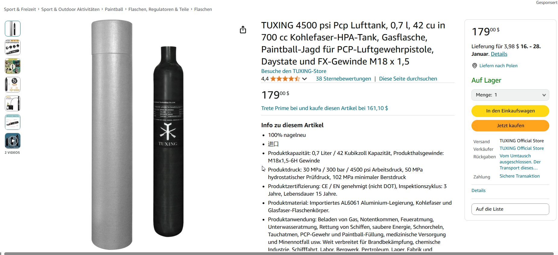

Buy the cylinder from Amazon. A tuxing (,alsafe,) carbon fiber cylinder with m18x1.5 threads. And get the fx valve separately. Do not pay the 300 for the fx brand. They use the same exact alsafe bottle. Don't get ripped off

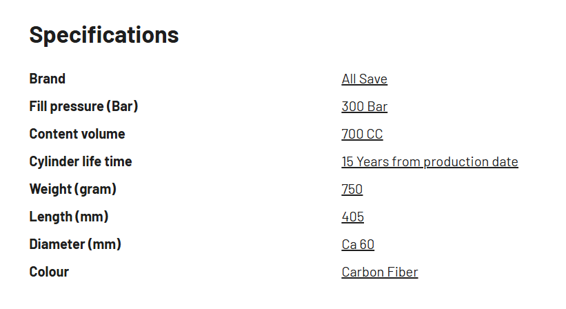

I was showing you my bottle. Mine is 300mm /1 foot
ok, so yours is 30cm long, mine will be 41cm long- good.. i just wanted to picture how far will my new bottle be on my barrel... i will get the 700cc...

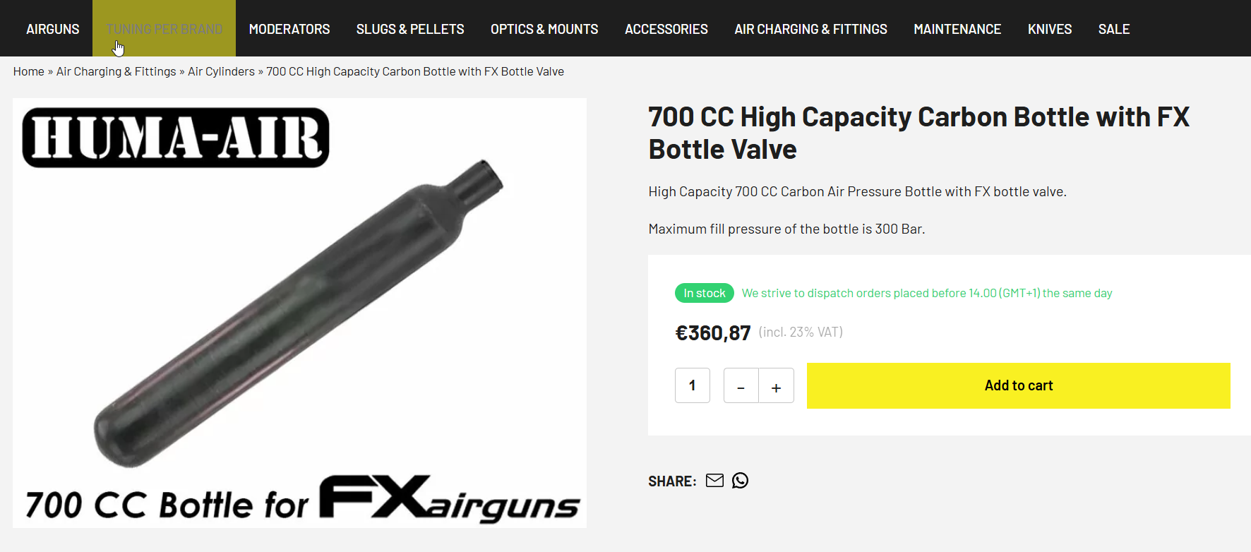

so this one from amazon for 179usd seems like a bargain instead of paying 360euro for the one from huma...
i just don't know yet if they ship to germany but will find out.. and then order the valve from huma.. is assembly easy- just screw the new valve in? use teflon or no..
