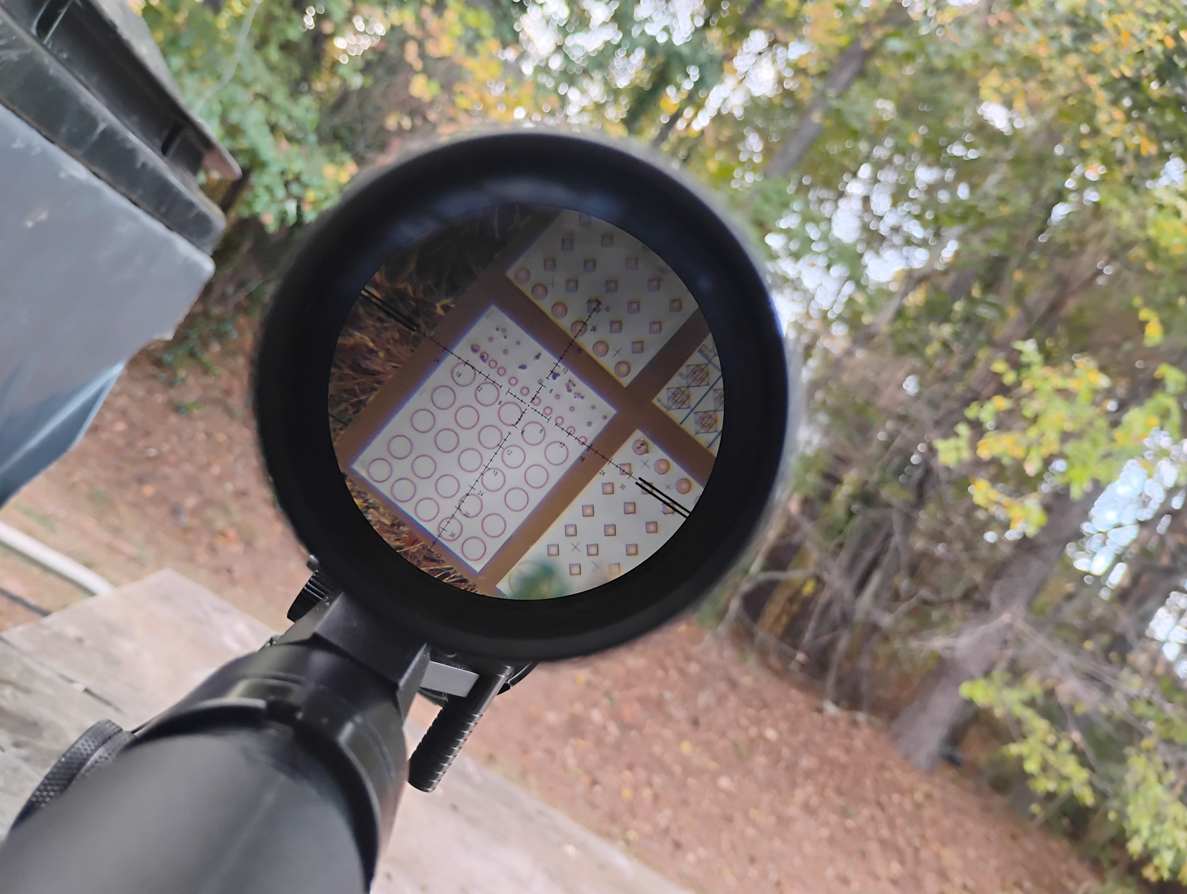

I love my dreamline. The accuracy is astounding. With the slug liner 1:16 twist STX slug liner I'm getting single hole groups out to 70yards and MOA or better average groups at 100y. With the stock STX superior.1:24 twist barrel. Pellets were shooting incredibly well. 1.2MOA or better at 100. It's a great gun.

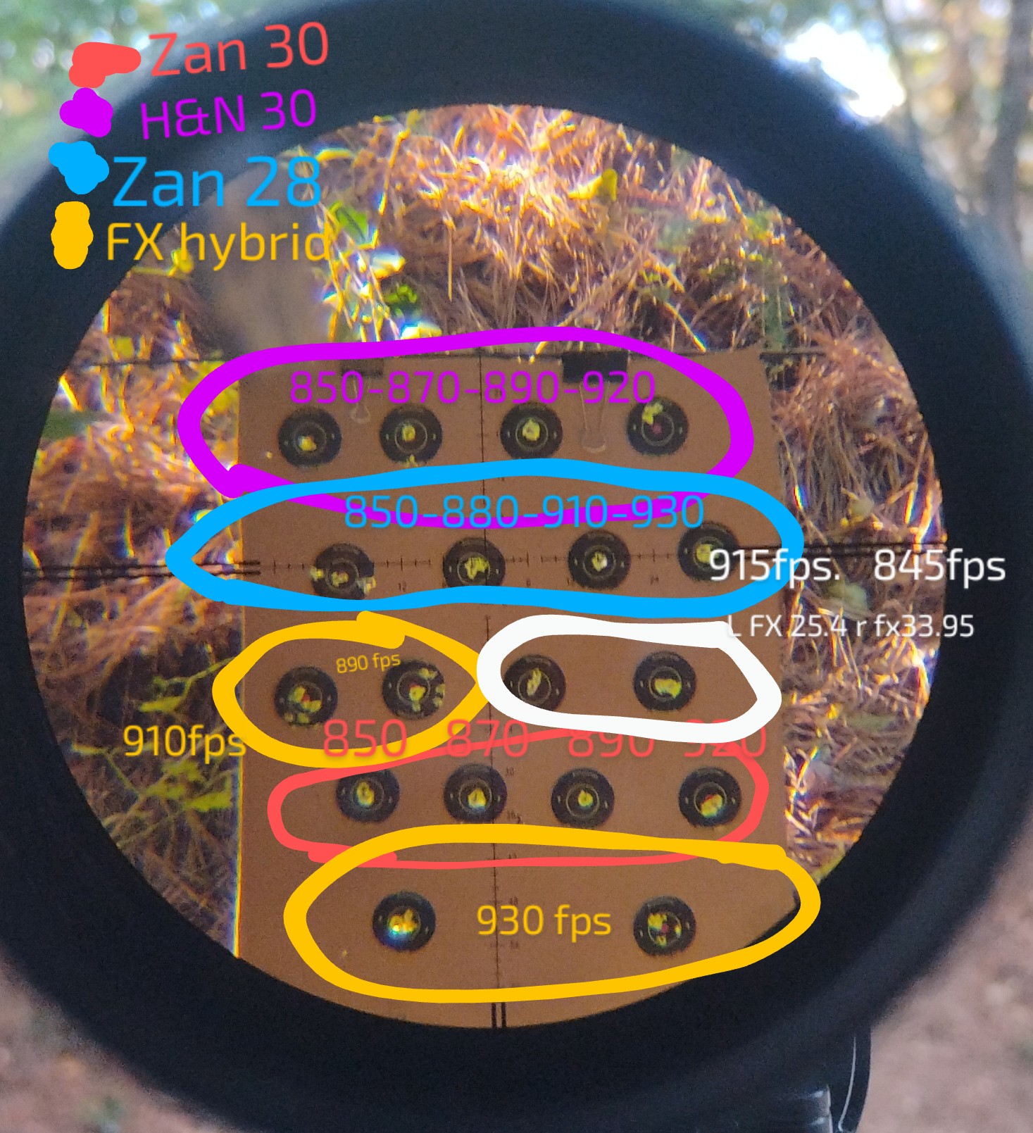

I don't know much about .30. But, there is a trend that seems to be universal..
H&N slugs seem to be the best in .22 and .25, by far. I have a 700mm DRS it has the power to shoot heavy heavy .22 slugs at great power, but I prefer shooting HN 21-23 gr and Griffin 19 and 21gr slugs at very high speed. The flat trajectory makes quick shooting of pests very simple, it extends my Point blank range and my shot count.
Id recommend trying HN Slugs first, ZAN slugs 2nd

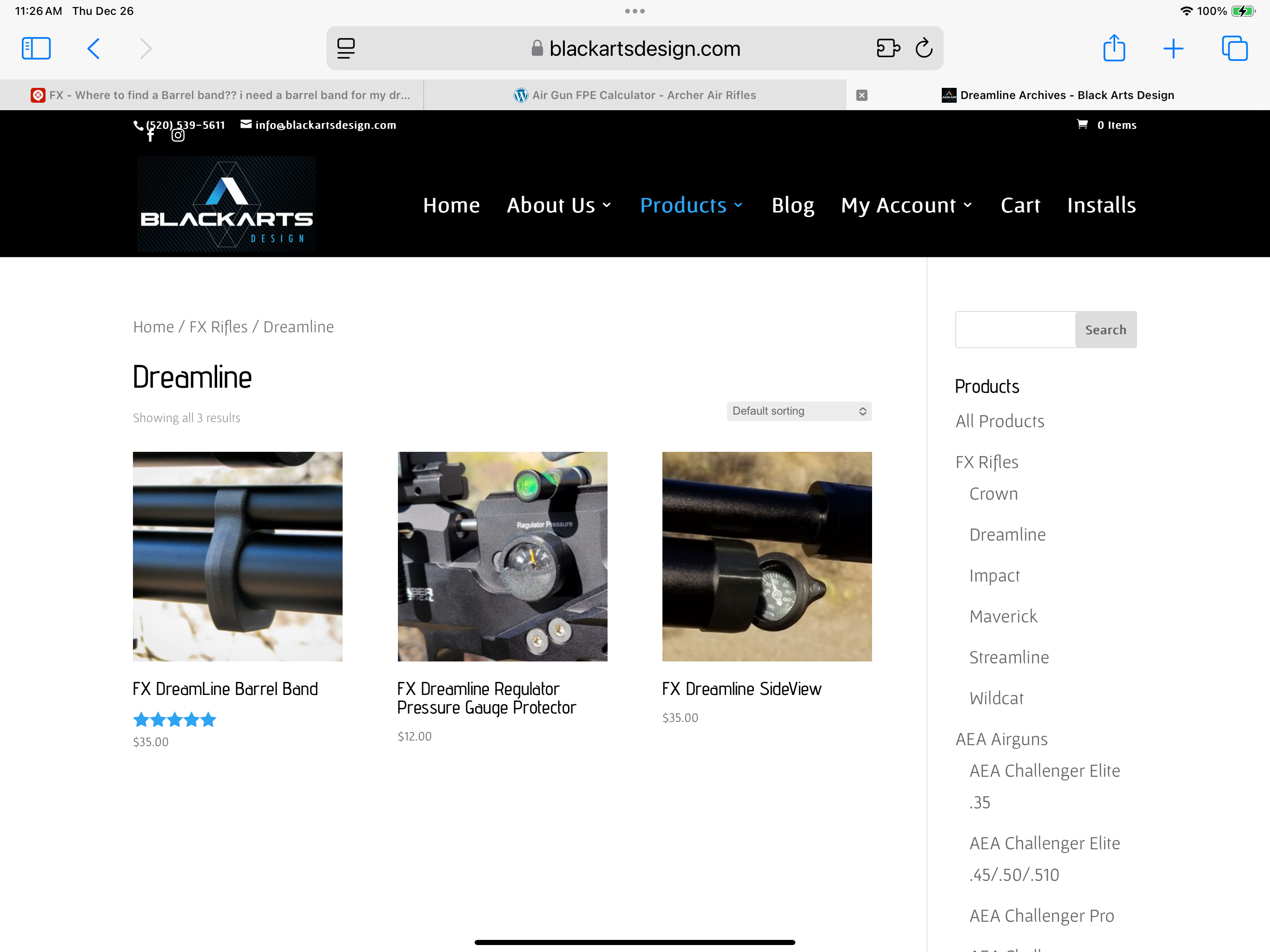

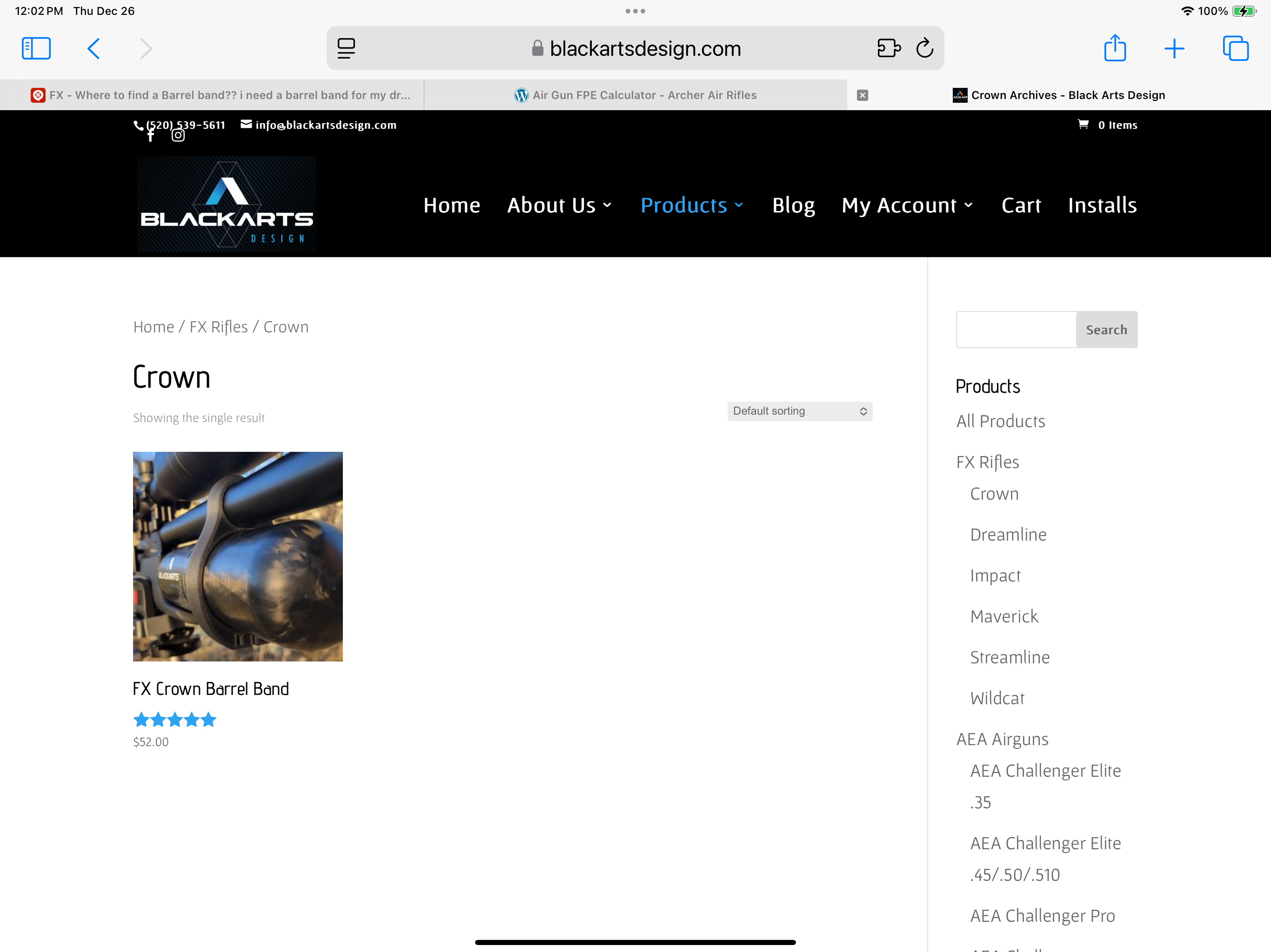

i will start by saying that i hate the fact that i have to look for this ugly barrel band on such a good, expensive airgun- this seems to be a weak point to its design but hey, it is what it is..
i will swap my cylinder for a 700cc carbon bottle (2024 dreamline lite with .30cal 600mm barrel)
i am looking for a cool looking barrel band that has a rail on the bottom for the bipod
i can not find anything except those ugly looking tinny bands that fit the barrel/cylinder.. but not much for the carbon bottles
so maybe some of you got already some bands for your carbon bottles and care to share a photo and a link to the product
i know one can print 3d anything but i cant.
this is the bottle i will get- length 410mm, diameter 60mm..
You don't have to, but Google is your friend. Ebay and even thinigiverse if you have a 3d printer . Wait till you have it and shoot it yourself. There's a lot of trash fuddlore forum opinions and hate from people who bought dreamlines and shouldve bought a notos instead. You get a lot of trolling from poors too. See how you like it, if it absolutely needed a barrel band like it needed the plenum, fx might have added both.
she is pretty :D
thank you for the info- you are not pooping on my plans- you are telling me that i dont need a band which is great! i hate the looks of it but keep seeing so many for sale that i assumed it is NEEDED...

HN and Zan seem to work very well at any speed. They also expand the best.
I might catch flak for this. Dont even bother with the hybrid slugs..
Same findings, bought a ton of hybrids and they're not the best thing for accuracy in 22. Great for rabbits and pigeons tho. My 25 is similar results but it anchors whatever you hit even if a poor shot usually.

No. Exact kings are trash and seem to fly with a nose down pitch heavy mk2s are lasers out of it. From 80 and in Hades are laser like as well, only opening slightly to 100. But HMK IIs are unbelievably accurate out of the .25 slug liner

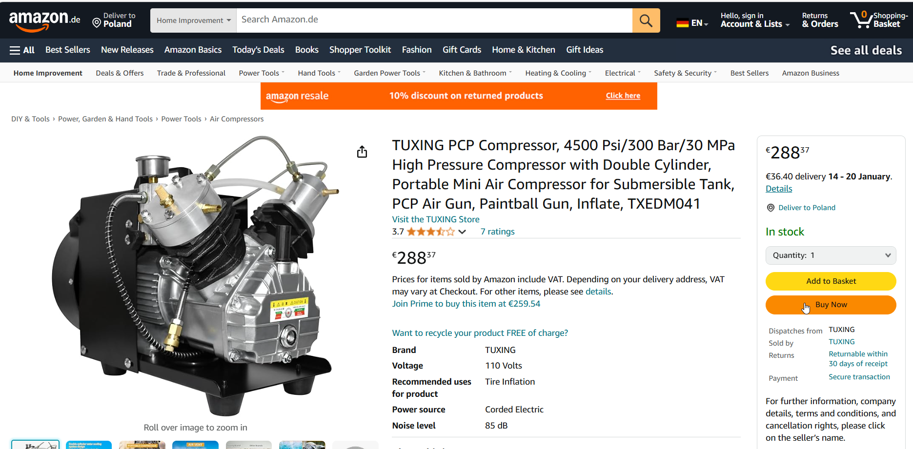

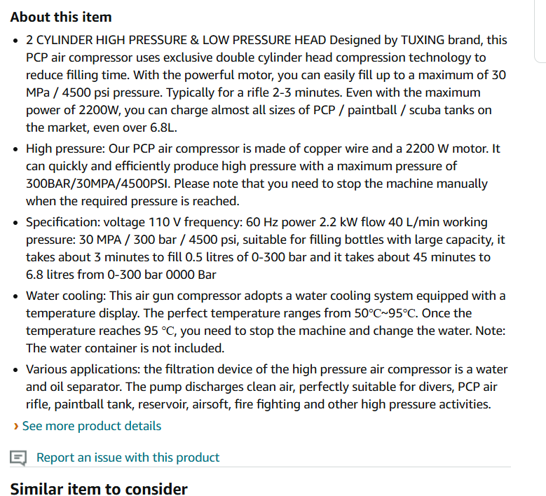

tell me if THIS compressor is a good choice..
you know, we talked about the orange box, the one that costs 270euro and is a good choice..
but this one from tuxing costs only 280euro but its double so strong- it has 2 cylinders and can fill double the speed... is this choice not a double so good compared to the orange box?
I haven't got experience with that particular compressor model but I do have faith in the tuxing stuff. I bought about the biggest compressor they make and it's been solid so far.
