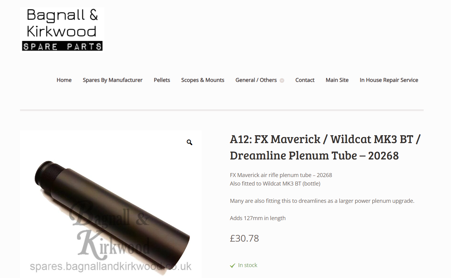

i got a good question for you- i just read about the dreampup and its 80cc power plenum..
did you consider using that 80cc in your dreamline- yes or no and why?
i thought putting more then 2 plenums brings no more benefits because the dreamline is limited with the port size or valve system but the dreampup has maybe same internals as our dreamlines and only has that one thing going for it- the 80cc plenum instead of our 17cc plenum..
so how is it supposedly so strong with just that 80cc plenum addition and why not use it in our DL since we share same internals with the dreampup- or do we share same internals?
Saves money over buying 2 FX power plenums
yes- but its perhaps too large for the valve system of our dreamlines... maybe the valve is larger on the dreampup to accommodate that much plenum air..
did not find any posts of some dreamline owners using it.. just curious.. i don't want it- 2 plenums more then enough for my taste
Don't think so. Plenum Air is just air that's at regulator pressure, post regulated reserve air. The valve dwell has more to do with the hammer stroke. I think it's more of an issue of aesthetics. Typically one plenum is fine. I just use two because I want to be sure I can get every bit of power available to me. I haven't seen much different between one or two. That's a good bit longer and would position your tank further forward. You asked if it would work, which, yeah, it would.
yes- the guy from channel 910 gun repairs or something like that tested 1 and 2 plenums on his dreamline and showed the fps.. the second plenum did not change much but it did give 15-25fps (20fps on average) increase over 1 plenum only..
so for some this would be only 20fps and other as much as 20fps..
depends on what you're chasing but i will use 2 because the 20fsp extra might just do the trick with some slugs between working and not working..
