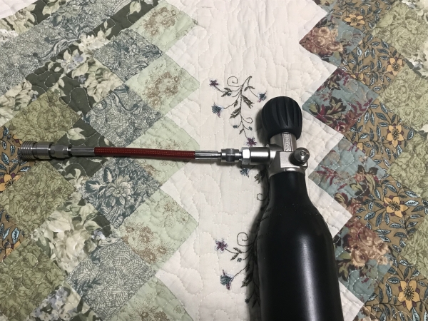

Jimmy,
I see they have these for 5/8"UNF (ninja paintball) but it looks like the output is a male DIN? never seen that before. Can you post a pic of yours? Based on the "basic valve kit" picture it doesn't look enough parts to make it work as is. Or do you also have to buy that din to 1/8" gauge?
They have them in both tank thread configurations (selectable) and with the supplied Allen wrench you can remove the DIN fitting and screw in a nipple that the hose screws onto directly. I got the basic kit without the gauge. Here’s mine and I almost forgot that on the gun end of the hose it has one of the BSP swivel female nuts that that has a cone shaped seal in it. I just happened to have a male Foster that was the same. I think it might have been one shipped from Daystate. Just a heads up so you won't be completely thrown off .
Jking
1545859859_17896694975c23f3130f0245.89678970_CC44B968-7469-4710-B218-B4DF2A4D80D7.jpeg
Yeah, the basic kit, the gauge assembly would screw into where the nipple I mentioned before goes and then that nipple would screw into the other side of the gauge assembly, then the hose onto it. The bleeder is on the exposed side of my picture. It's the silver round button sticking up. It's spring loaded. Just push it and it relieves the pressure on the hose once the valve is closed.
