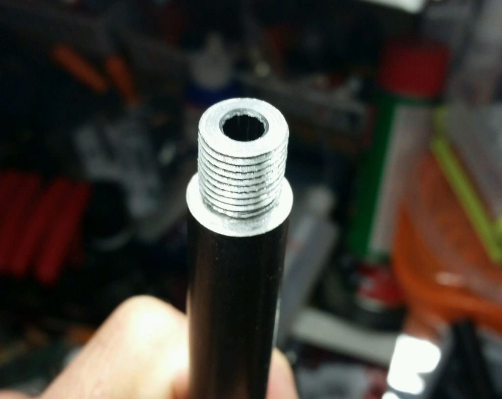

This is not always a guarantee either. I picked up a used one (from my research) that a well known "machinist/tuner" from another forum had put a CZ barrel on and a Huma regulator in. The barrel looked like some one had threaded and crowned it with some caveman tools and the reg was jacked from being set over the 170bar mark.
