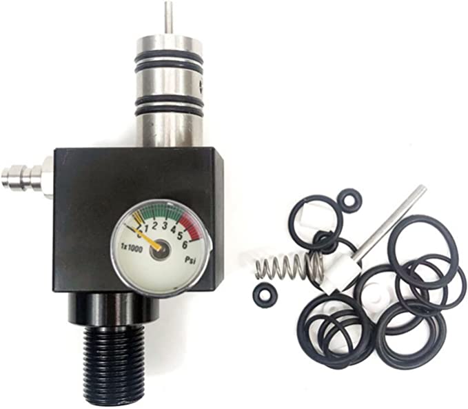

What are the part numbers for the drop block and whatever else you show in the image?

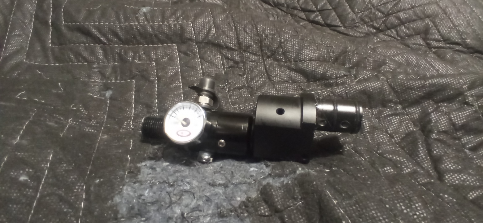

yes it comes apart, bottle regulator screws directly into the block, standard 1/2G, but it doesn't have a valve pin depressor, I used a 4mm screw and cut off the head, cut to about 15mm long and tapped the hole directly in the middle and screwed it in tight to make it a valve pin depressor, you will need to do some sort of machining to the part to fit your needs.
