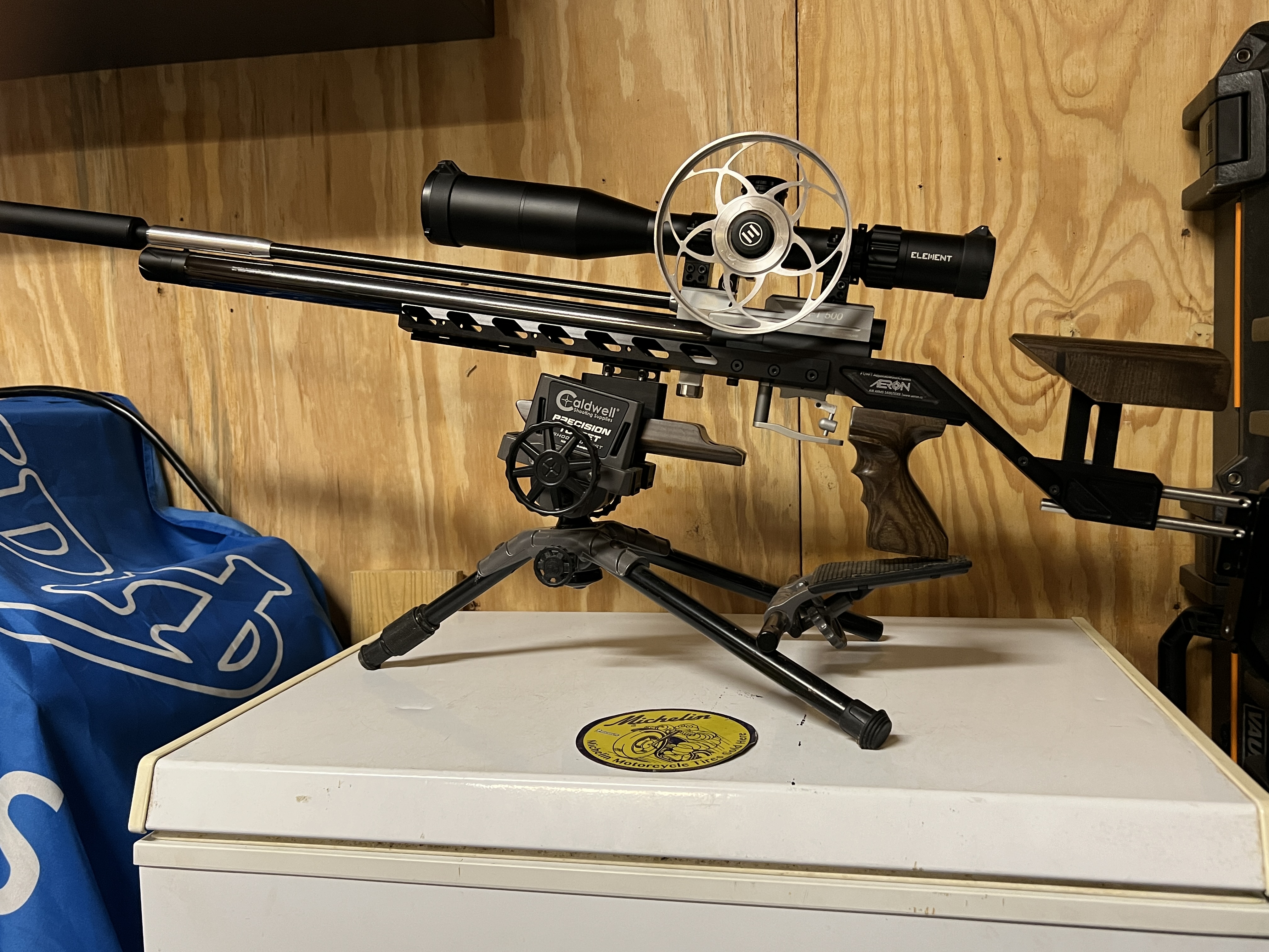

AA S500FT in a Aeron chass also have an Anschutz 8002 prepped by AZ And a RW tuned for <12 on the low power setting
