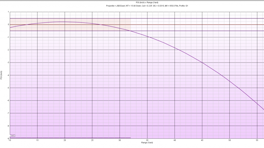

I know Michael has/had his Leshiy setup for FT and I'm considering that option as well over the .22 as I can set it for the H&N 8.64 FTT @ 800 - 850 and it's very accurate and flat. This pellet has surprised me in the wind as well. I'm able to hit with 1" at 42 yards probably 7-8 times out of 10. The toughest shots seems to be when the wind is coming at you and all of a sudden you see the pellet just drop an inch or two off where you aimed. Depending on hold the Leshiy can snap to the left a bit when shot.
Here's a Chairgun of the .22 rifle I plan to use:
The curve is very tight between 10-30 yards so I don't think I would click anything to adjust just hold a 1/4" high or low depending on the distance. Out past 30 it'll get interesting with the drop, but my dope card is pretty accurate.
