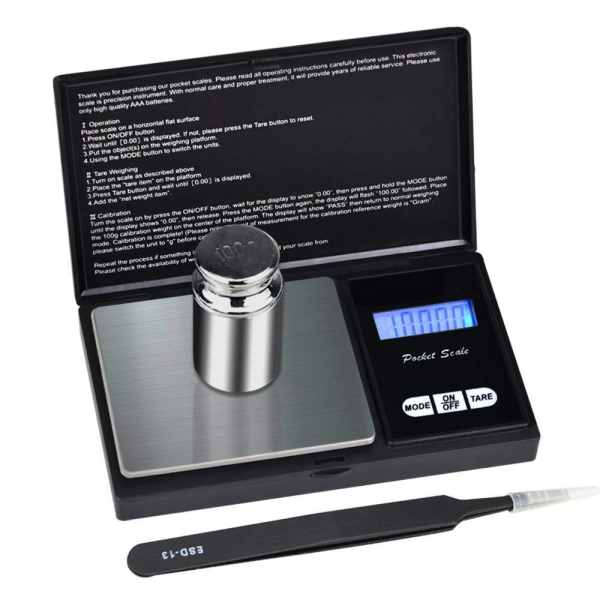

Since the OP is talking SUPER accurate performance and is aware that there is match-grade ammo for even the .22LR, it should be noted that despite the marketing claims of match-grade air rifle pellets, the shooter can still improve it. The pellets vary in weight so by sorting it, consistency from shot to shot is noticeably improved. Instead of variances that may be over 5% of the pellet weight when pulled from the tin, by sorting them out, you can shoot an identical weight pellet. At 25 yards, you'd see the difference. At 50 yards, all of your friends will see the difference too!
