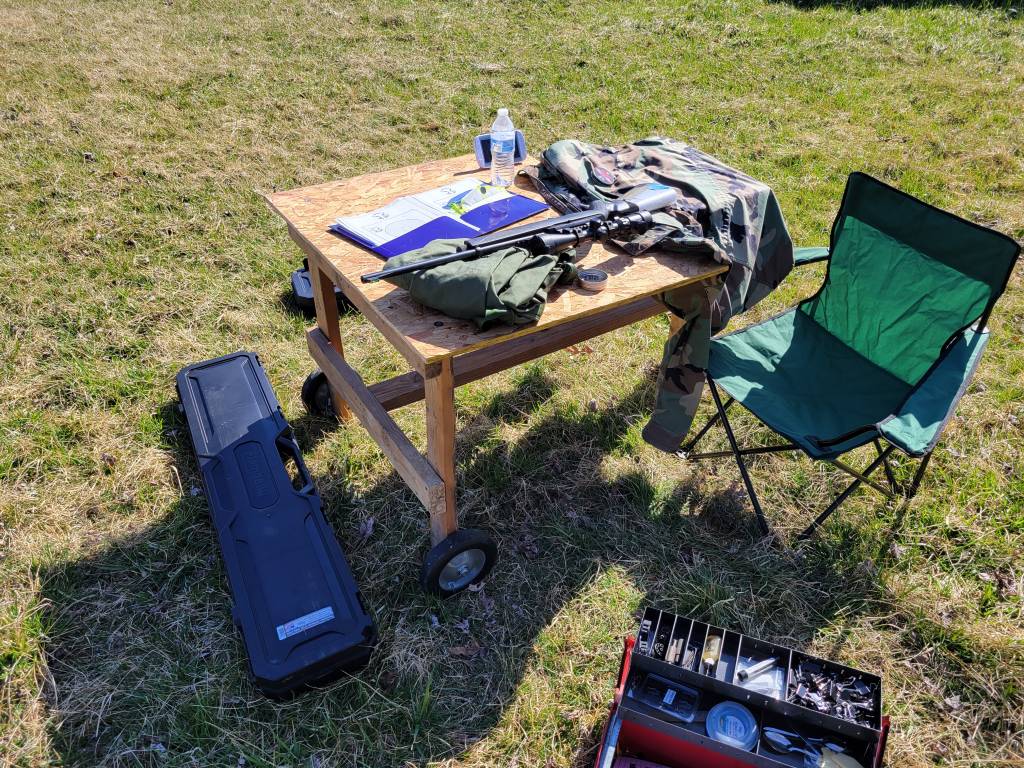

I just got the Eazy Fill so I am not sure it has had time to reach indispensable status yet, but between it and the air tank filling guns has become so quick and easy there is no longer any need to be concerned about the shot count of a gun. If I get mid 20’s for shot count that’s fine, 30 second refill and I am back at it.
Extra magazines
Bipod
Boony hat (prevent head/neck sunburn)
Shooting bench
Toolbox for all the accessories, pellets, and other tools/gear.
Gun case
