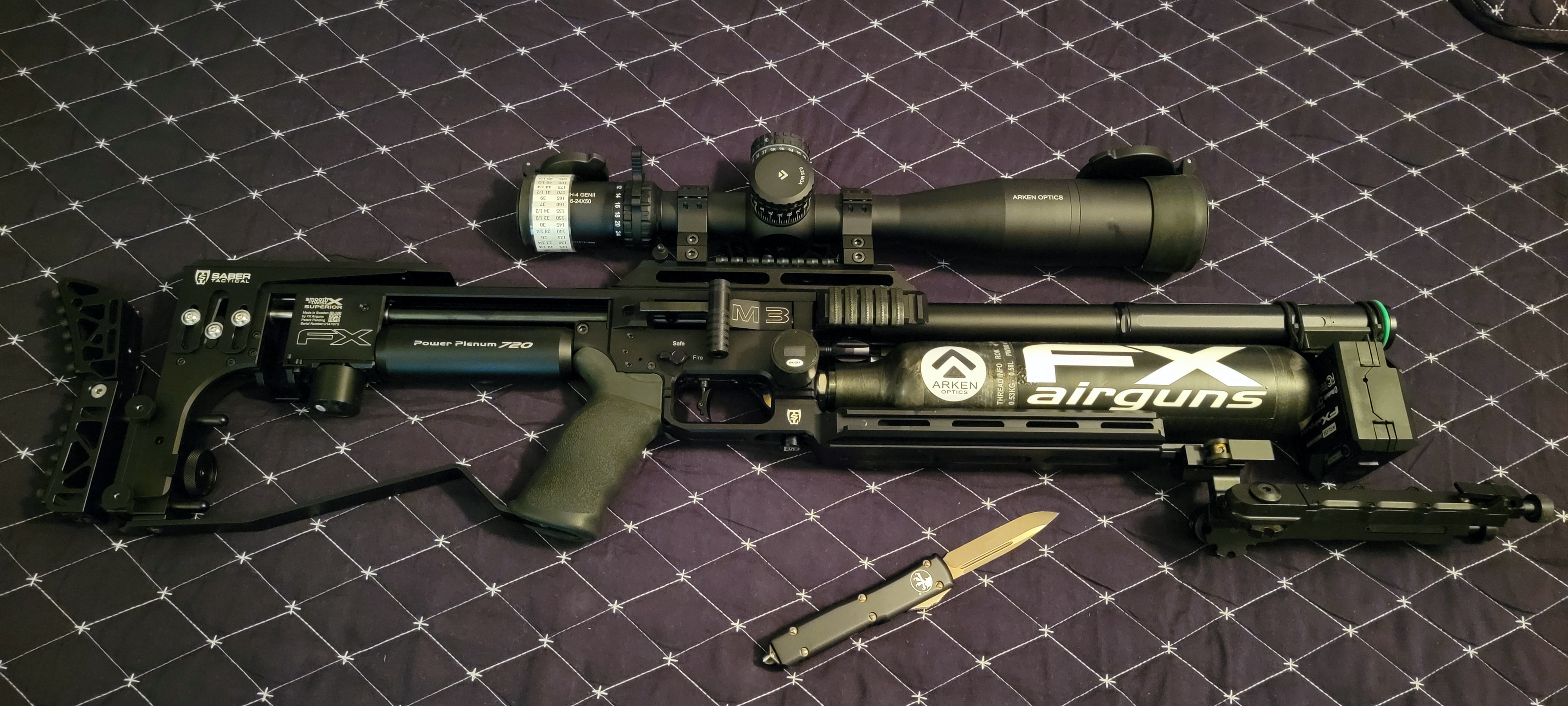

I've been using a compressor only to charge up my guns. I have been leaning towards the .22 instead of the .30. I was thinking .22 because the availability of ammo. You can get .22 almost anywhere. Also, there is no telling how many shots I can get. I get roughly 185-200 shots now using 25 grain pellets or 26 grain fx slugs. 95% of my shots are 50 yards or less.

Very nice looking rig. I have the same rail as you and love it. For your Radar, here's the link to a thread where I'm posting about my 3D printed mods (and a way to hang it off that rail): https://www.airgunnation.com/threads/fx-impact-m3-3d-printed-mods.1281578/
You already have the big money buttstock, so my cheap'o version is not needed.

I'm looking for a Arca Accu-tac so I can utilize the end of the Saber Tactical rail which is picatinny for an adapter so I can move the FX chronograph off the barrel to the rail. The only problem is I can't seem to make my mind up on which to purchase.
