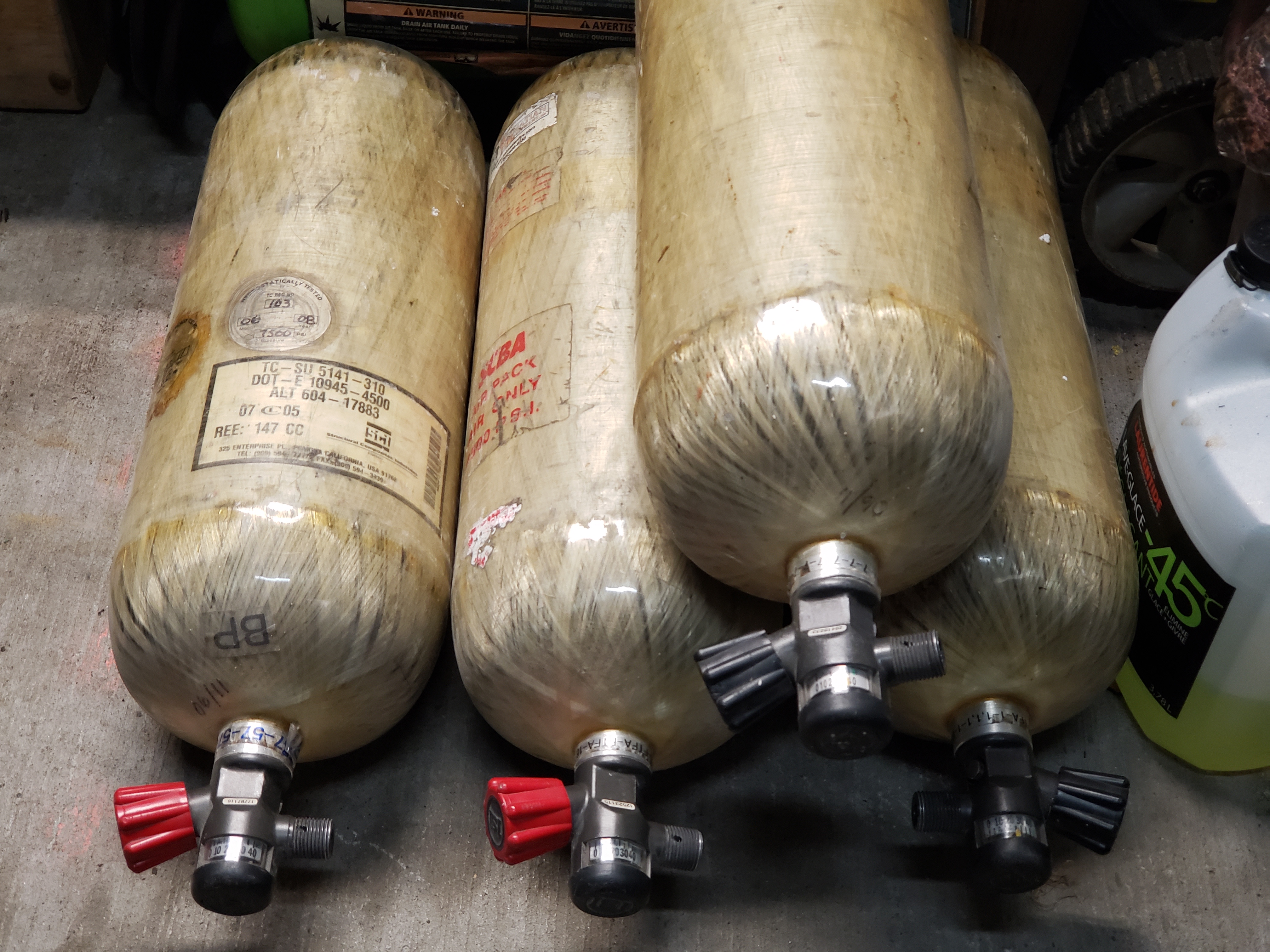

I would buy 2=two largest 30 MPa tanks, and refill in scuba shop or fire-stations that do these public services.
One tank in use and the second is always full, and swap around when refills needed. This gives you time, no need to rush to the shops but do at convenient time.

Great idea, I think, filling a small bottle through a large bottle is always exceptionally fast, easier to carry and use than a compressor, has no noise, saves time, lightweight, and the DOT cylinders are acceptably priced!

The water volume of a 9L cylinder is 550 CU.IN. and the air volume is 2430L/85.8 CU.FT.
As far as I know, a 2L cylinder filling a small 280cc cylinder will fill it 6 times, and it will take about 5-15 seconds to fill it.
A 300cc small cylinder has an air volume of 81L, and a 2L cylinder has an air volume of 544L, so if it's 9L, I'd say it'll take about 30 fills to inflate it.

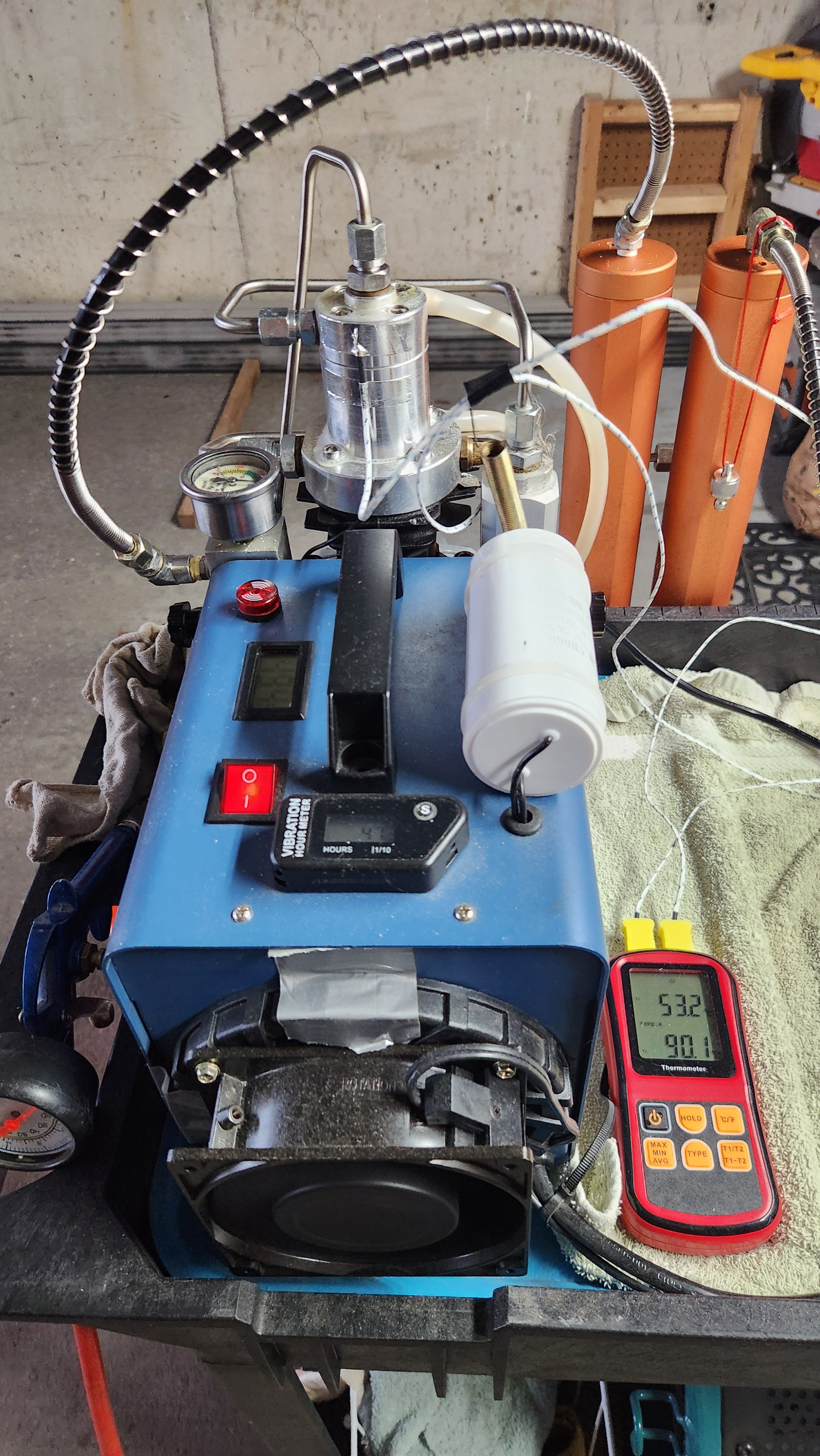

Come on a little exaggeration, engineering degree, experienced mechanic ? These are simple machines. From the now $150 little orange ones of various names to the expensive non commercial models the availability of parts may determine the fixability. My two mid priced ( to me at least, some would say still Chinese junk) compressors a
Gx cs4i and a Tuxing txed042 both have all the necessary parts for sale. Having given them a good what if ? look over I don’t anticipate any need to ever buy another. I have one of the little orange ones and yes they are only for filling a gun not a larger tank which my two mentioned do with ease. Just keep them running as cool as reasonably possible while not inconveniencing yourself cause your scared it may go three degrees too high. Besides I don’t think my 2 will break !

This is great advice for those who fear learning to turn a wrench. If I were starting again I wouldn't even suggest this though, if, I was going to have to go get a large tank filled more than 3 times a year.
I wish that I had just bought my own 6k Nitrogen cylinder and contracted for a once a year fill up. No moving parts, bone dry, huge capacity, zero problems. I would use it to fill one 9L and my portable 2.17L. Done.
