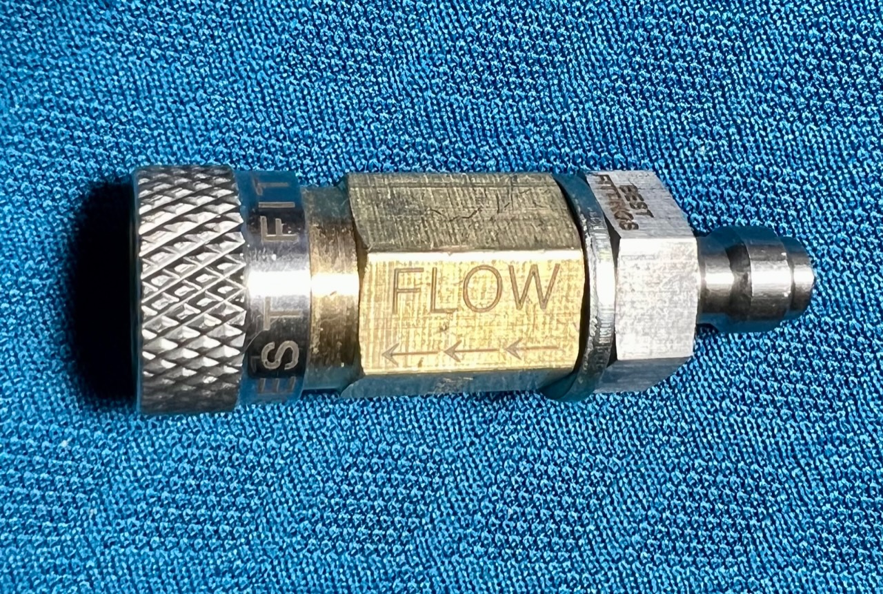

The GX CS4 would do everything you want it to do, but the others can fill a larger tanks using an incremental fill like you described. I would recommend getting a one way valve to put in line, this will prevent back pressure from the tank feeding back to the compressor creating a load the compressor would need to overcome. Something like this from Best Fittings is what I use.
With this you don't necessarily need a compressor like the GX CS4 and could manage very well with one of the compressors you are looking at. Having said that, you may want to compare the specs to one of the other compressors GX Pumps offers. As previously mentioned, many of these compressors are mechanically very similar, and you could end up paying a premium just for a name. The GX Pumps CS series have proven to be very durable and reliable.
I really like the idea of the one-way valve, no need to equalize the pressure in the compressor to match the tank before opening the valve, correct? Anybody sell that valve in the US?

I see that the Valve is about $40 American. Could be worth it!
It’s absolutely worth it. I get my tank that I’m going to fill, put the valve, open the tank valve and just connect the compressor and start running it. Once the compressor pressure goes above the tank pressure the valve opens. Simple. To remove bleed both sides
