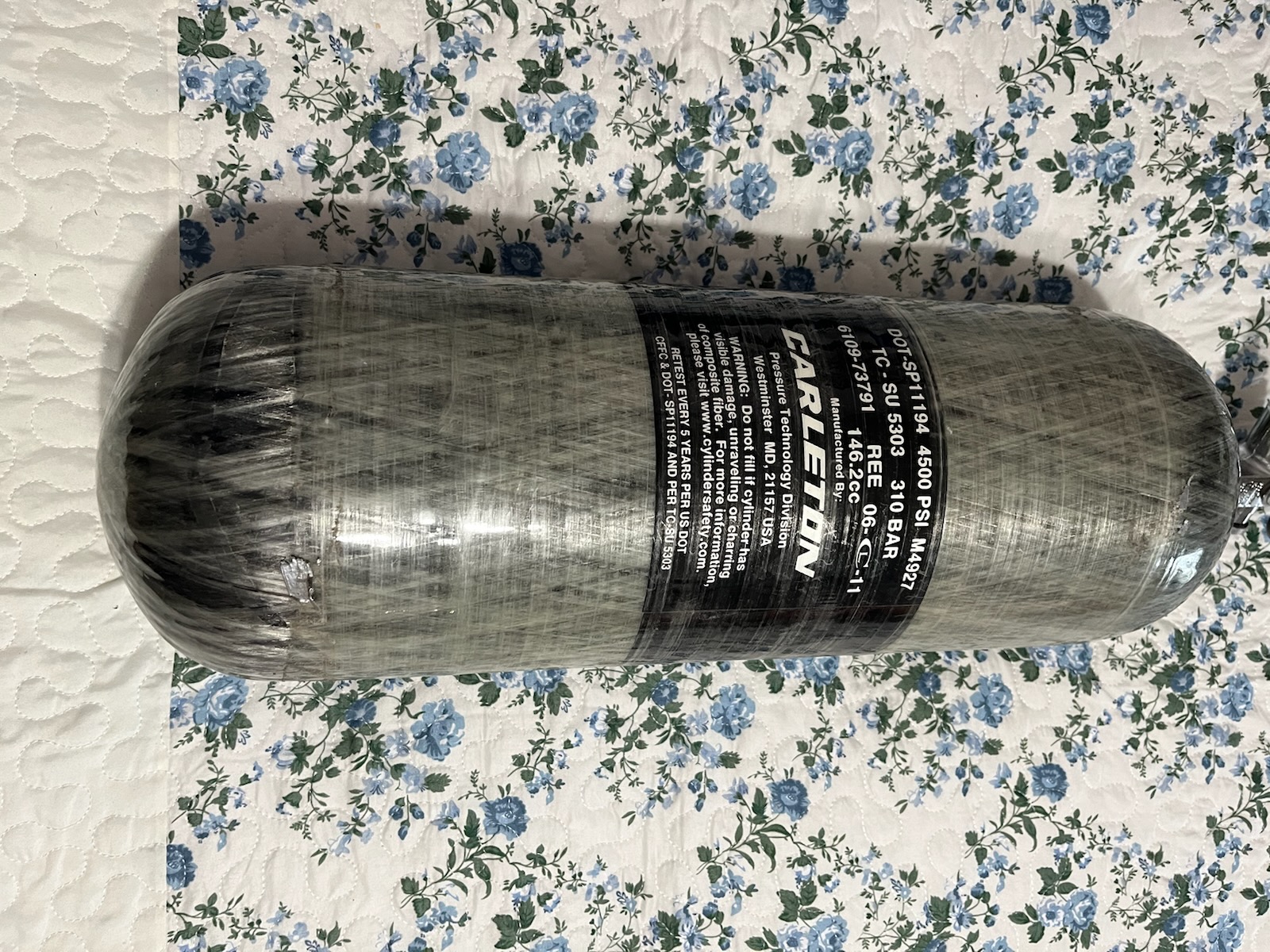

I think I have decided on purchasing the CS4, seeing that I believe I will be able to fill my carbon fiber tank. I can't seem to find just how big my carbon tank is. Its external dimensions are approx. 22" by 7" diameter. I believe it is an 88 cu.ft. tank. It is an Airhog tank, but they may be out of business seeing the number I called put me through to Medicare.
Can someone help me out?
Thanks!
Also, I noticed that on the outside of the tank is marked 146.2cc

A picture of the bottle, particularly the label, would help to figure what you have.
