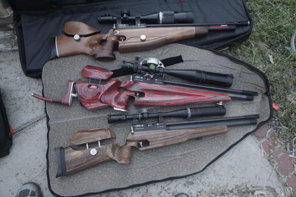

CONSIDER THE CRX , CR97 OR CRX-ST
1566256694_4430905995d5b2e36763049.09757491_July 2019 Shooting Gary Cane.jpg
CR= COMPETITION RIFLE
This CRX shoots 20 shots at 50 yds under a nickel, unsorted JSB 10.3 from Field Target position.
