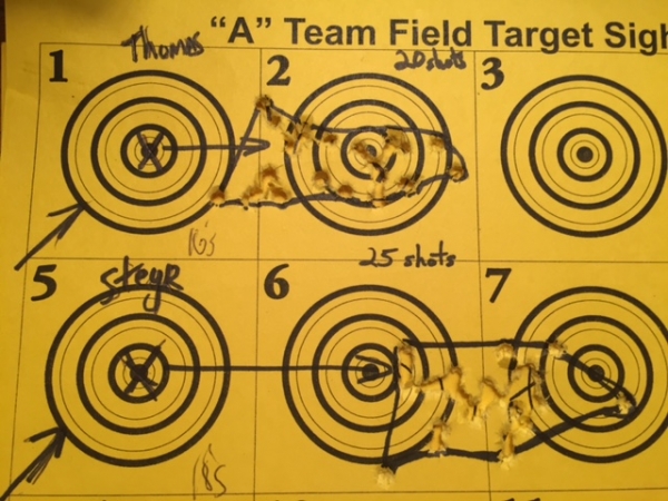

I'll post a pic of a very well controlled test done by Greg Sauve that compared the Steyr he has been shooting for the last 10 years or more, and his Thomas that he began shooting last year. Both guns were sighted in indoors at around 65 degrees. He then moved outdoors where the temp was around 30. He shot at 50y. After the rifles cooled to ambient temp, he took one shot with the Thomas, aiming at its own bull, then picked up the Steyr and took one shot at its own bull. He repeated this process until he had shot 20 shots each. This method assured that one rifle did not get better wind than the other for the test. That is something I love about Greg...he understands how to compare things properly. The test was also done to compare wind drift between the two. This is just one pic, with many others showing the same results. The wind was quartering, so the vertical was more than if it had been a full value cross. Greg chose to shoot a Thomas, because the temp shift he had to monitor closely with the Steyr is a non issue on the Thomas....plus much less wind drift than he was accustomed to. This freed up some space in his head to focus on other things. Greg shot Great with the Steyr...still shoots great with the Thomas, but has much less to think about. Greg also uses the only scope I know of that ranges short when its hot... the March 8-80. The opposite temp shift could not keep up with his Steyr, but he reports it very closely matches his Thomas....meaning that as the scope ranges shorter, the gun shoots a little bit faster and matches the difference so he needs to make no temp correction at all for optimum vertical placement.
Sorry, I forgot the picture.
Mike
