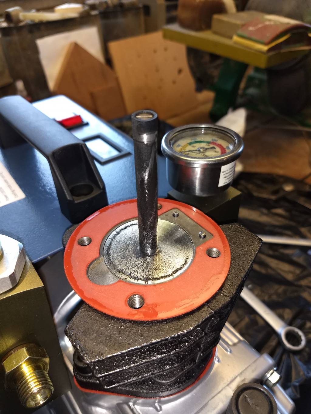

Some might not realize the extreme heat of compression generated in the YH. This heat cokes and carbons up the hottest parts of a YH, and most all HPA compressors. A build up of this coked up carbon under the reed valve will cause slow pressure build up and finally not able to build the correct pressure with valve being help partially open by coking deposits.... Unless the oil being used is specifically designed to avoid this type coking, it will happen eventually from oil blowby getting coked in the upper cylinder valve area. Over filling oil will make this happen much faster.
If anyone has taken apart a turbo compressor they can see the same coking build up that extreme heat causes.

I have writtenthis in MANT post on Many forums and most seems to go by unnoticed. Even by you. I feel like I'm beating my head against a wall.
I have posted the pic of what Royal Purple or any other improper oil does to the valve and piston many times. Here it is yet again. The carbon
n build up can be easily seen where it both caked on the piston and under the reed valve. this allows back pressure back into the cylinder making pumping very difficult from the back pressure, and the carbon acts like a sandpaper in the cylinder.
