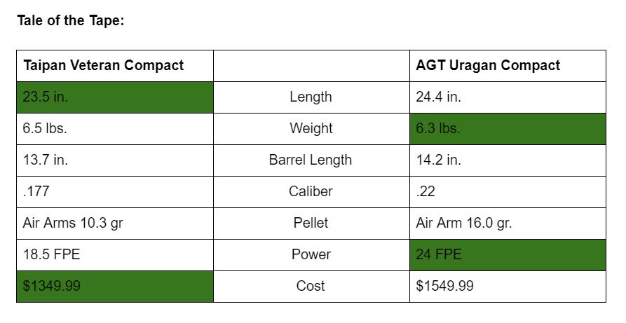

Today I’m going to match up the AGT Uragan Compact against the Taipan Veteran Compact for the Lightweight crown. (Let’s get ready to rumble!)

Final Results:
The Taipan Veteran entered the final round with a commanding 67 - 64 lead but was knocked out by the Uragan’s superior knockdown pesting power.
