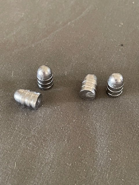

Hey here is what i have been casting. They seat very nicely with the drive bands:
I cast at lower temp to keep the size up. If you cast at higher temperature they might be loose in the GK one magazine.
