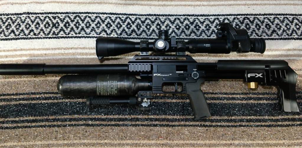

I recently bought the Pard NV007 and for the same reasons you are inquiring about. I have it on an Athlon Helos and Impact as well. It is surprisingly clear and should work well for seeing and filming the coyotes at night around here. I went with the removable night vision because I did not want a scope mounted to the Impact that was dedicated to night vision or needed batteries to operate during the daytime. For the money spent, it has all the benefits I need and is a good product with less "issues" that some of the other models and types have.
Edit to add...
The one thing that you may not like about the 007 is that it adds to the length of pull. But if sitting in a blind or at a bench, because of the nature of "aiming with a camera screen" it becomes a non-issue really.

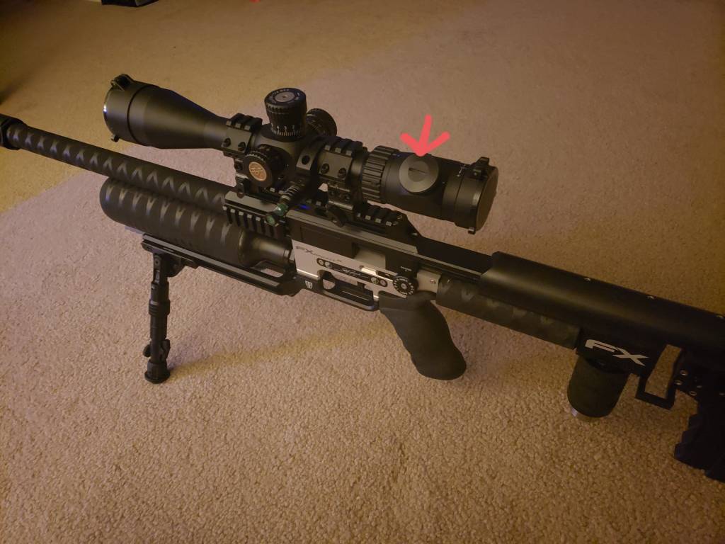

The thing i am concerned about with the 007 is I am not sure if I have enough space since the illumination dial is so close to the end of the scope what do you all think?
The clamp ring should be fine on there. That is about as far as mine goes up without the illumination knob. If you do want it to mount on further up, you could also cut/file a small radiused notch into the pard's mounting ring in that spot. Doing this would make the camera sit in a permanent position with regards to the reticle also, so re-mounting the ring will go back the same every time. (I leave the ring in place all the time, as it protects the lense anyhow.)

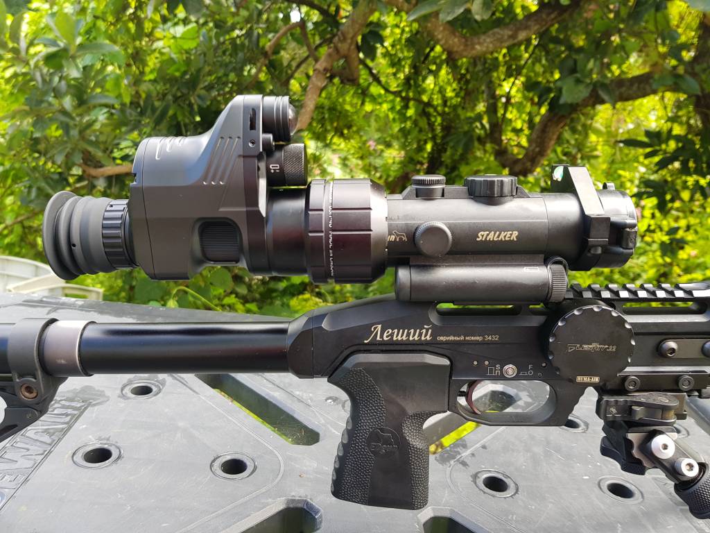

I was gonna suggest the pard 007 too but I honestly don't like clip ons. I don't like adding extra weight to my setup but since you said you don't mind I guess it's a non issue. I had an armssight co-mr and ended up selling it for that reason (however it clips to the front of a day scope).
I just got a nv008 and plan to swap between day scopes and the pard when I need to but I always buy qd return to zero rings so I prefer just having a stand alone NV.
I don't like the fact that the pard nv007 is a clip on but at least it fits your budget. The cheapest nv008 I was able to find is for 580 but you may be able to find one slightly cheaper (I'm using the lrf plus). It's pretty decent for the price. I sold an atn 4k 5-20 on a different forum (I did have it listed here too but nobody wanted it) and while it did have a lot of cool features, I didn't like the size so I bought the pard. The pard nv008 I think would be a better choice tbh but you're gonna need some return to zero rings if you want to swap scopes and the pard. I mean for me rezeroing day scopes isnt that bug of a deal but I do use return to zero rings to save myself the hassle.
