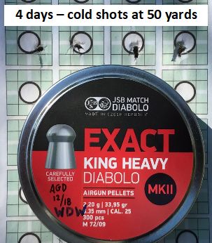

A pest control rifle always, always, always has to pass the cold shot test. Even a budget rig like the DAR .25 cal.
After proving it can reliably put a JSB heavy onto an aspirin-sized bull at 50 yards after sitting up, the next two pellets...

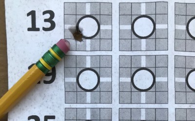

Most definitely. It routinely sits idle for a week or two until a raccoon shows up in the yard. Other times, if I haven't had reason to shoot it for a while, I'll put one on paper just to make sure it's still on point.
You got me thinking, turns out it's been almost 2 weeks since I last shot it (a raccoon on Dec 19, so 12 days ago). So I stepped outside a few minutes ago and put one on the 50yd target and managed to nick the aspirin-sized bull.
And really that's about the limits of my shooting ability on any given day, what with slight wind currents and heartbeat and all that.
Funny enough, looking back at that previous pic of the 4 cold shots, it looks like maybe it could stand a click or two of elevation.
