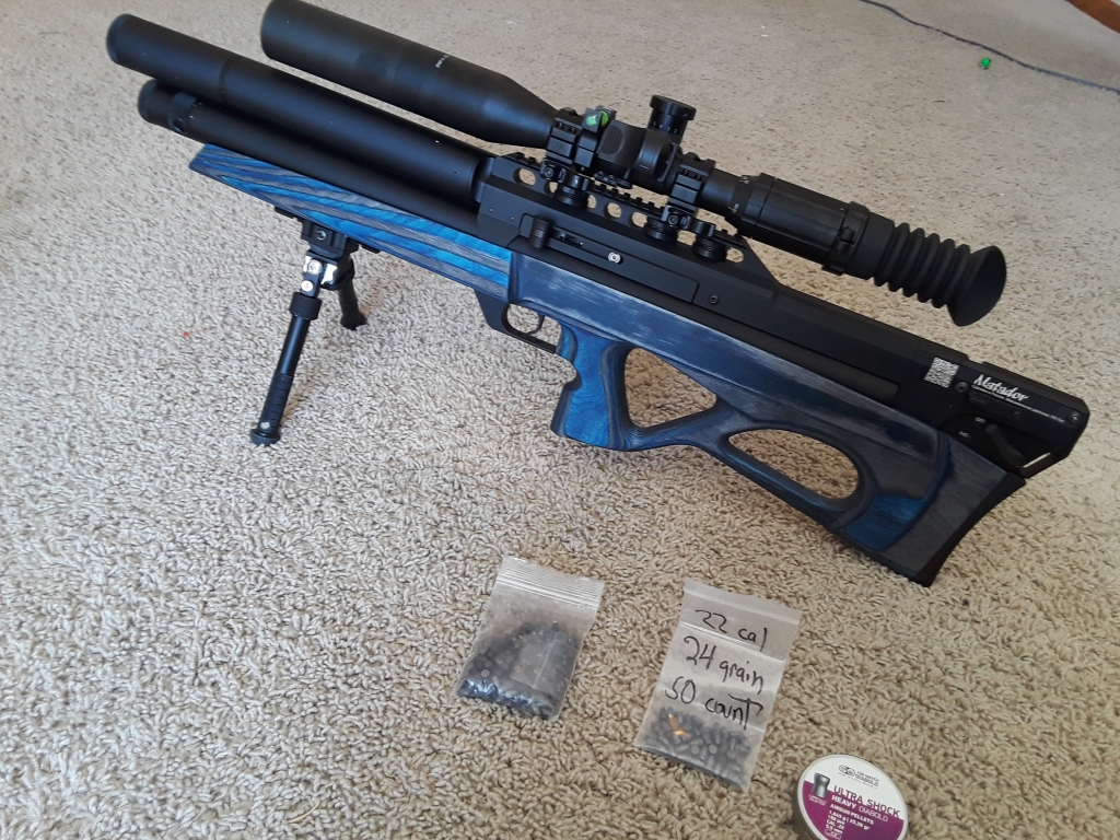

Has anyone got a .30 FX MKII 700mm to shoot slugs really well? I have tried the STX and slug A liner with NSA, FX and cast slugs with different diameters. I have the slug kit and PP installed. I always revert back to the JSB 44.75gr for hunting. They are so accurate compared to slugs. Headshots on squirrels at 85 yards is easy with the JSBs. Slugs not so much.
