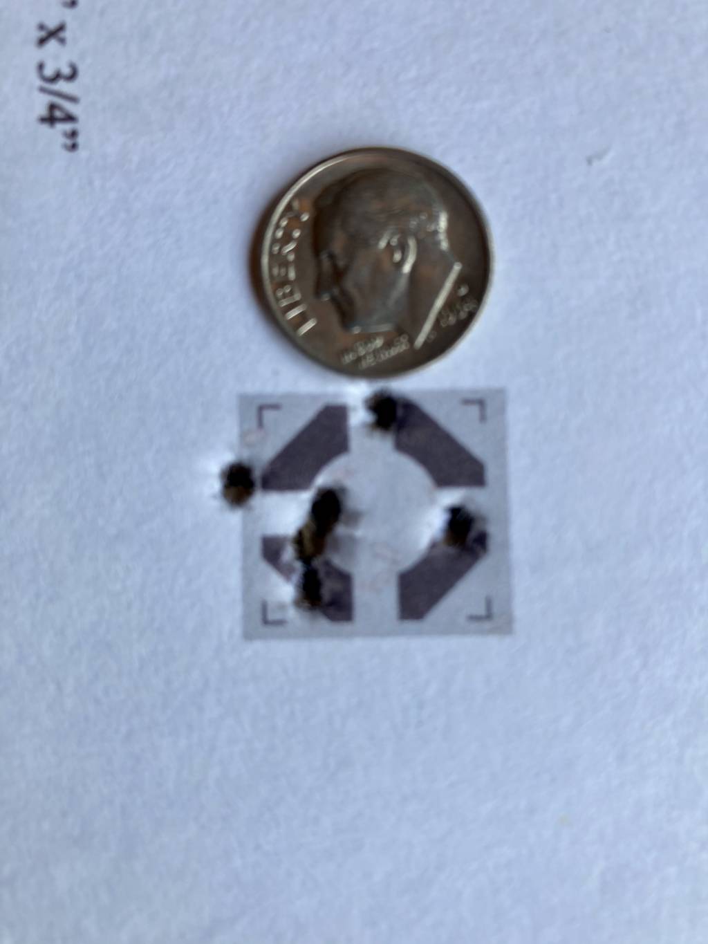

So I’ve been practicing a few times a week bucket and sticks. But still need a lot of work kneeling and especially off hand. Yesterday I decided to check accuracy at 50 yards and the 6 shot group below is typical with a light left to right breeze.

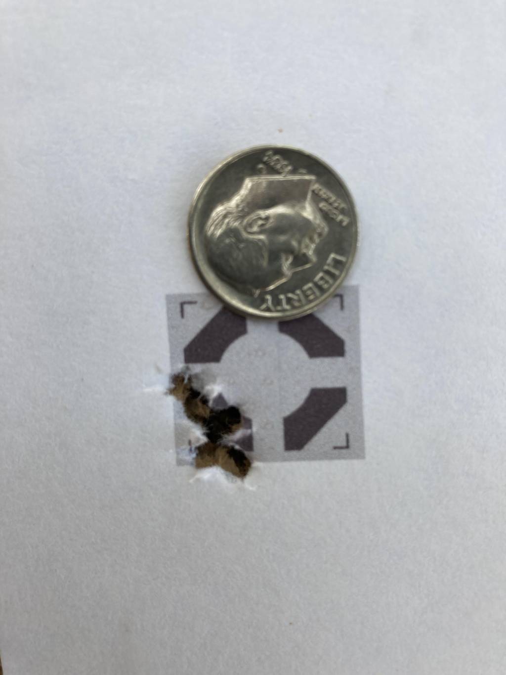

Before I started practice at different ranges I noticed a tin of 13.43 grain JSB RD Monsters n my bag and thought I’d give it a try at about 820 FPS.. This is the typical 6 shot group. It also had much less drift in the wind.
So it looks like this will be the pellet of choice at 20 FPE. Now I really need to practice ranging and off hand shooting!

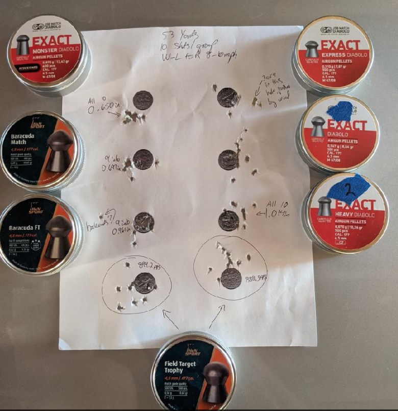

I shared this in the review but it's applicable so here it is again:
Ten shot groups at 53 yards in an 8-10mph wind. Tightest group, easily, is the upper left, and happens to be the 13.43s.
The rest of the ft discussion is that at 16x for a scope power limit for Hunter class, ranging is much harder to do than the classes that allow the big 10-50x scopes.
I'm still not sure which is better (faster/flatter or slower/more rainbow), but people are successful with both ideologies.
