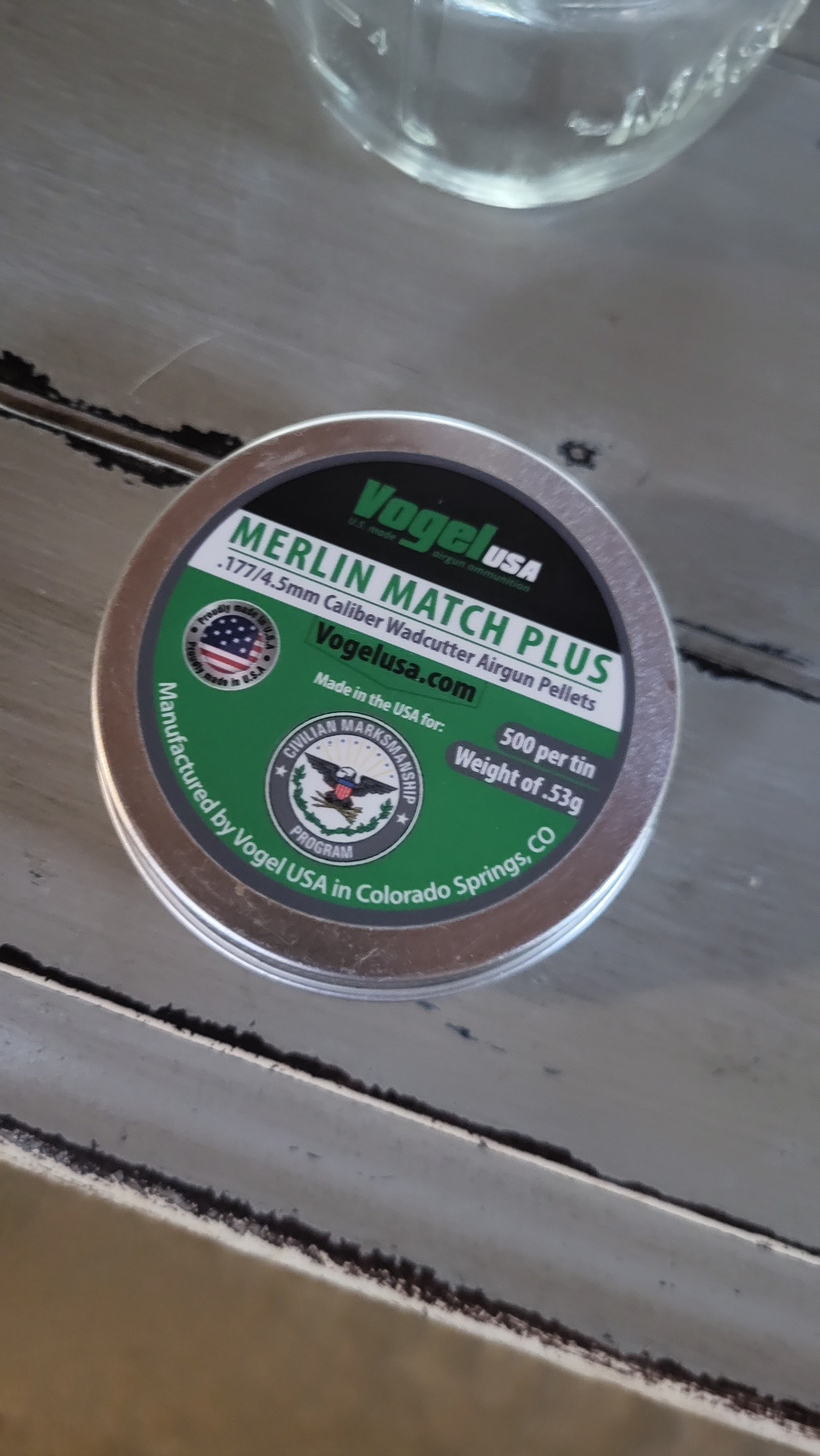

The Vogels are incredibly soft. I doubt they even have antimony or tin. Unfortunately they fluctuate in size too much for reliable accuracy. Plus their skirts are on the thicker side.
JSBs are your best bet. Soft lead alloy and thin skirts. It still takes a fair amount of pressure to balloon even a soft thin skirt. You might be better off with a larger headsize if you're looking for more rifling engagement.

Is vogel a UK variant?

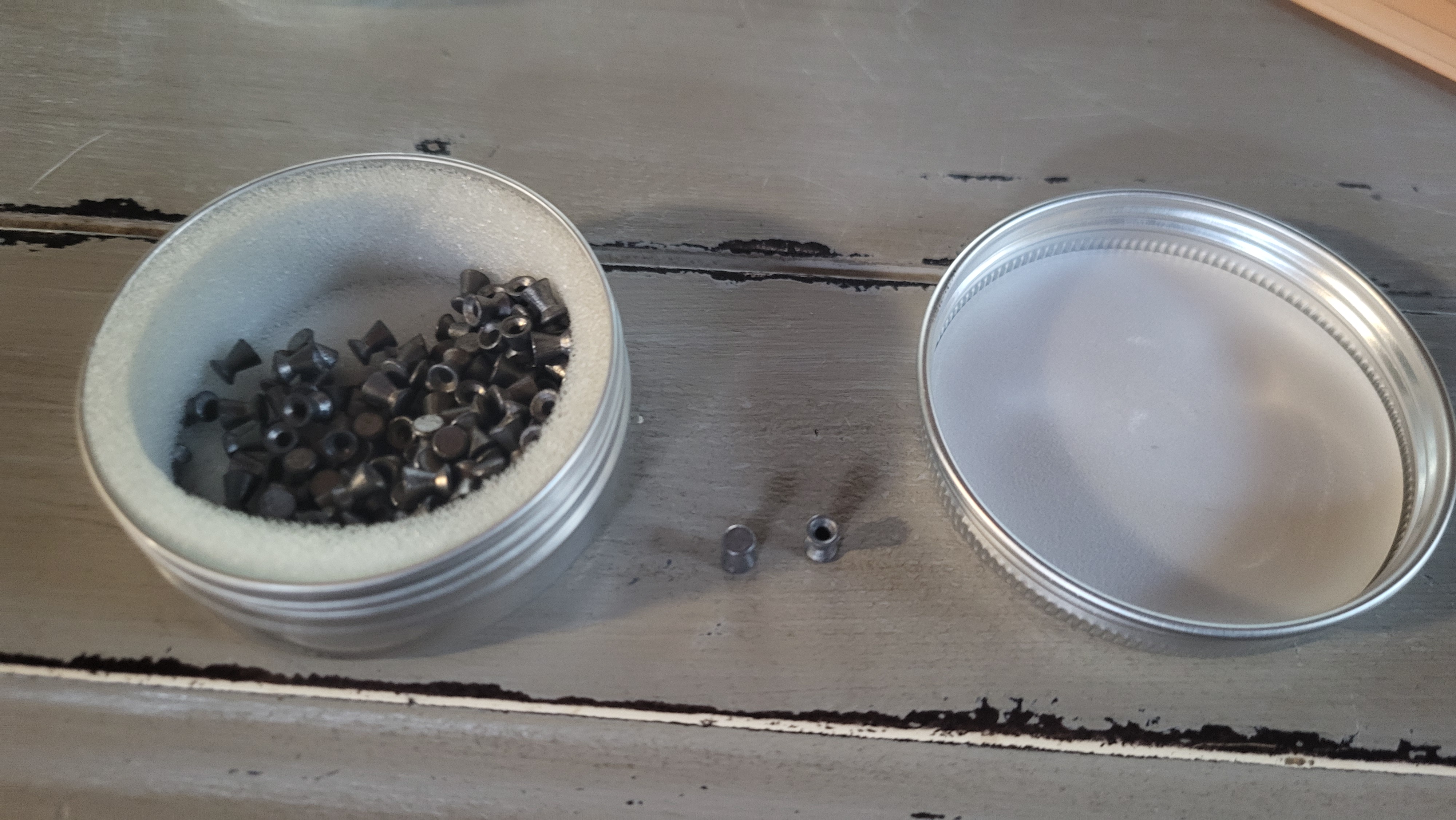

No they're made in USA. I believe you can get them direct. Vogel makes two grades the bulk practice and these green label Match Plus. I think calling these match grade is a stretch. I wouldn't gamble on the bulk version.
The Civilian Marksman Program uses these for youth training and matches. CMP sometimes sells them at good prices. During Covid when pellets got scarce I bought ten tins cheap. They're ok for low power, short range paper punching and plinking. This is my last tin.
