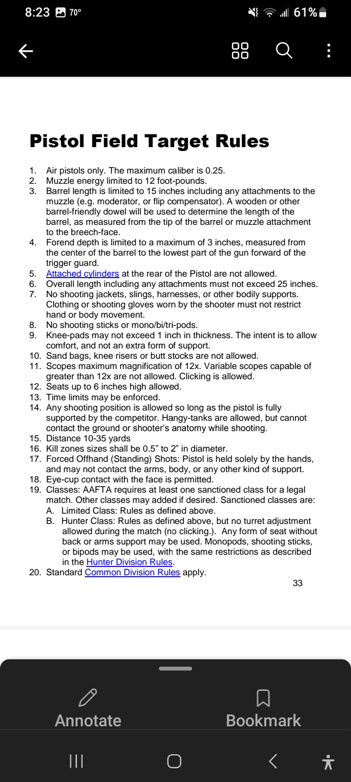

I see a lot of guys doing extremely well with 1720T's, but you'd have to find a used one since they are discontinued.
I always shot my Falcon FN8 for PFT. Did reasonably well with it. Generally shot between 70-80% before PFT really fell off the map at a lot of major GPs (i.e. PAC).
.177 is definitely advisable due to the trajectory advantage it has over .22 and .25 at 12 FPE.
Whenever the "which gun" question comes up, I think the general response should be: "find something accurate and reliable that scratches your ergonomic and aesthetic itch and practice with that gun." Lots of people do really well with a variety of different platforms.

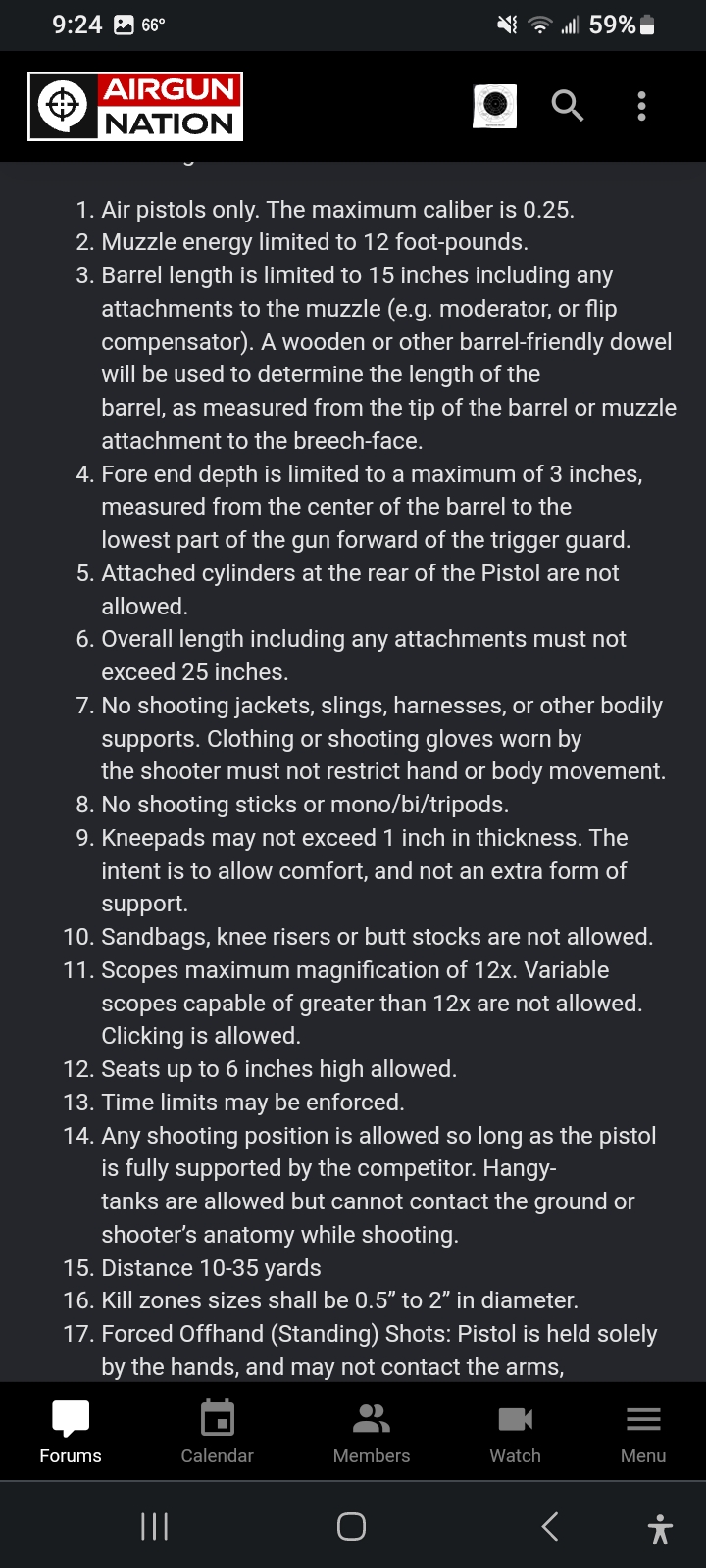

I agree the 1720 is extremely accurate and a great choice for pistol FT. I sold mine to a buddy and he loves it too. The only reason I sold mine is that I have an HW44 which is just a little bit more accurate but marginally better. The only down side of the HW44 is that you have to cut down the moderator to meet the over all length since it violates the rules. You also have to de-tune it a little as mine was shooting 13.5 ft lbs originally. After I shortened the moderator it increased to about 15 ft lbs.. I had it tuned by a technician to get the power back down under 12 ft lbs. That is what you would need to do to the HW44 to be able to use for pistol FT. I will add that my HW44 is about 3 years old, I do not know if current production design has changed the OAL or the power output to be more in line with the rules. Best wishes on what you decide. You can't go wrong with the 1720 if you can find one.

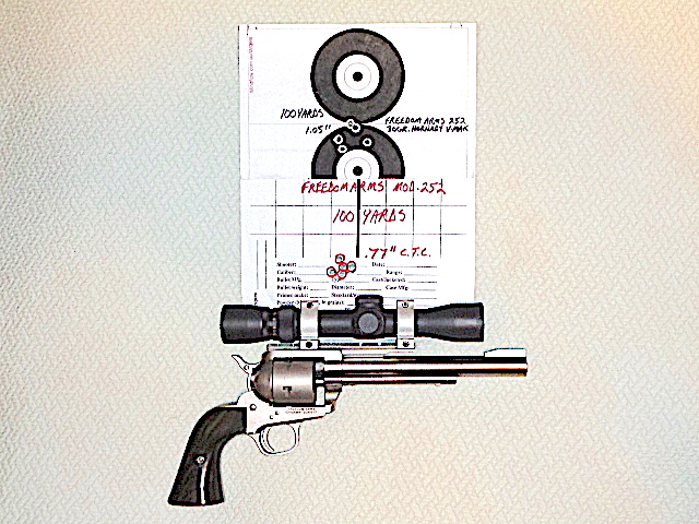

I'm with you on FA revolvers; but I went with .22 LR/WMR, so I could shoot it to my heart's content with nary a financial or loading-time cringe.
The Brocock or HW 44 should be good to go with nothing more than (maybe) adjusting the power where you want it.
Very nice! I am still wanting their 22lr. All mine are the field grade. Silhouette in 357, and the rest 41.44.454,500 WE in standard barrel lengths. The 44 is scoped others have express sights. Well the 357 has FAs click rear sight. They are a gun that will be passed down to my kids and their kids.
