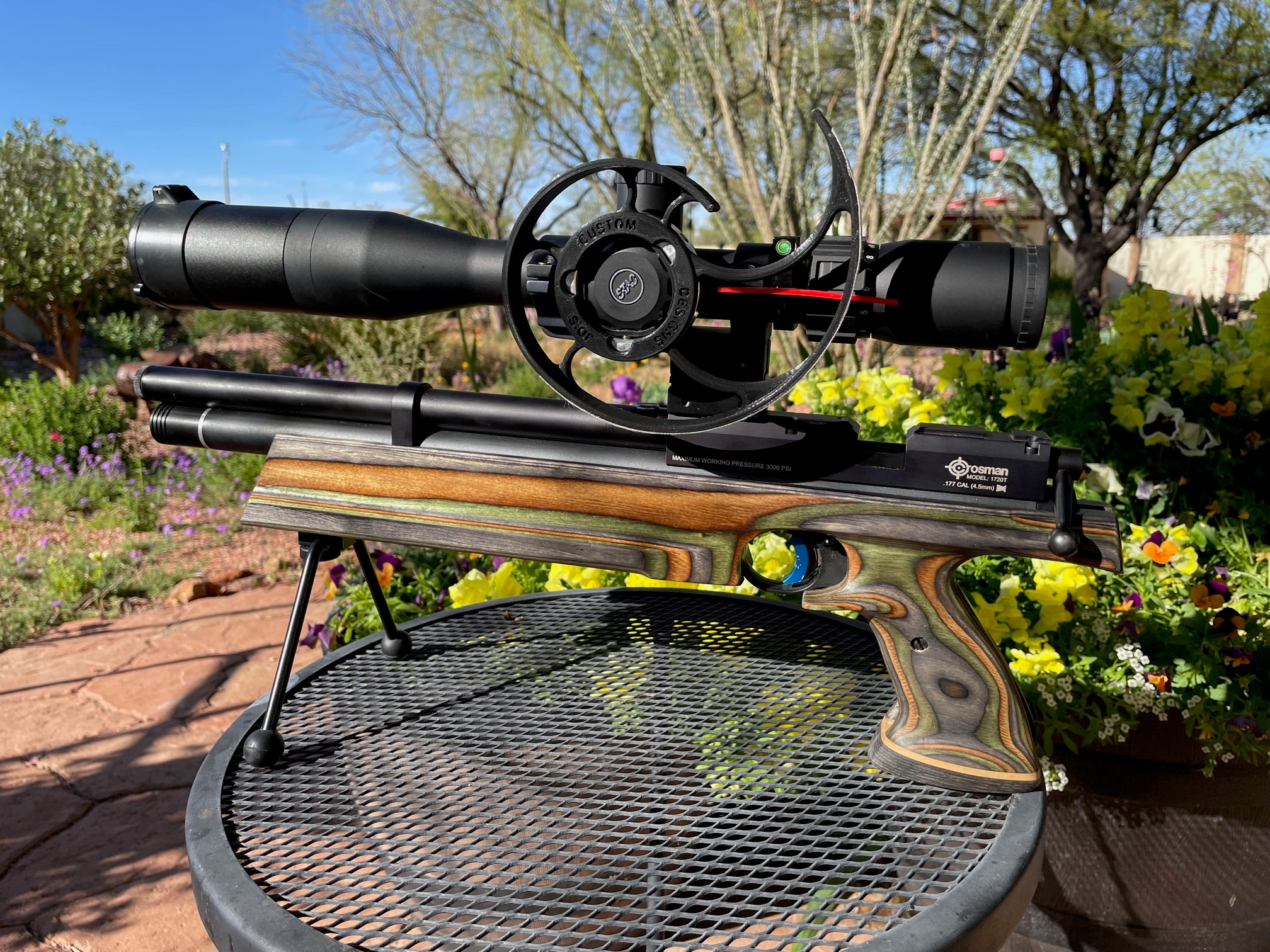

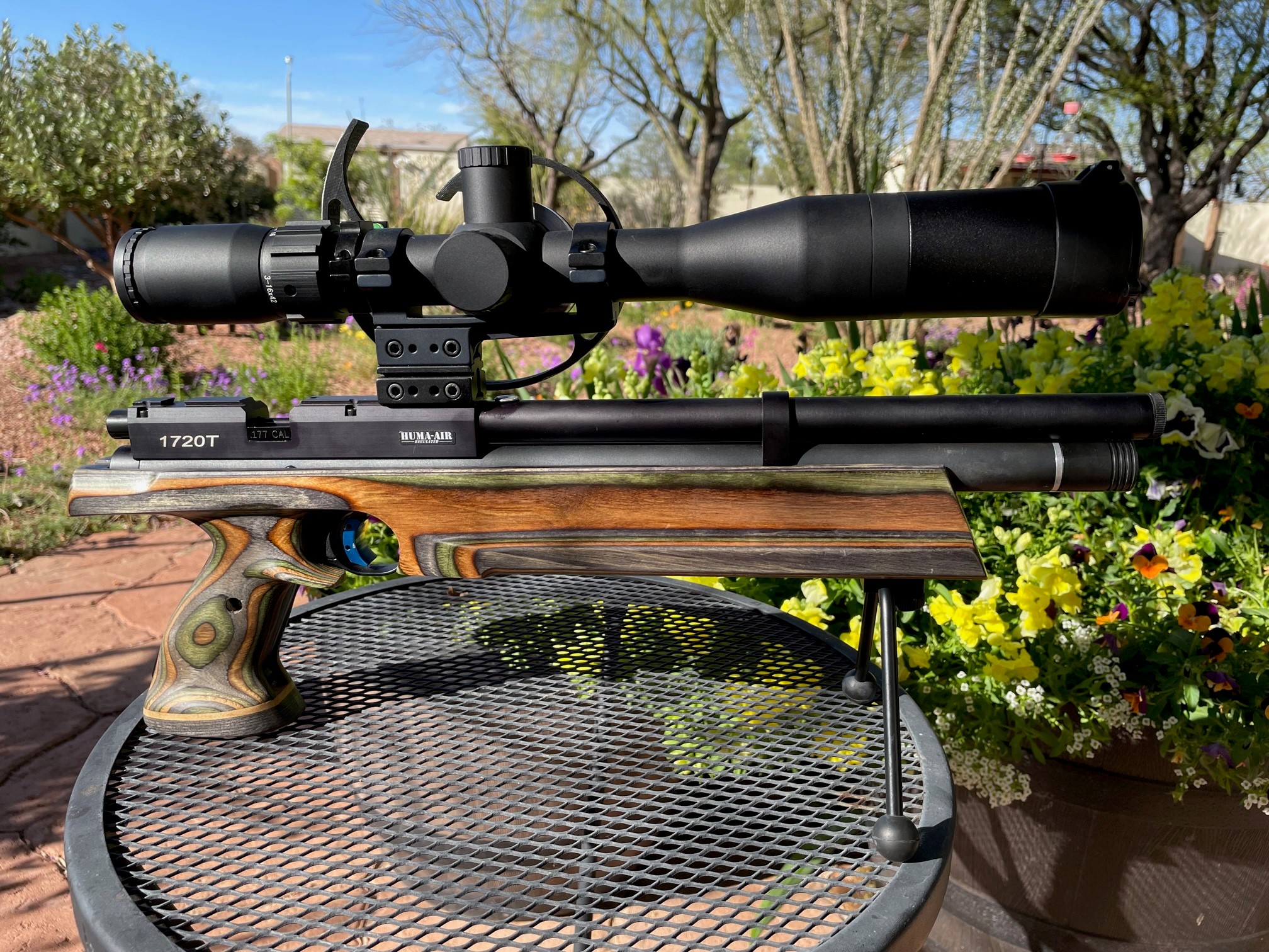

I'm throwing my hat in with everyone else that's on the 1720T bandwagon.......

The 1720T as mentioned by Ron is an excellent choice. It is the same as a 1701P, but with a longer barrel and a larger air chamber. It is very accurate, it is 177 and can be shot at 12fpe as per the PFT rules.
