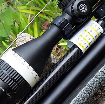

Not that i'm lefty ... For years have shot pistol FT and tried many scopes for the task. Few years ago spend some time with scope I've had for near 10 years finding that 35y and under parrilax ranged good or better than a lot of SF parrilax optics. Thus it was used for my PFT work exclusively.
You can see that the rotation to yard separation is very good at closer ranges, yet still remains good to 35y making it an ideal optic for PFT and being a lefty with OBJECTIVE FOCUSED for Parrilax and NOT a left side wheel/knob
Scope is a HAWKE PANORAMA 4-12x50AO 10x 1/2 mil-dot.

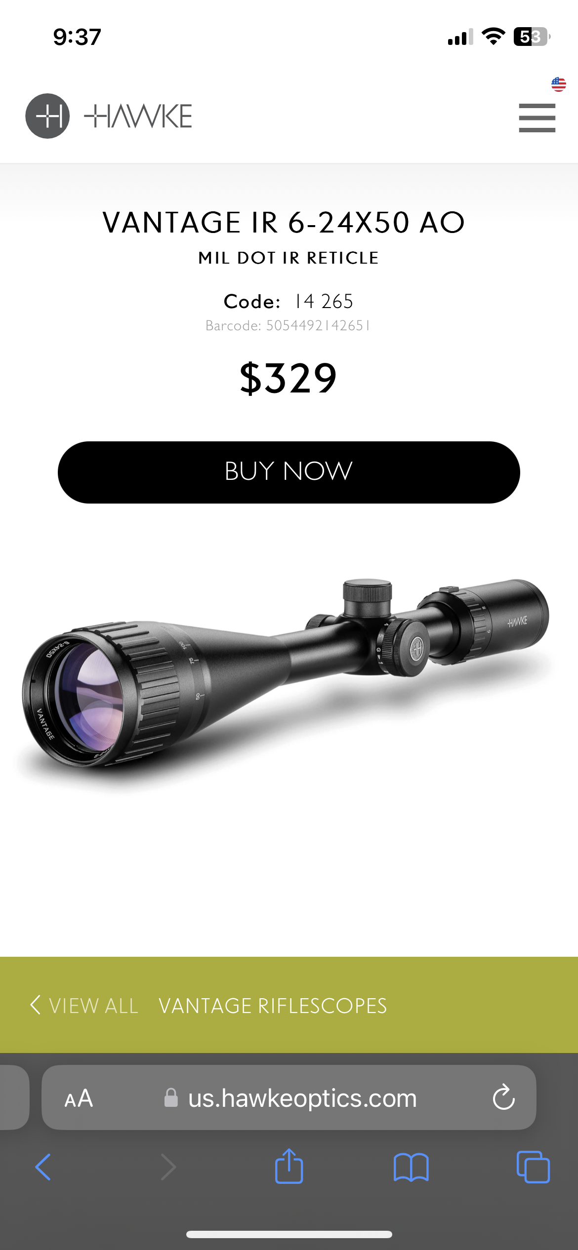

Like this one better
Just NO illumination IF needing it ?
If shooting venues are open being generally bright and not deep woods & under low lighting a non issue.
